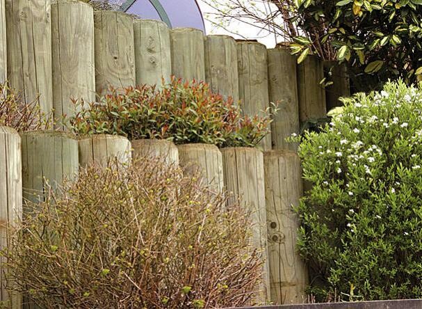

Bauexperte16 May 2012 16:54Hello,
Many people prefer carports; they would never, under any circumstances, put their car in a garage.
To maintain good ventilation, I have attached two photo examples made of wood and one made of stone. The advantage: easy and quick to handle, and they work perfectly as a trellis for climbing plants or shrubs of all kinds. If you want something a bit unusual, in my opinion, a calabash arch on the short side would be a good alternative.
Kind regards
Cascada schrieb:
What suggestions do you have?
Kind regards
Hello Building Expert,
thank you very much for your post.
It’s true that a ventilated vehicle plays a role, but that wasn’t the deciding factor here.
At least a garage was needed to keep the bicycles or the moped locked up in the evening.
Since the whole design has a somewhat more modern character, I prefer to use wood or similar materials, which I can also coordinate with the colors and which have a straightforward design.
After the first winter, I’m already tired of scraping the windows in the morning and clearing snow off the car, while the homeowner opens the gate and drives away.
Best regards...
