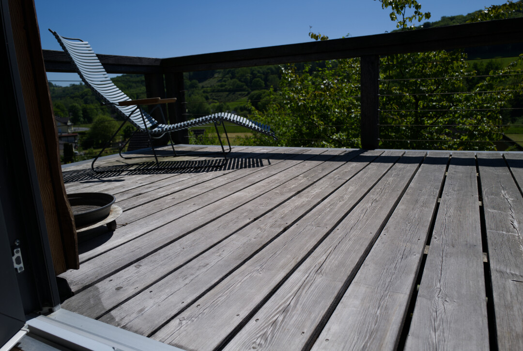

This is how our untreated larch looks after almost 6 years.
