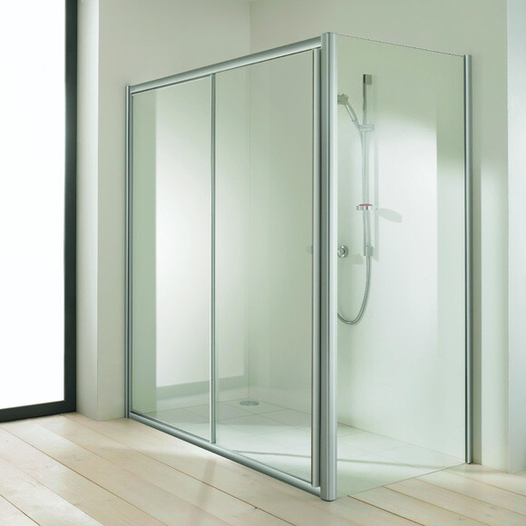

I had an appointment today with the bathroom planner I trust. I’m still a bit shocked by the prices, hopefully that will settle down.
I had initially planned for a 120 cm by 90 cm (47 inches by 35 inches) walk-in corner shower with a two-part sliding door, something like the attachment.
Now the specialist explained to me that a 120 cm (47 inches) width with a sliding door is not recommended. Because of the fittings, hinges, etc., the effective entry width would be a maximum of 50 cm (20 inches), which would be too narrow.
Is she right? She recommended a shower with a swing door instead, but since sliding doors are available at 120 cm (47 inches), I wonder if I should insist on that. Or should I go for 140 cm (55 inches) instead?

Bauexperte25 Jan 2012 09:51Hello Peter,
Yes, you can spend a fortune on all those “accessories” 😉
It depends on which sliding door you choose; attached is an example where 1.20 m (47 inches) is more than enough.
What exactly do you mean?

Due to the fittings/hinges/etc., the entry width would be a maximum of 50 cm (20 inches). That would be too narrow.Hello!
It’s all a matter of body measurements 😀. Tiling on three sides is more for those who prefer darker showers 🙂.
Our setup is similar, but with one fixed glass panel. It’s inexpensive, easy to maintain, and splashes are kept to a minimum. Entry width is 40 cm (16 inches) in the guest WC, 50 cm (20 inches) in the bathroom.

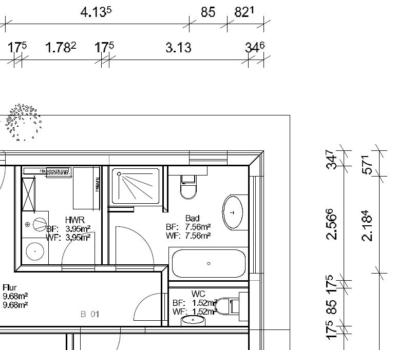

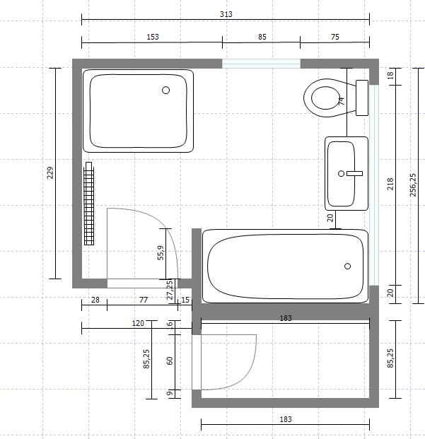

I will reconsider the shower over the weekend. On the other hand, I have another issue. I would like to position the toilet and washbasin under the gable window. It sounds odd, but I’m missing a few centimeters. So the house would need to be a bit wider. Or is there enough space around the washbasin? I have already reduced the washbasin from a bulky 100cm (40 inches) to 80cm (31.5 inches), but if I want to arrange it this way, the washbasin probably needs to be even narrower?
Attached is also the architect’s preliminary draft. I don’t like the toilet in front of the half window. But at least we were able to "agree" on the location and size of the guest toilet...
