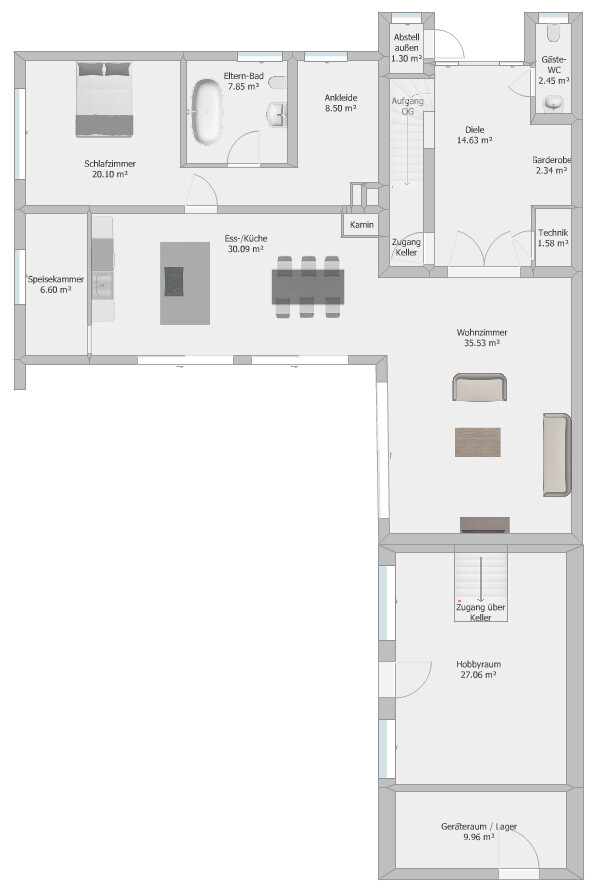

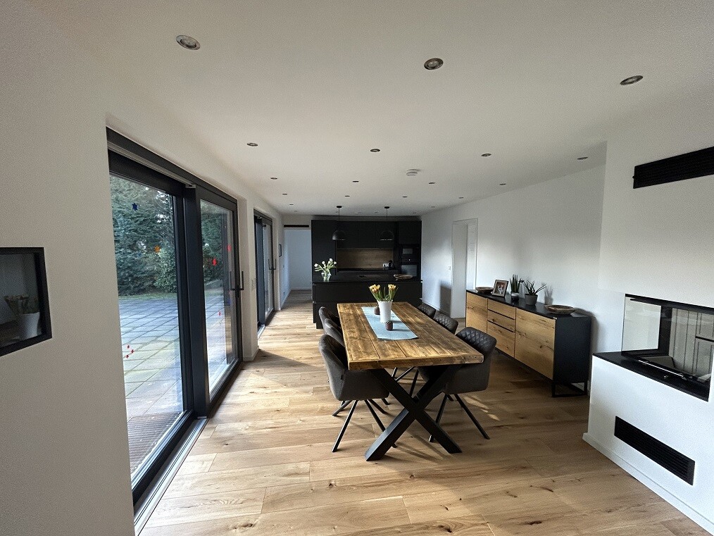

So, we completed the full renovation, finishing the upper floor in the first half of 2022 by moving everything upstairs, and then working on the ground floor in the second half. It was a massive project and a tough test for the family—one full year of living on a construction site. We've definitely had our fill of building for now 😉 The basement and landscaping are still pending, but you need to have goals in life :-)
The new layout on the ground floor almost matches our original plan that I shared here about 1.5 years ago. I’m attaching the final ground floor plan. I wanted to take some photos later, but there are still many furnishings and small details missing.
Floor plan of a house with living room, dining area, kitchen, bedroom, and bathroom.

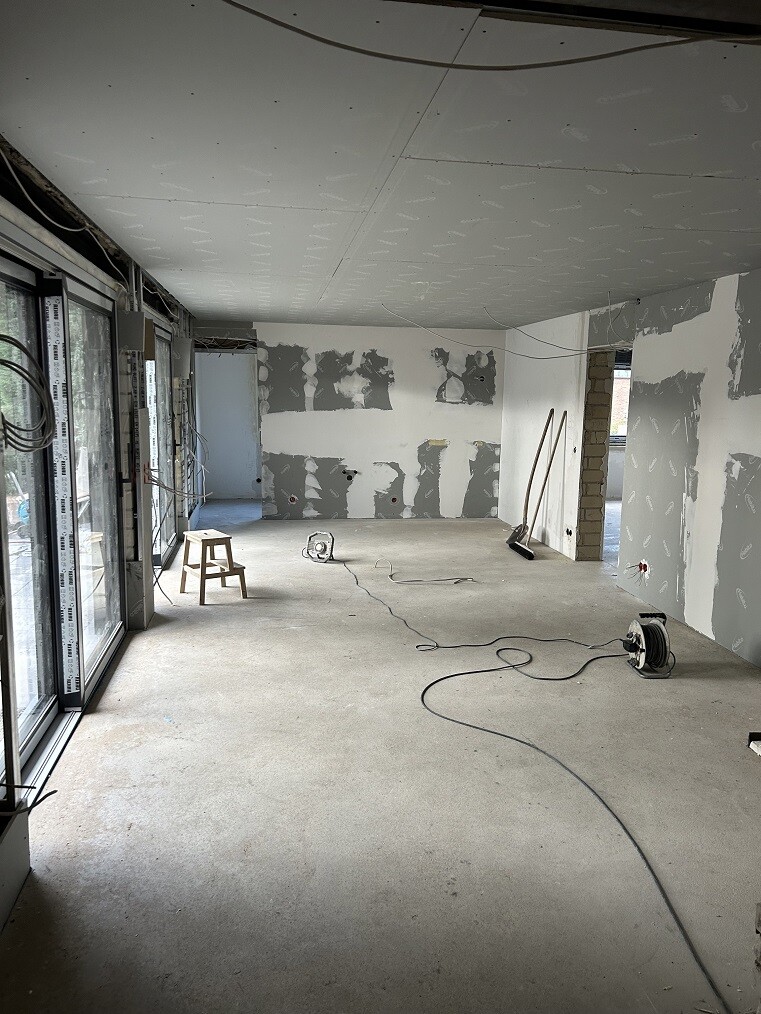

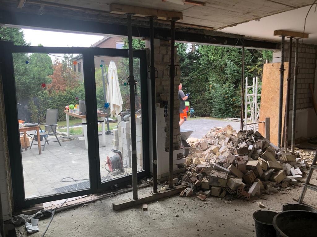

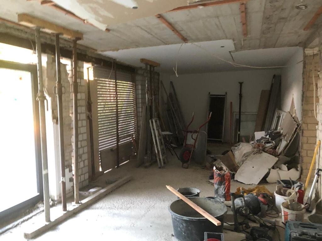

stunningsteve
27 Feb 2023 15:40

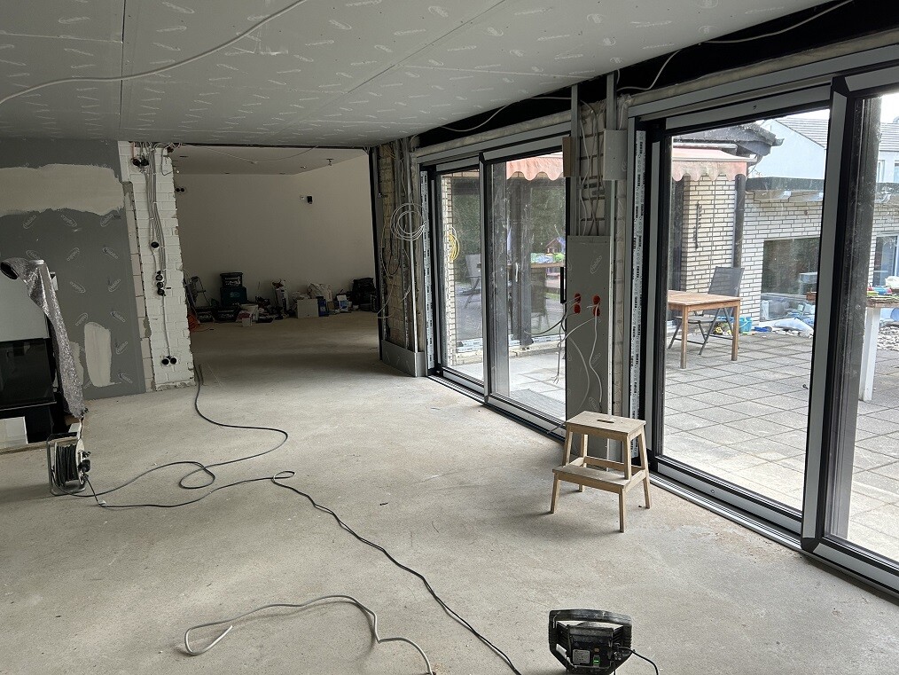

For now, I’ve only dug up some photos of the dining kitchen; I’ll do the living room later. I regret not documenting all the rooms much better.
Construction room with brick leftovers and supports; glass sliding door to the garden; table and chairs outside.
Interior of a construction site: debris, tools, scaffolding, and building materials.
Empty renovation room with unfinished drywall, cables, tools, and a chair on the floor.
Open dining area with wooden table, gray armchairs, glass sliding doors, and modern kitchen.

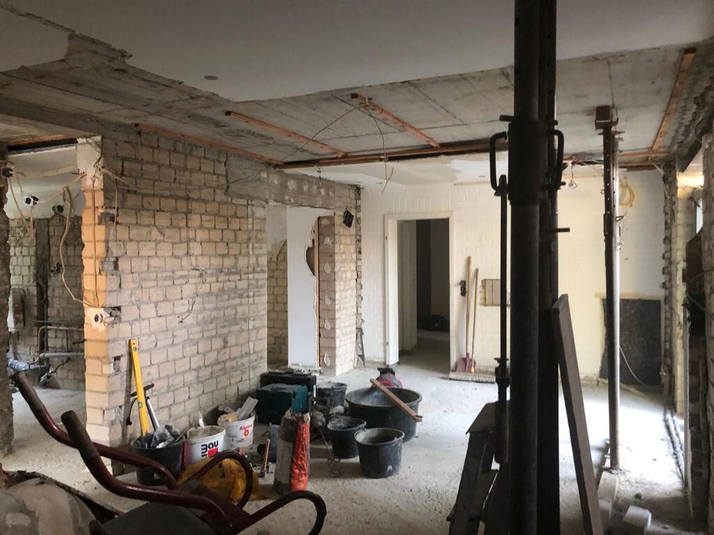

stunningsteve
27 Feb 2023 15:41
Unfortunately, the perspective is not always exactly the same. But I think you can imagine it. The floor plan is two posts above.
Interior of a construction site: unfinished shell with brick walls, columns, buckets, and tools.
Unfinished interior with large glass sliding doors, cables, tools, and ladder.
Open-plan kitchen and living area with dark kitchen island, dining table, pendant lamps, and glass wall facing the terrace.
