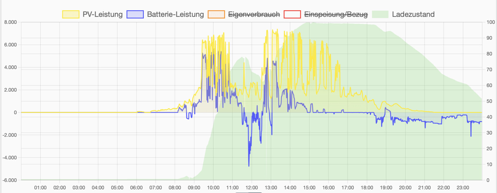

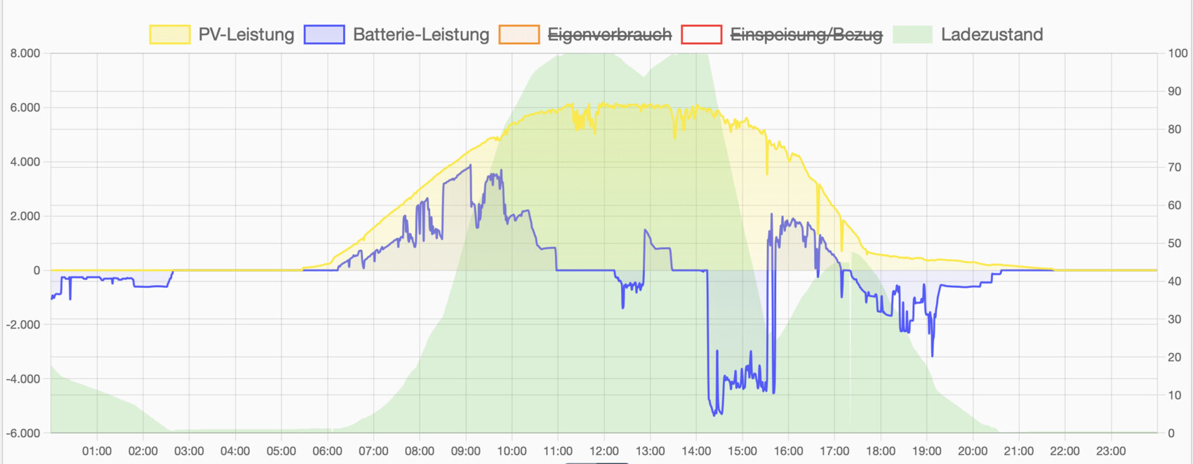

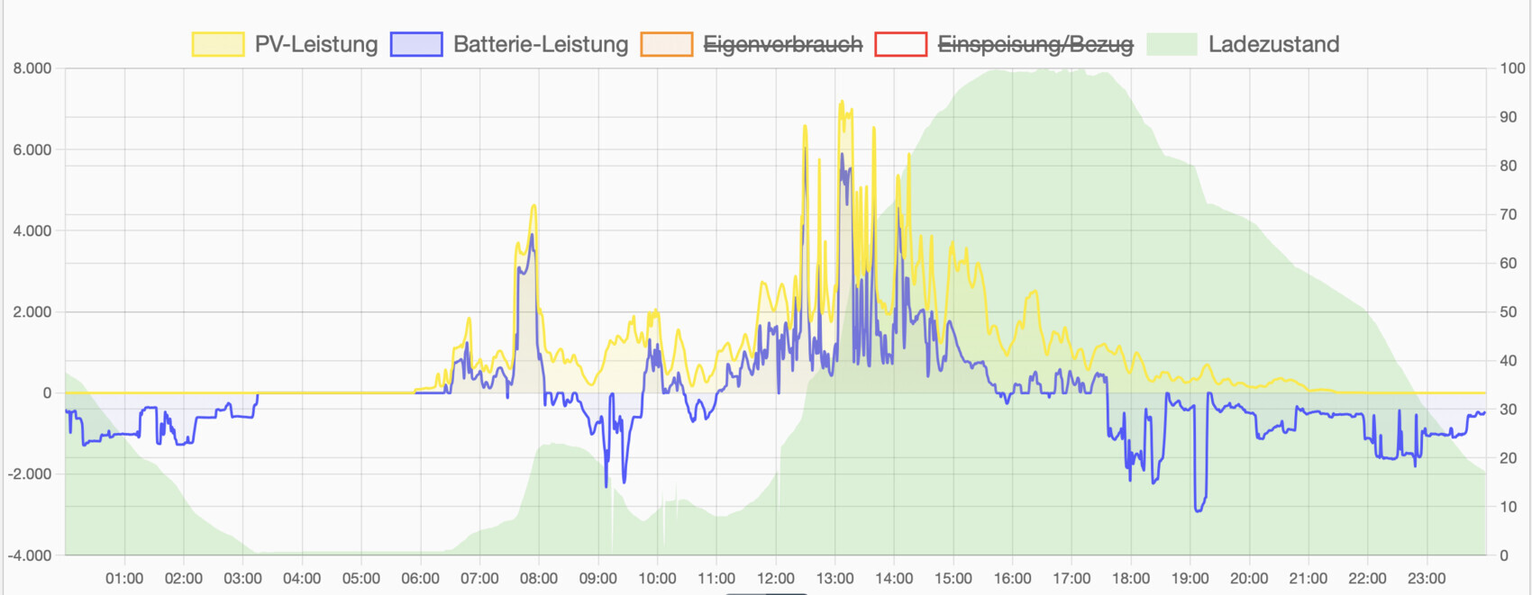

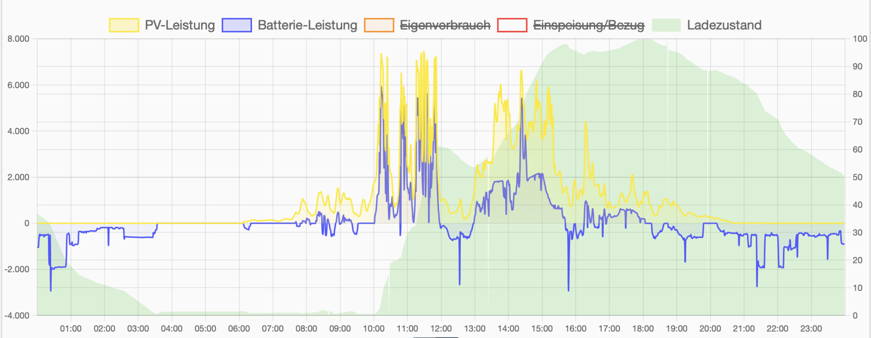

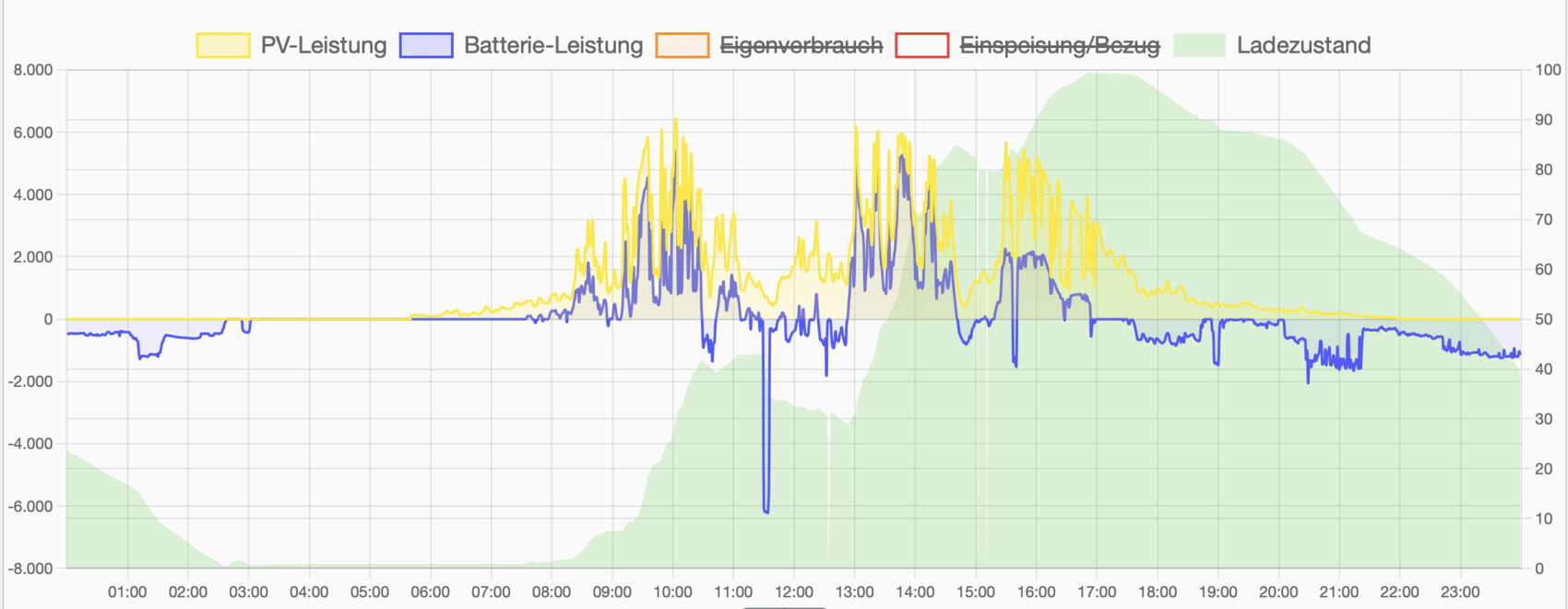

Hangman schrieb:
In theory, that could work by discharging the battery during the day as well, but I’m not quite convinced of that.
There are many days when the battery is partially discharged during the day. This effect is likely even more pronounced during the transitional period in spring.
Graphic: PV output (yellow), battery output (blue), and state of charge (green) throughout the day.
Chart: PV output in yellow, battery output in blue, self-consumption in orange, feed-in/draw in red, state of charge in green.
Daily chart: PV output, battery, self-consumption, feed-in/draw, state of charge (green)
Energy chart: PV output (yellow), battery (blue), self-consumption, state of charge (green).
Daily overview: PV output (yellow), battery (blue), and state of charge (green).
