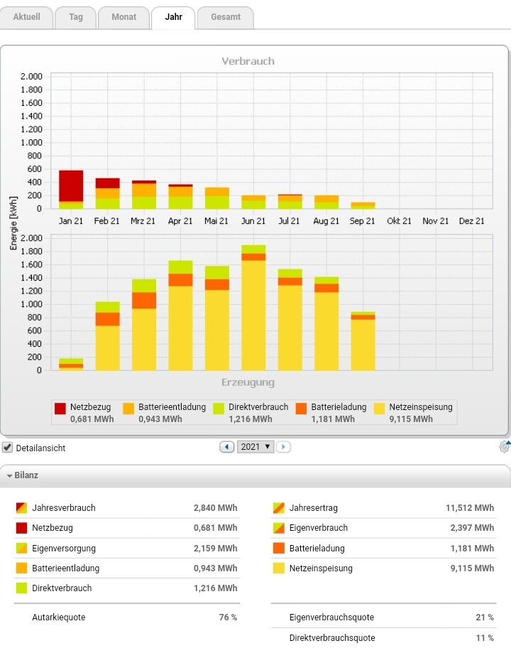

Here is my current energy balance for 2021. This represents the total household consumption measured by a single electricity meter. It includes a ground-source heat pump for heating and hot water, a mechanical ventilation system with heat recovery, as well as other household electricity use. The system features a 14.4 kWp (kilowatt-peak) photovoltaic installation with a 10 kWh (kilowatt-hour) battery, no electric car, and no fireplace:
Annual course 2021: two stacked bar charts showing consumption and generation.
The orange portion of the consumption bars (at the top) represents battery discharge. The annual totals are listed in the table below. You can see that the battery significantly increases the self-sufficiency rate. We only chose the battery to qualify for the KfW 40+ subsidy (6,000 euros) and because the state of NRW provided an additional 2,000 euros direct grant. Whether it would be cost-effective without these subsidies, I cannot say, but probably not.
