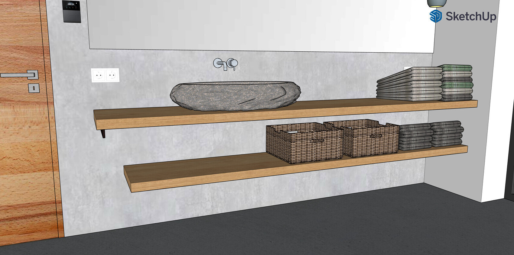

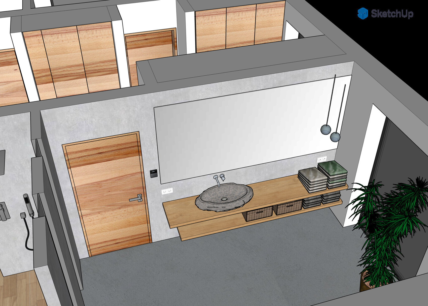

On this, a washbasin countertop about 2.5m (8 feet) wide will be installed, which will hold a countertop washbasin:
3D bathroom with round stone washbasin on wooden console and pendant lights.
What is the best way to build this drywall partition so that I can securely attach the supports holding the "countertop"?
Are standard 100mm (4 inch) CW studs sufficient if I cover them with a 22mm (7/8 inch) OSB3 board, followed by one layer of drywall? (Washbasin weight approx. 50–70kg (110–154 lbs))
Prefabricated washbasin support elements, like those from Geberit, are less useful here because I can’t make use of their mounted threaded rods.
Unfortunately, a DN40 (1.5 inch) drain pipe from the washbasin to the right exterior wall also needs to be routed through the vertical studs.
Bathroom with wall-mounted wooden shelf, stone washbasin, stacked towels, and baskets.

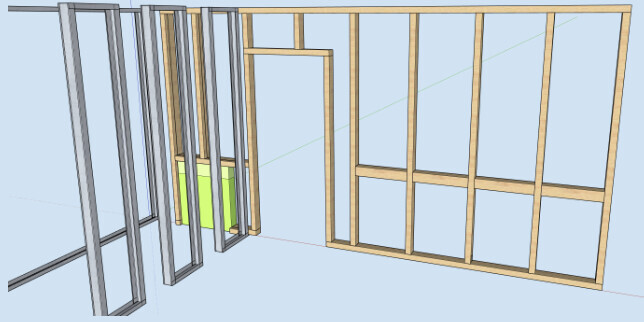

Do not attach the boards directly to the drywall panels themselves, but to a frame that supports the drywall. This is easily achieved with a wooden structure (similar to a mounting frame for a wall-hung toilet).
L
LostWolf
12 Jan 2025 10:05
I originally planned to build the entire structure out of wood.
But then I saw the prices for laminated timber beams.
3D model of a timber wall frame construction with door opening; steel stud on the left, timber wall frame on the right.
You mean to build a beam framework only in the 2.5m (8 ft) wide and about 1m (3 ft) high section, and then construct the rest using standard metal drywall studs?
wiltshire
12 Jan 2025 10:13
This is how I would build it – but not using glued laminated timber; rather, plain kiln-dried structural timber. This way, it’s more affordable and can be worked with easily.
L
LostWolf
12 Jan 2025 10:16
Wouldn't this warp over time, potentially causing cracks (especially on tiled surfaces)?
hanghaus2023
12 Jan 2025 10:38
This is state of the art. There are no cracks, provided the wood is dry.
