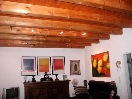

I have an exposed beam ceiling and want to cover it to create a flat, even ceiling surface. What is the best way to do this, and what options do I have?
I have uploaded a picture showing what my ceiling looks like.
Thanks in advance for your answers.

Hello, the most cost-effective option would be to install drywall panels, apply filler, prime, and then either wallpaper or paint. Since I don’t know the measurements and it’s not clear whether all the beams are evenly aligned, you might need to install battens beforehand.

Andreas Euler25 Nov 2009 19:25Hello Lox,
why do you want to cover such a beautiful ceiling?
There are many options, but first of all, it depends on what you want to do with the ceiling later.
You won’t be able to avoid installing battens, as the rafter spacing is definitely too wide.
So, first you need to attach battens that will level the ceiling. You can screw these onto the existing rafters. To level them, you should set the battens perfectly horizontal. For this, you can use special screws that allow you to compensate for unevenness by screwing them in or out, or a more time-consuming but cheaper method using shims of different thicknesses. The spacing of the battens should be as narrow as possible, definitely no more than 60cm (24 inches), depending on what you will install on it later. There are various possibilities: drywall panels (not too thin, or use double layers) followed by wallpaper or similar finishes, or you could make a paneled ceiling or other sheet materials. As said, it depends on what you want to do.
You should also consider a vapor barrier, which again depends on the local conditions.
