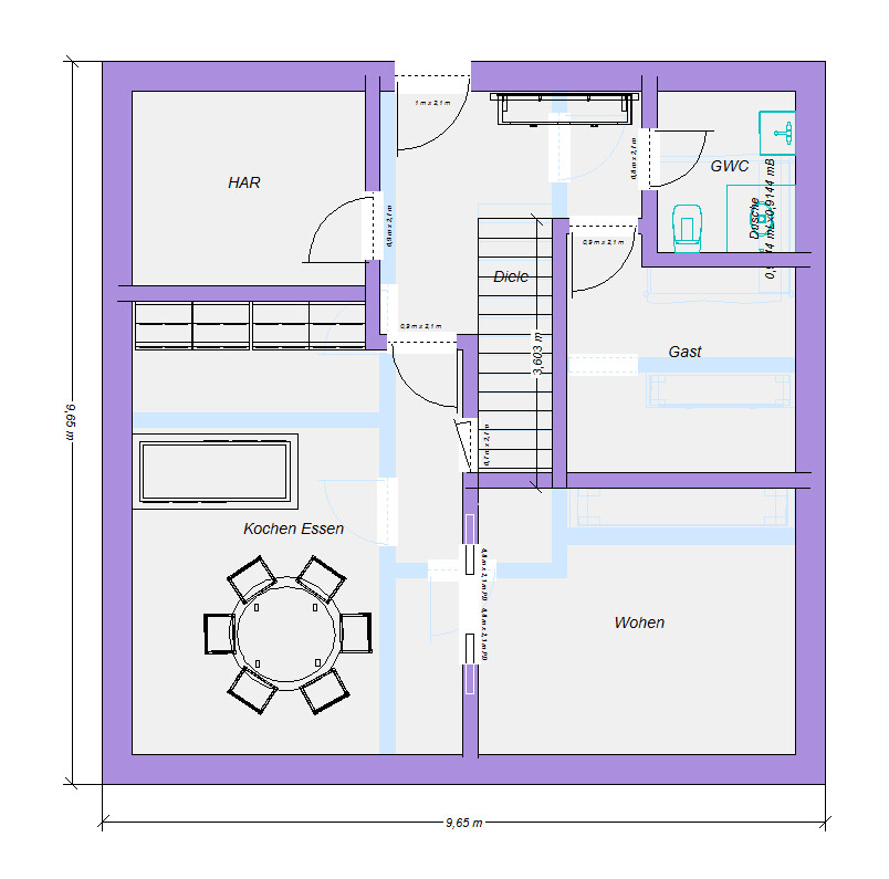

Hello Dear Experienced Home Builders,
We are a young family about to build a house.
It will be situated on a 630 sqm (6,780 sq ft) plot.
We have chosen a townhouse style, currently planning about 135 sqm (1,450 sq ft) of living space.
At the moment, we are not completely satisfied with the floor plan, which we will need to discuss again with the builder (somehow it feels awkward to always have something to criticize...).
We feel the hallway at the entrance might be too narrow because of the straight staircase (it will be a concrete staircase).
Now we are really looking forward to your opinions and also any criticism.
Best regards and thank you in advance.

kaho67431 Oct 2018 16:02
Floor plan of a house with central staircase, two kitchens, bathroom, dining room, and bedroom.
Floor plan of a house: kitchen/dining, living room, guest room, hallway, utility room, guest WC, shower
South at the bottom of the plan
31 Oct 2018 16:29
The entrance is desired on the east side.
kaho67431 Oct 2018 16:45

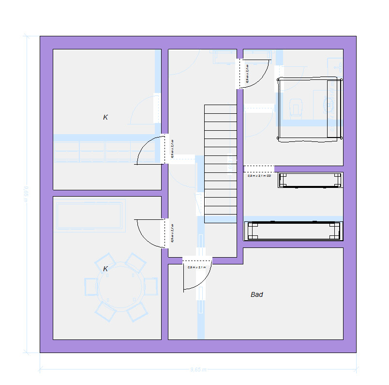

Alternative upper floor:
Floor plan of a house: room layout with kitchen (K), bathroom, laundry, and stairwell.
kaho67431 Oct 2018 16:46
The entrance is planned on the east side
Oh, really? This thread is so confusing. I’ve been struggling for half an hour to figure out where north is.
I was basing it on the last favorite.
