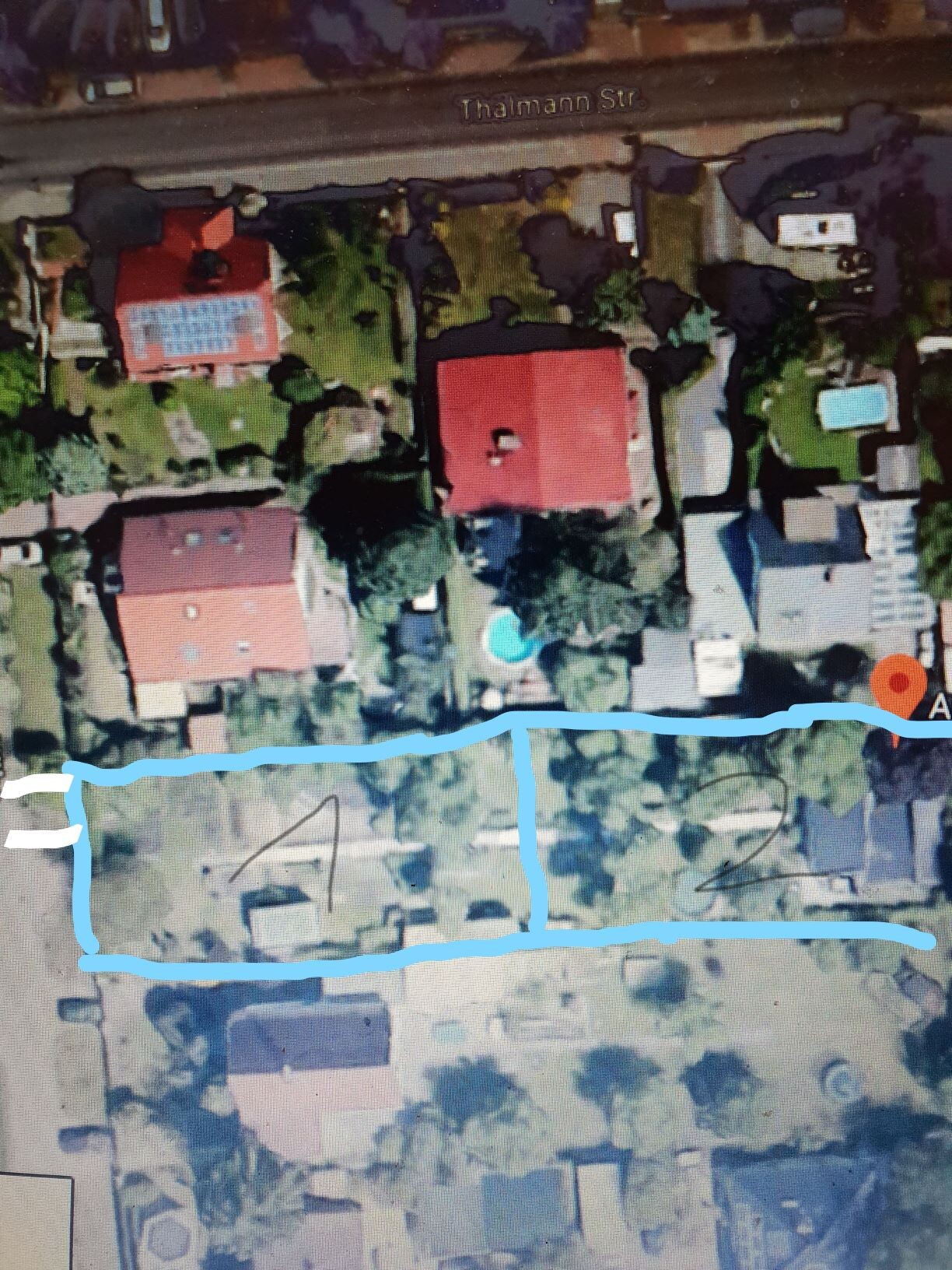

I have uploaded a satellite image of our property. Property 1 is ours, with property 2 behind us belonging to our neighbors.
