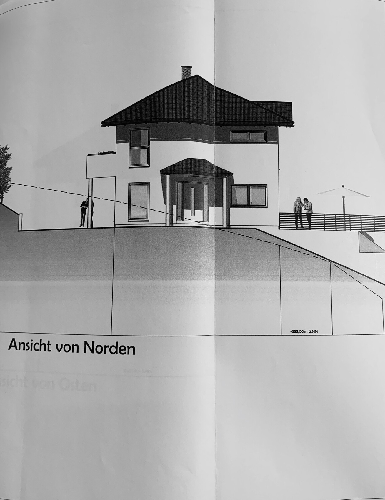

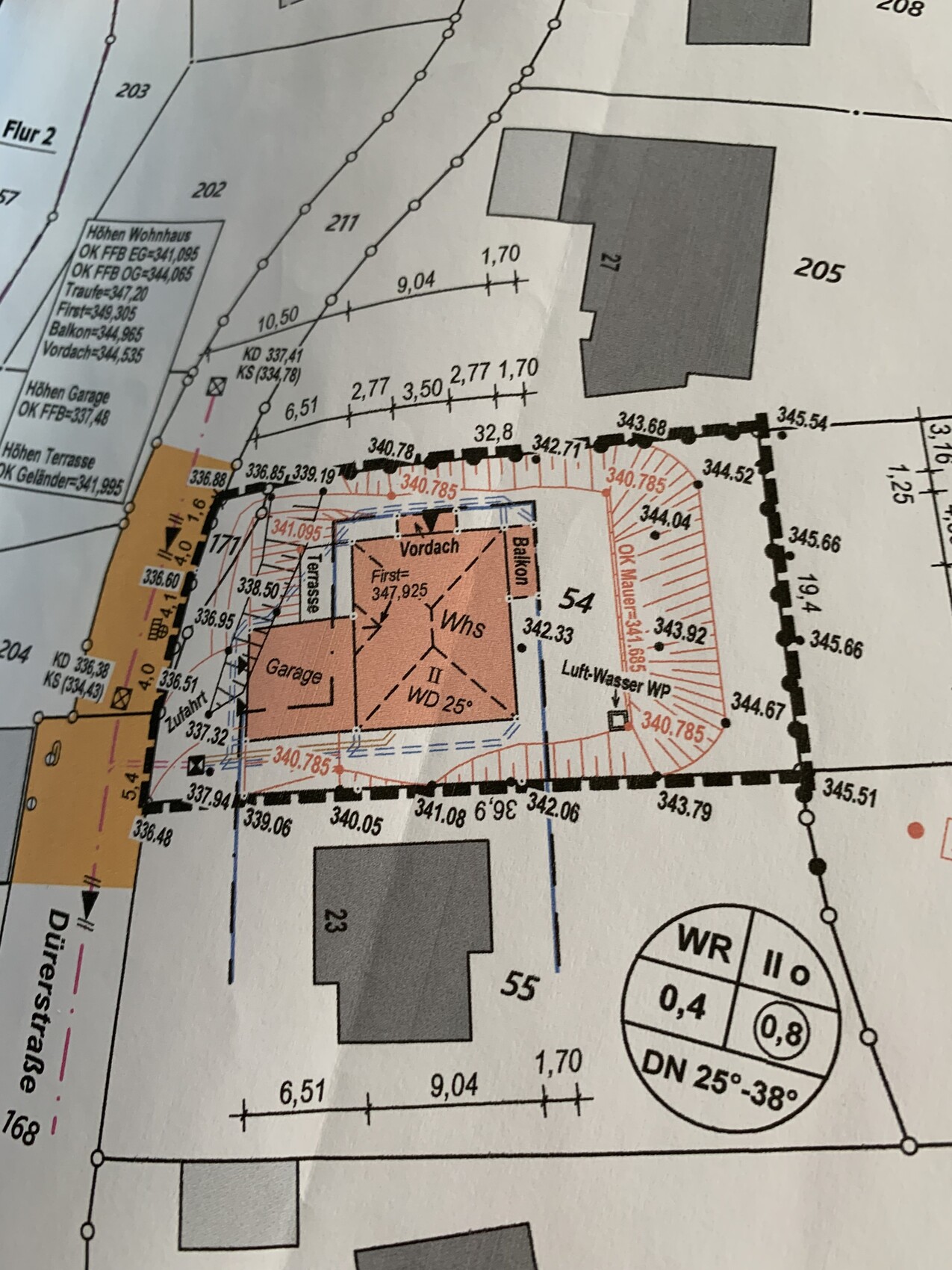

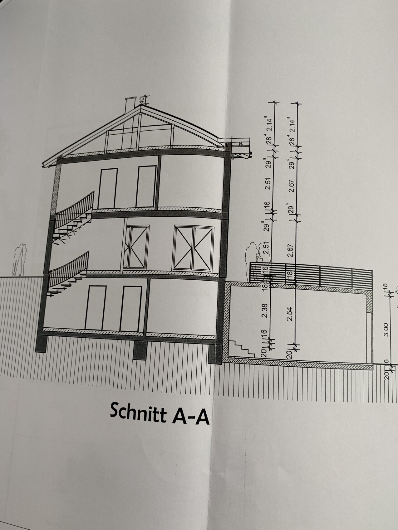

SirDenniMiles28 Mar 2019 12:32hanse987 schrieb:
How do you use the balcony in front of the bathroom?In the evening before going to bed and in the morning after waking up, comfortably smoking on the balcony. Nothing else.
Ah, a site plan.
- You want to position your terrace facing the street, and elevated on display? Really?
- Do you really need the entire basement, or could part of it possibly be used for parking?
- Is there an external path from the parking spaces to the front door at all? Or do you walk past the utility area every day?
