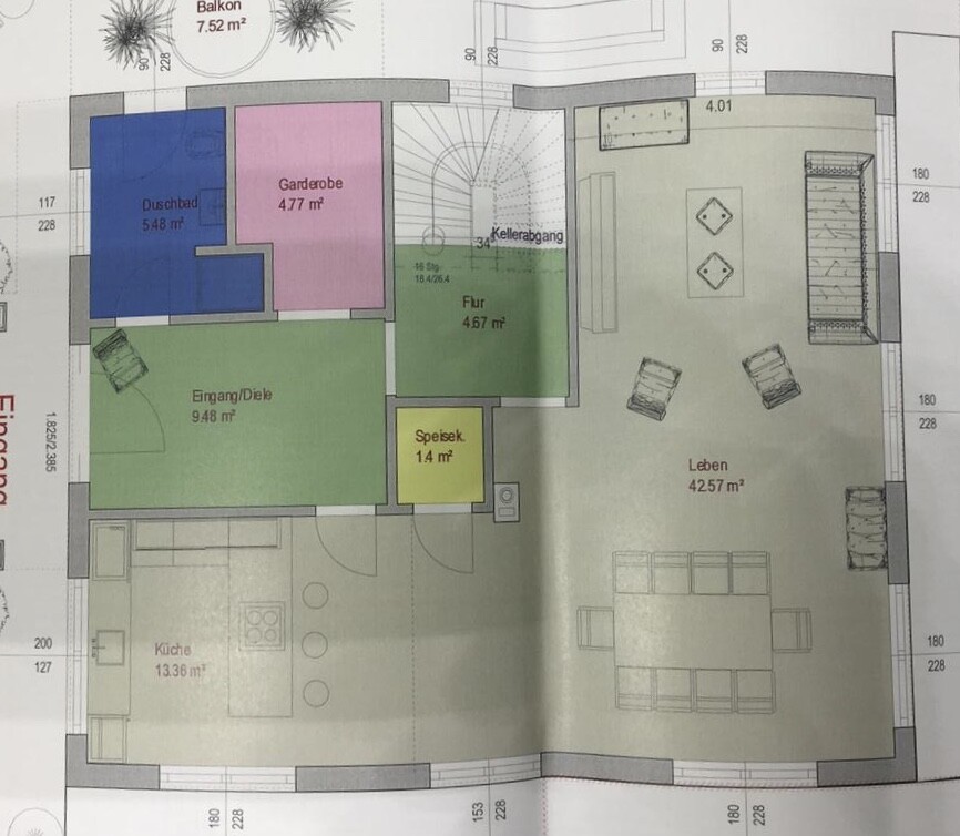

We are struggling with finding the best possible layout for the ground floor of our city villa. The house will be built by Weberhaus – 165sqm (1,776 sq ft) excluding the basement – on a 700sqm (7,535 sq ft) sloped plot. It will have two full floors, a basement, and a hipped roof in a Mediterranean style for the exterior.
We currently have two floor plans and are trying to decide which one is more functional and offers better advantages on the ground floor.
We have decided against a straight staircase because we were told it takes up more space.
What do you think? Which floor plan makes more sense? What could we improve? What else should we consider?
We look forward to your feedback!!

Main entrance next to the garage, downstairs
Cloakroom also downstairs
Side entrance not into the utility room, but into a separate cellar room for drinks and overwintering plants

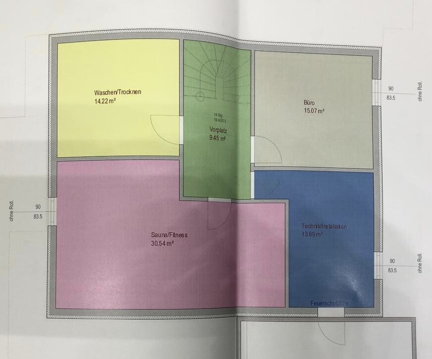

If sauna and fitness area are used, add a shower bathroom in the basement

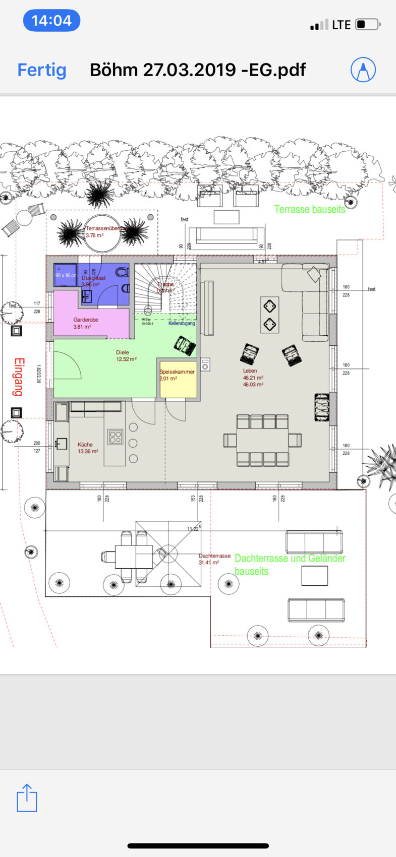

Ground floor
Remove pantry
Remove shower
Entrance becomes the pantry
Open part of the hallway to the kitchen/living area
This will make the kitchen less narrow
Mirror the ground floor layout

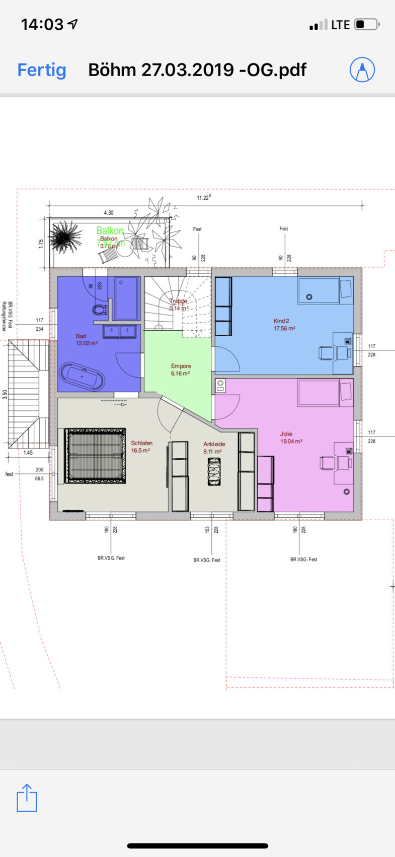

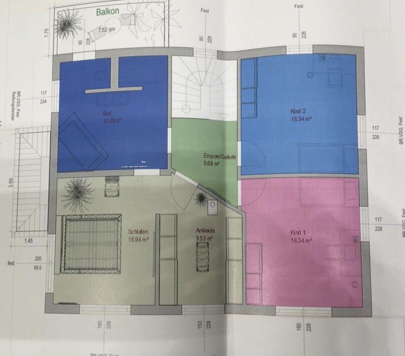

Upper floor
Remove sloped ceiling
Make the bedroom accessible through the walk-in closet
Children’s rooms should be the same size
I don’t like either of the bathrooms
Have you already chosen the finishes?
Check your contract to see if there’s a clause regarding xyz weeks after the building permit / planning permission

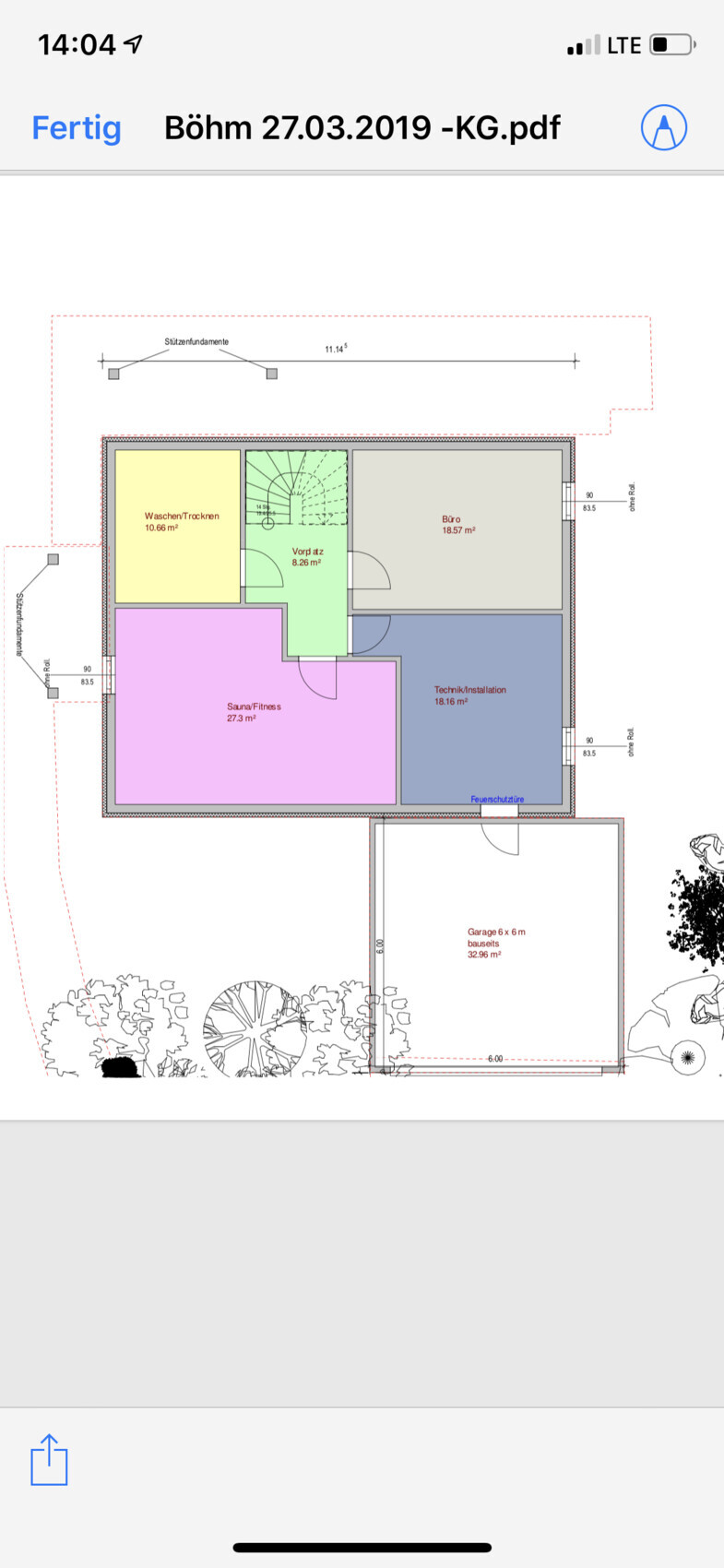

Remove the soil between the garage and the entrance path instead of adding fill there. This will create a daylight basement space.
I would lower the entrance in that area.
Then you can also plan a window in the basement on that side.

Do you really want a door from the bedroom to the bathroom? The person lying in bed will hear everything, and light will shine through the door gaps. The children’s friends might suddenly end up in the bedroom because they chose the wrong door to exit... Or, conversely, you might catch visitors in the bedroom when they’re in the bathroom because they didn’t know there was a second door that needed to be locked...
SirDenniMiles schrieb:
Well, that’s certainly a way to lure people into signing a contract. Very impressive at first glance. But here, it will probably only impress a few. I would probably prefer to move in next door instead.What are you willing to compromise on inside, regarding your floor plan? haydee has already mentioned quite a few points. What do you think about them? I especially find the window for your home gym very important. Not taking advantage of it on this slope seems quite unwise.
kaho674 schrieb:
haydee has already mentioned quite a few things. What do you think about that? Silence from the other side. Apparently, the man is overwhelmed by the many options. So maybe we should ask the other way around: What would you like to change about your current floor plan? What bothers you?
