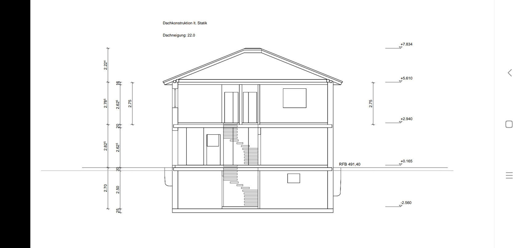

Bauherrin9225 Feb 2019 11:40Hello everyone, thank you for the many comments.
After visiting model home parks again, moving things around, discussing with the general contractor, etc., we decided to keep the main elements from #1 with some optimizations. I will share the plans here once they are finished. In advance:
- We decided on a platform staircase (additional cost of 500 euros).
- The walk-in closet in the bedroom could be enlarged.
- The T-shaped layout in the bathroom will be removed.
- The arrangement of the guest WC/cloakroom was changed.
- Some windows were shifted here and there.
- The garage will be attached to the house, as otherwise there would only be 80 cm (31 inches) of space. We prefer to keep those 80 cm (31 inches) free towards the property boundary, since (according to the building authority) there are often disputes regarding garages close to the boundary.
- The 8 m (26 feet) distance from the street to the house now seems quite good to me, so it will remain as is.
Regardless of the floor plans, I have some general questions:
- What do you think about these ceiling heights? Personally, I worry they are too low, but my husband thinks they are fine.
- The double windows measure 151 cm (60 inches) wide x 126 cm (50 inches) high, and the floor-to-ceiling double windows are 151 cm (60 inches) wide x 226 cm (89 inches) high… is that too small? In the model homes, the windows are much larger.
Thanks in advance!

Basement with 2.5m (8.2 ft) clear height, but no screed?
Living rooms with 2.46m (8.1 ft) clear height? That would be way too low for me.
In our basement, we have 2.42m (7.9 ft) clear height, and I already find that quite oppressive. On the ground floor, we have 2.695m (8.8 ft) and on the upper floor, 2.57m (8.4 ft).
Bauherrin92 schrieb:
- What do you think about these ceiling heights? Personally, I’m worried they’re too low, but my husband thinks they’re fine.
- The double windows are 151 cm (60 inches) wide by 126 cm (50 inches) high, and the floor-to-ceiling double windows are 151 cm (60 inches) wide by 226 cm (89 inches) high... is that too small? The show homes have much larger windows... You’re not building a show home.
If I’m correct, the ceiling height is 246 cm (97 inches) minus the ceiling plaster. I would say you can’t really see the difference to 250 cm (98 inches). Anyone wanting more height would also need space for an additional step.
The window sizes provide sufficient daylight. A single sash at 151 cm (60 inches) wide would be too heavy, so a double sash is appropriate. The width hardly justifies an asymmetrical division, so I would divide them symmetrically. For the emergency escape window, it would need to be a mullion (stulp) design; for the other windows, I would handle it the same way. Using posts is slightly cheaper but reduces the glass width more (it doesn’t really make the room darker, just feels a bit that way).
