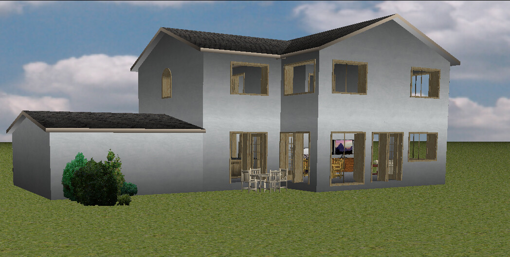

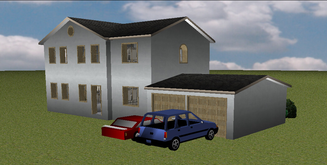

Bauherrin92 schrieb:
I had already mentioned that we want an urban villa with a spiral staircase, a hip roof, etc... An urban villa—that’s boring. This is what #60 looks like now:
The floor area is the same. Just a few walls moved. Does that still count?
kaho674 schrieb:
City villa – that’s boring now. This is what #60 looks like so far:
The footprint is the same. Just a few walls shifted around. Does that still apply? Yes, that’s true, only the price is no longer the same for the roof compared to a simple hip or pyramid roof.
Yes, but the price no longer matches for that roof compared to a simple hip or pyramid roof Oh, don’t be so petty.
Yes, but the price no longer applies to the roof compared to a simple hip or pyramid roof.I always thought that a gable roof is cheaper and easier to build than a hip or pyramid roof, or is irony involved here?!
tumaa schrieb:
I always thought that a gable roof is cheaper and simpler than a hip or pyramid roof, or is there some irony at play here?! Not if they are conjoined twins.
However, the floor plan is great for a partial basement – that’s where we’ll get the money back.
