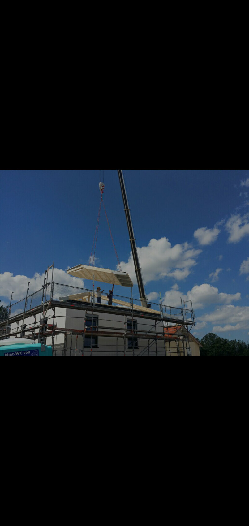

mondbau schrieb:You can work with different timber dimensions and calculate differently.
Why are truss roof structures used when there are simple self-supporting ones? Huge cost factor?
mondbau schrieb:
Why use pitched roof structures when there are simple self-supporting options? Is it mainly due to the immense costs?I think "simple" is a myth in this context. The ring beam has to work a lot harder, I would say.https://www.instagram.com/11antgmxde/
