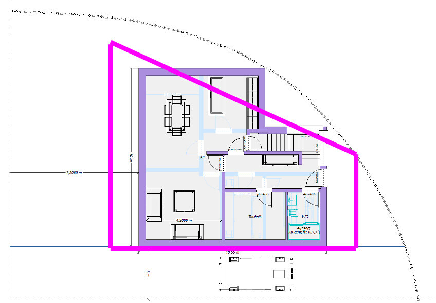

My absolute favorite would probably be to follow Yvonne’s suggestion and build a straight east side with perpendicular north and south sides, and then design the west side to follow the plot width either as an L shape or angled.???Do I understand correctly that instead of the rounded corner you want to extend an angled wall? And how would the L shape look?
kaho674 schrieb:
Do I understand correctly that instead of a curved wall, you want to have a slanted wall? And what would the shape of the L look like?You can see the L as you showed it; and – now just in principle as an outline, without fitting it into the floor area ratio – how I mean it, overlaid in pink: https://www.instagram.com/11antgmxde/
like overlaid in pink what I mean:
[ATTACH alt="32772-synthese.png"]39636[/ATTACH]That's what I feared. That wouldn't be my style at all. The sharp angle on the southwest side is useless and it's ugly, too. :PHello
Whether to use the angle or not depends on the requirements and the floor plan.
Whether it looks unattractive or not is a matter of taste. In the floor plan it may look unusual, but in the elevation views and later in the finished building it becomes less noticeable. In owner-occupied properties, rental units, and garages, I also align some walls with the building limit. Even though the plots are large enough, in my opinion, there is no reason not to use the space optimally.

kaho674 schrieb:
The sharp angle in the southwest corner is completely unusable. That was just a purely schematic representation; the slant can be much more subtle. I only mentioned it because you rejected Yvonne’s suggestion of a rectangle, saying the outcome could be very narrow. This issue can be avoided in two ways: by having the fourth wall step inward (forming an L shape) or by angling it, both of which I consider worth considering.
