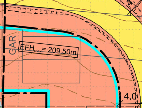

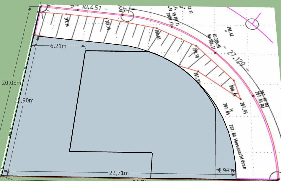

I am currently planning a house on a somewhat challenging plot shape. (Of course, the question immediately arises, "why don’t you buy a plot with a better shape to work with?" Answer: in our region of BW Region X, there are hardly any affordable plots. The city’s land prices are around 480 €/m2 (about $45 per sq ft).) The plot is located slightly outside the city and was purchased relatively cheaply.
Okay, so I now have the plot, and “only” the house is missing on it.
In advance: the building authority gives me no exemptions whatsoever.

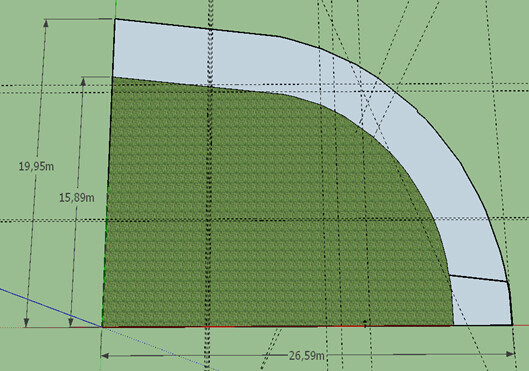

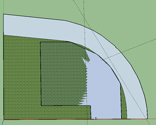

A major challenge is the house geometry because I prefer having the terrace on the south/west side and still enough space inside the house.

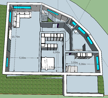

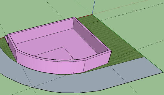

In the first attempt, I planned several corners. House geometry as ground floor:

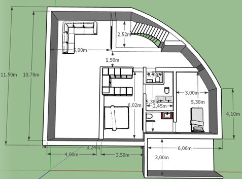

Based on your contributions and ideas, I completely rounded it into a quarter circle, which I also like better and can get used to.
Yes, the topic of walls, windows, and furniture is a bit more complex, but it has its charm.
Currently, I have considered the following layout.

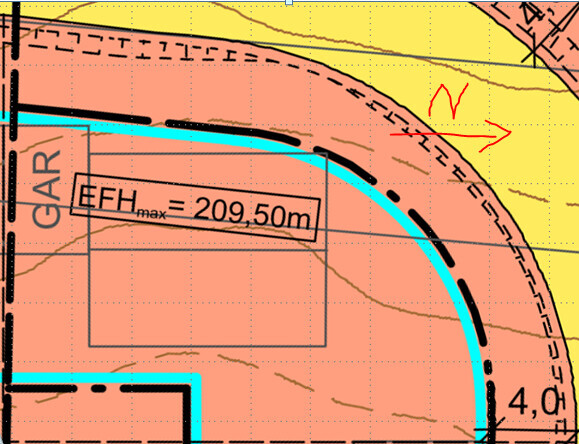

Building envelope: see development plan above (2.5 m (8 ft) to neighbors)

1. Do you prefer the rounded design over the corners from the first draft?
Before:
Now:

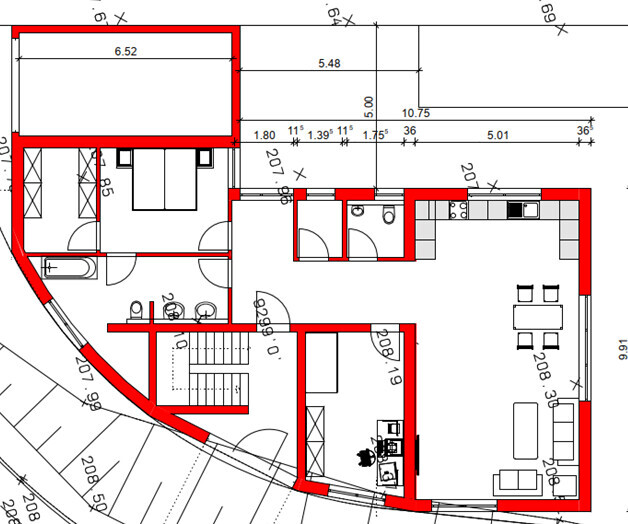

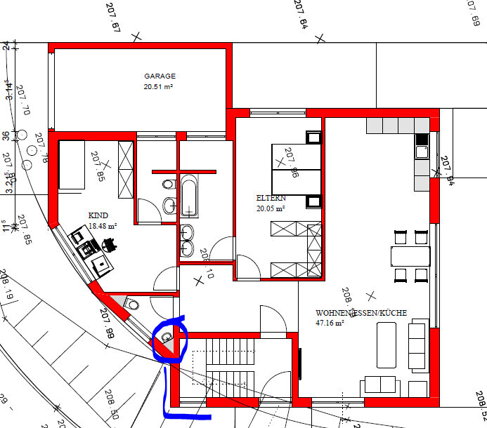

2. What do you think of my new floor plan?
Architect criticizes:
--Bathroom without windows (No-go?)
--Small entrance area, staircase without a landing is bad, basement stairs are bad
--Bedroom 2 should be in the east (if child)
3. How would you optimize the weaknesses from point 2?
4. How do you find the architect’s initial draft?

Orientation: see development plan above, right side

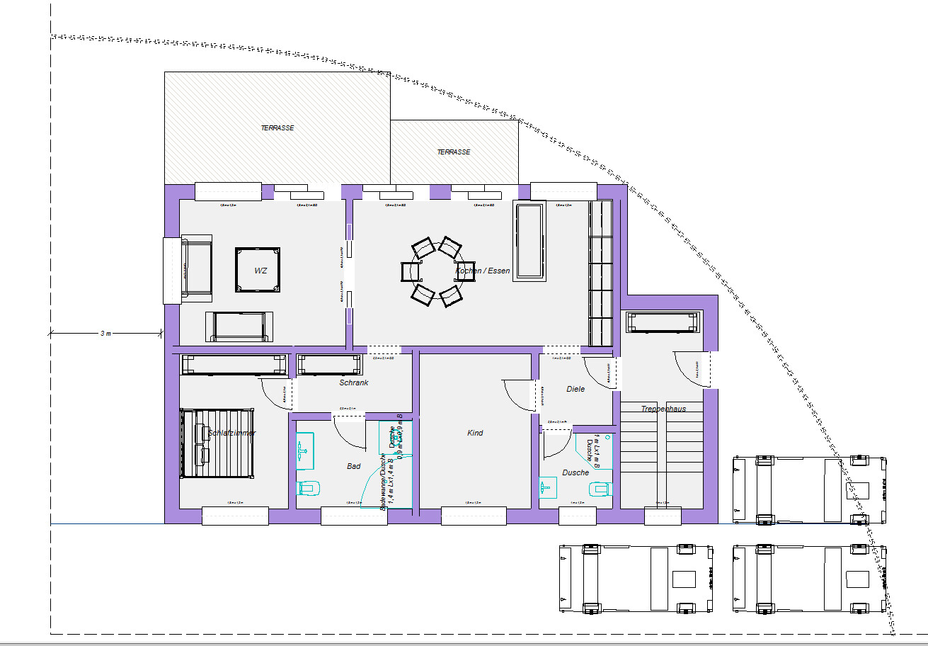

kaho674 schrieb:
Or maybe something like this:
[ATTACH alt="mit ELW-EG.jpg"]39704[/ATTACH]
[ATTACH alt="mit ELW-OG.jpg"]39703[/ATTACH] Thanks a lot, Katja, that also looks good.
I’ll show this to my architect. I really like the living, dining, and kitchen area opening to the terrace in this design.
My architect has also presented a new draft, I’ll share it with you soon, but it follows the old layout pattern ;D
Best regards and many thanks for your support. I’ll update later about how the architect handles the integration.
I’m afraid I can’t get enthusiastic about this. What’s the purpose of the windows facing the garage? Or is it meant to be a carport? Why is the entrance on the west side? The toilet in the main bathroom is incredibly noisy in the children’s room. It’s also very important to know how much of the plot is still available. The south side, including the terrace, must be fully shown for a design discussion. Also, all parking options should be included. Or is it now just going to be a bungalow with a basement for a single family?
I’m still favoring option #12 if you are building the house for yourselves and it’s not fixed who else might live there.
If it must absolutely be a two-family house, you need to show the parking spaces first! Where else are all these vehicles supposed to be parked?
For that, I would move away from the focus on the south and consider a west-facing terrace instead. It would look something like this (upper floor identical):
Draw the actual furniture accurately in the open space as you plan to buy or already have it. The small dining table gives the impression of more space than there really is.
Where will the parking spaces be located?
Does the master bathroom have no toilet?
Somehow, the design feels like a random mix. An outdated master bathroom combined with the curve, which does not come across as a highlight inside.
Construction costs are extremely high, yet the living experience feels like a boring apartment.
If you like the curve and want it, then design your house so that its interior truly reflects that feature. Plan a house for 1–2 children or 3, depending on what you envision. If there are no children, you will have a spacious home for two.
A master bedroom with an en-suite bathroom featuring a freestanding bathtub.
A living room that incorporates the curve inside.
Recently, someone posted an amazing bathroom with a large glass area in front of the bathtub and a gallery. There are so many possibilities. Take a look, for example, at home design magazines or visit nearby prefab home show parks like those from Huf and similar companies.
You are investing well over $500K, more like $700K to $800K, so this should be clearly reflected in the interior.
