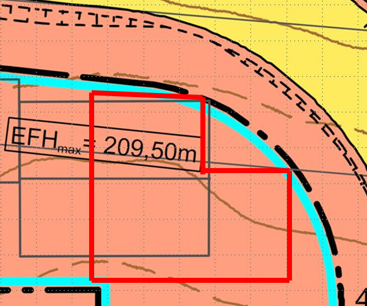

In the first attempt, I planned several corners. House geometry as ground floor:

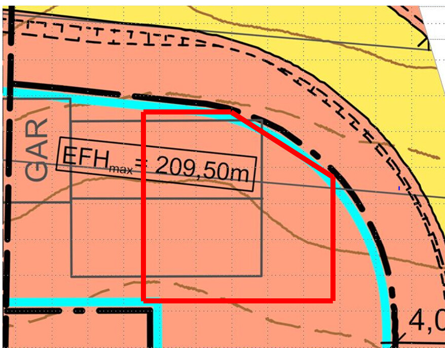

Based on your contributions and ideas, I completely rounded it into a quarter circle, which I also like better and can get used to.
Yes, the topic of walls, windows, and furniture is a bit more complex, but it has its charm.

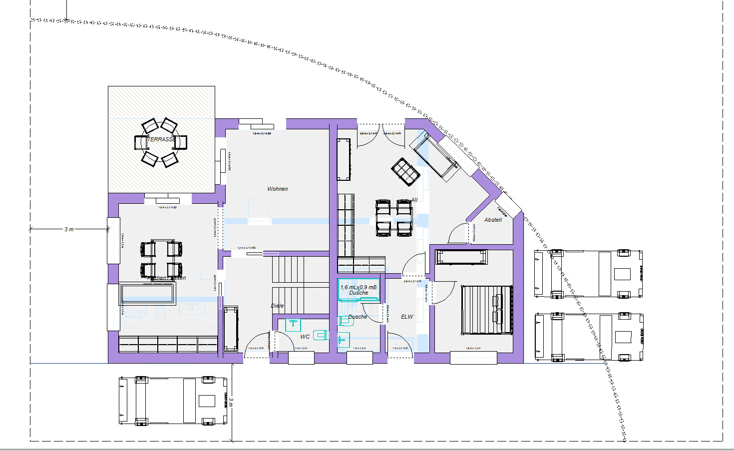

Currently, I have considered the following layout.

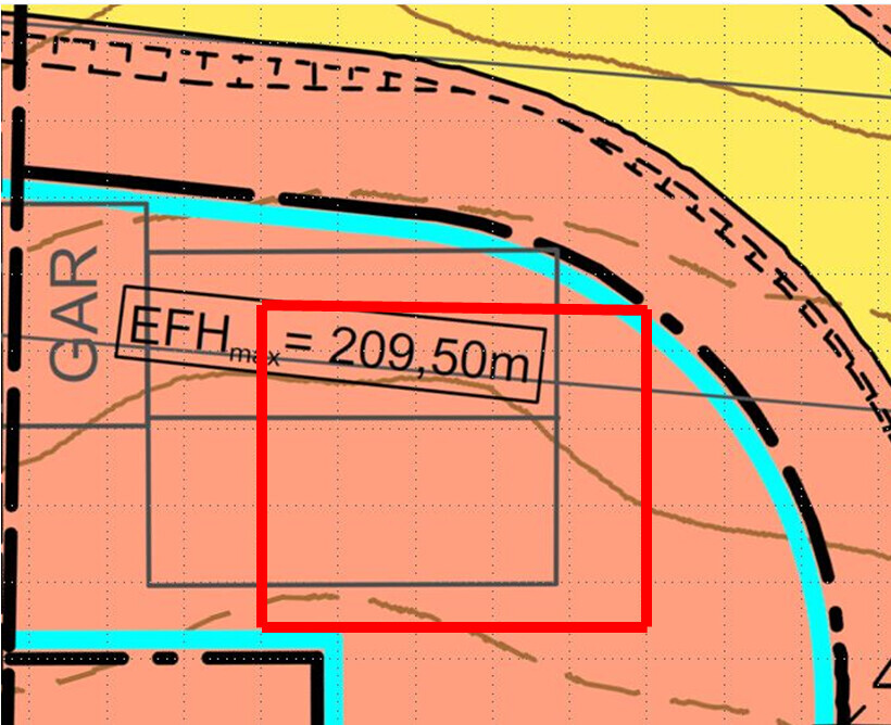

Before:
Now:

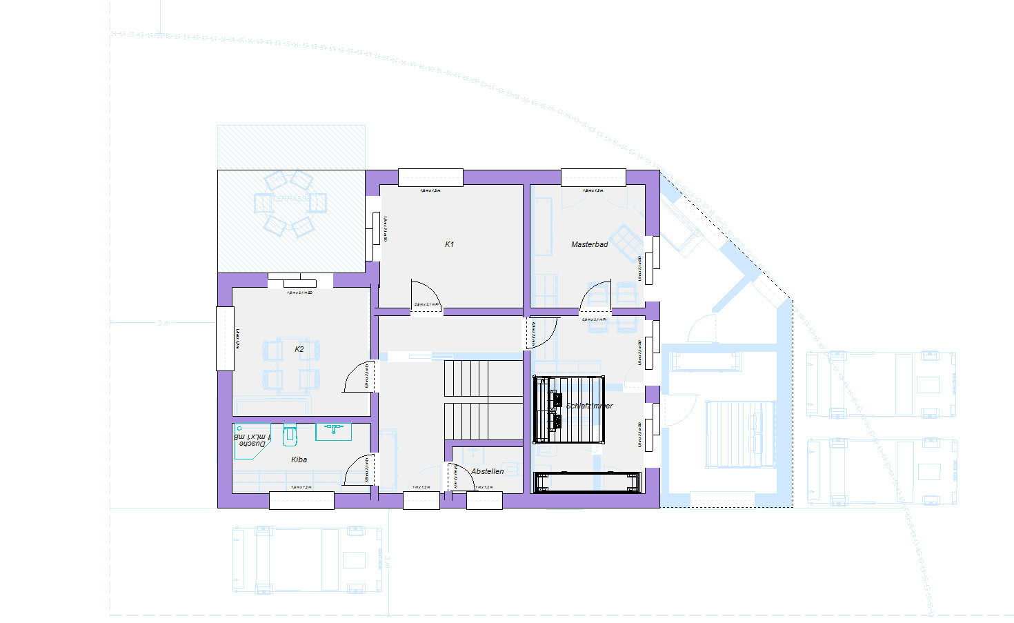

2. What do you think of my new floor plan?
Architect criticizes:
--Bathroom without windows (No-go?)
--Small entrance area, staircase without a landing is bad, basement stairs are bad
--Bedroom 2 should be in the east (if child)
3. How would you optimize the weaknesses from point 2?

You don’t have to focus on "your square meters": square meters is a measure of area, not quality. Plan your house while considering the building envelope as the boundary framework. What you should avoid—and what can only go wrong—is trying to fill the building envelope completely and, in my opinion, hoping without reason that the house placed within it will automatically have valuable living space.
Serdar88 schrieb:
...a good solution might be the L shape or option 1 maybe, or=?Or maybe something like this:

I will look into the options in the next few days and report back on what I decided.Try to at least think about your space and room requirements. Start with a list of rooms you absolutely need (excluding those you might want in 20 years). Add the sizes you imagine for each room so that the total area comes to a certain size (initially, a maximum of about 140 m² (1506 sq ft) is sufficient). Then, arrange these rooms as simple rectangles within the building footprint. As gaps appear, a guest toilet, a cloakroom niche, and a hallway will form somewhere.
It might sound childish, but give it a try.

So, the curve is out. Option 2 is definitely the easiest, but then I don’t reach my m². A good solution would be the L-shape or maybe option 1, right?

It would be really helpful if you learned from the previous posts and oriented the drawings with a north arrow. Other threads are being answered simultaneously here and time is taken, so the orientation information gets lost quite quickly. For newcomers, north is always at the top!
It would also be great to see the entire property, not just cut off at the building boundary. The relation to the neighboring lots is completely missing here as well.
