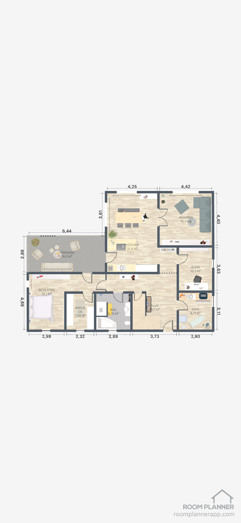

Hello, I would like to hear your opinions. What do you think? Are there any suggestions for improvement? The west side faces open fields, so we wanted the living room to be oriented that way.
Plot size: 900 sqm (9,688 sq ft)
Flat land
Floor area ratio 0.4
Building line and boundary: 3 meters (10 feet)
Number of floors: 1
Roof style: gable roof and flat roof
Architectural style: modern
Orientation: west
Small office, only for emergencies
3 people aged 38, 38, and 2
No overnight guests
Large kitchen with dining area, separate living room, covered terrace
- Do-it-yourself
We considered all the desired rooms.
Access from terrace directly to kitchen and bathroom.
The main house will have a gable roof to allow attic space for storing boxes. The pull-down staircase can be installed in the long hallway. The part with the covered terrace will have a flat roof. However, we are not sure if having two types of roof will be expensive.
We also like a modern gable roof with trapezoidal metal roofing. This should be quite affordable… does anyone have experience with that?
I attached a picture of various houses that inspired us.
Does anyone have a rough idea of the cost? We are still very early in the process and many builders are reluctant to provide quotes due to uncertain material prices.
Construction is planned for 2023.

Zweithaus schrieb:
Thanks, I’ll try to apply that right away! ☺
Now I'm unsure where to place the staircase
Floor plan of an apartment with kitchen, living room, bedroom, bathroom, hallway, and dressing room.
haydee
23 Oct 2021 09:41
Just leave out the guest toilet again
swap the dressing room and bathroom
haydee
23 Oct 2021 09:43
Or you could turn the walk-in closet into a built-in wardrobe and a guest bathroom.
A wardrobe should fit in the bedroom.
Are the two doors the only access to the outside?
23 Oct 2021 10:20
Zweithaus schrieb:
Now I’m unsure again about where to place the stairs [ATTACH alt="bungalow floor plan for 3 people 130sqm please opinions 535201-1.png"]66343[/ATTACH]
Because you keep drawing the same thing instead of starting over.
driver55 schrieb:
That doesn’t work because you always end up in the same dead end.
You always draw what you are used to.
That’s why you hire someone who doesn’t have that problem.

23 Oct 2021 13:52
I think it could turn out like this? I'm looking forward to seeing!
Floor plan of an apartment with living room, kitchen, bedroom, bathroom, hallway, office, utility room, and terrace.
11ant23 Oct 2021 15:35
No, definitely not, because you are just stirring things up. Unfortunately, that is not a suitable planning method. You have already received some input here. Try applying it on a "clean slate" instead of merely treating it as random repositioning commands for your interior walls.
