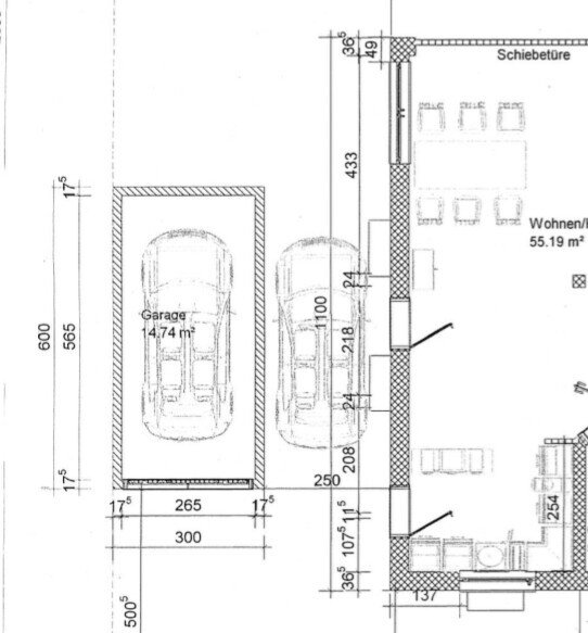

2. GARAGE: Double Garage or Single Garage with Carport
In the last couple of days, we had several discussions with the contractors who made us a bit unsure.
We initially wanted a single garage with a carport. Reasons:
- More natural light on the ground floor since we face southeast. This would gain us additional light. A double garage would block the middle window.
- We were willing to accept a smaller garage. There was supposed to be a small shed behind the garage for bikes, etc. We also have a basement.
Now the sheet metal master said the garage is too small for him and he recommends a double garage. He added that with a carport it would be too dark anyway.

Quote: Now the roofer master said the garage is too small for him and he ...
Does _he_ want to park in it or who?
We also have a garage about 3 meters (10 feet) wide. The space is tight. Still, a few shelves fit inside along with my husband’s car – a convertible with wide front doors.
It often requires a compromise. But 1. even a narrow garage like this can function as one, 2. it has to be enough for _you_ 🙂

@ypg – that sounds good so far. If you have that garage width and it works out. Thanks! 🙂 My concern was that it might actually be too small, and out of fear for my side mirrors, I would only park in front of the house. ^^

@RobsonMKK. Haha. If anything, it will be a very small secondary car. You can also park in front of the garage, and there are parking spaces opposite the house as well. That’s why we made the garage as wide as possible and gave less priority to the carport.
