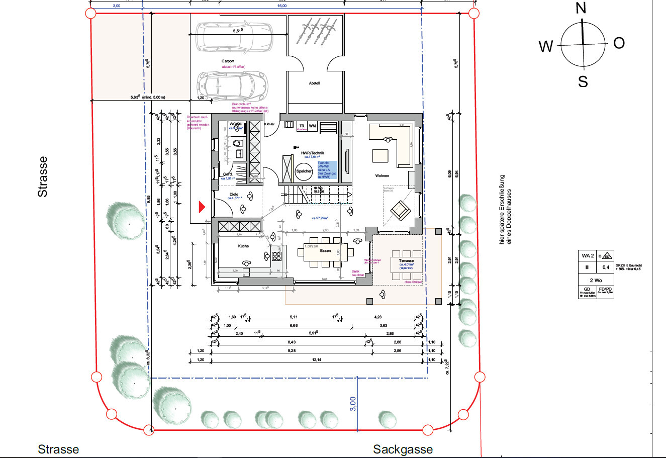

I’d like to share a floor plan idea from my partner and me. We’ve already gone through several rounds with an architect from a general contractor and are now at a point where I would like to use the collective intelligence of this forum to discuss possible errors or improvements in the floor plan.
First of all, I want to say how incredibly grateful I am that this community exists. I have spent many hours and days here reading up on various topics. Keep up the great work!

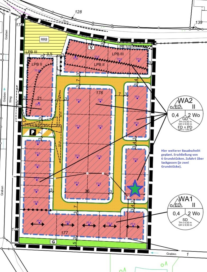

Our plot is marked with a star in the “Development Plan” photo. In the ground floor photo, you can see the dimensions. I hope I haven’t forgotten anything (but I’m sure you’ll point it out if I have)!

What do you like most? Why? – the angled living/dining area, staircase integrated into the living space, gallery, master area including bathroom

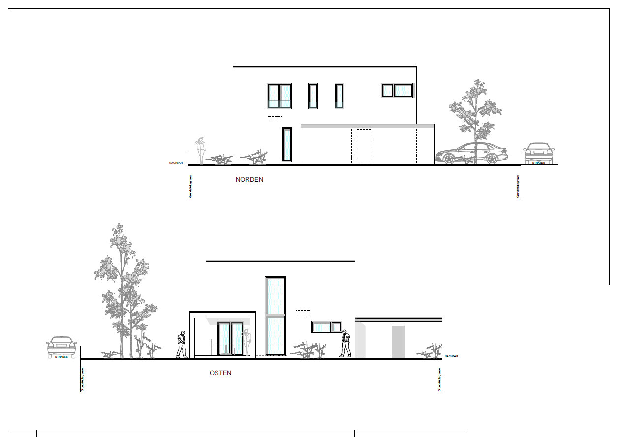

What do you dislike? Why? Kitchen, possibly too small, windows in the living/dining area not yet final, covered terrace still not quite right, exterior looks too boxy

Site plan: red marked building areas, yellow streets, blue boundary lines.

Pinky030110 Nov 2020 13:54
At first glance, I like the floor plan!

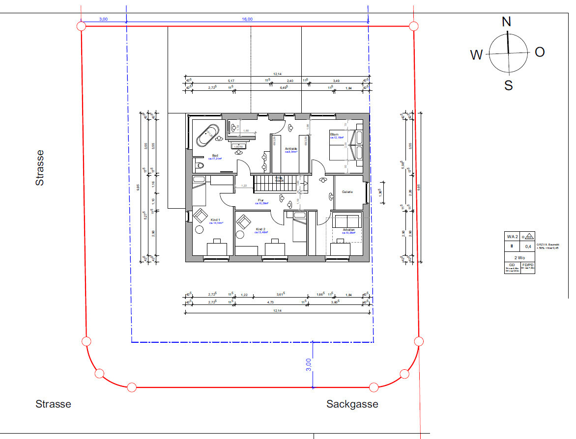

In the upstairs bathroom, I would add a second sink if it is going to be used by four people. Also, I would avoid a freestanding bathtub and instead enclose it, because who is going to crawl behind the tub to clean there?
The door opposite the shower is a bit unusual 😉 I can imagine that children might lock it and later forget to unlock it.
In the kitchen, I wouldn’t place the cooktop on the island. This area should be kept clear since it can be nicely used from all sides, for example, for baking cookies with children.
One thing I might do differently: skip the open space above, and instead have two bathrooms upstairs. Remove the shower on the ground floor and enlarge the cloakroom.

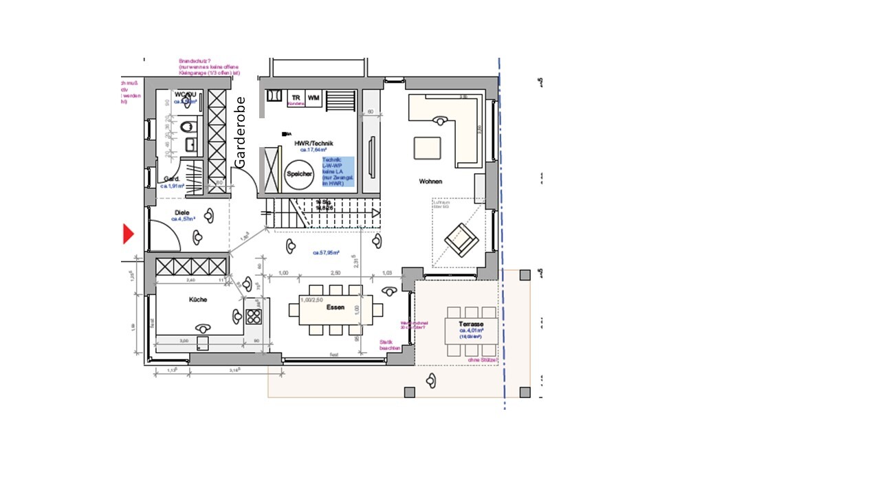

You can skip the door from the carport into the house. The path to the entrance is covered, so you can save money and have more storage space in the utility room. It’s better to install a window in the utility room for airing clothes when needed.
Another suggestion: a dedicated cloakroom. With the current space in the utility room, you wouldn’t be able to use it effectively anyway...

Why are you squeezing the terrace into the east side near the border where a semi-detached house will be built in the future?

You should take a closer look at that. Architects’ estimates usually tend to go down... I haven’t seen it happen the other way around yet. I like the design 🙂 When planning the kitchen, make sure the walkway is around 120cm (47 inches). Otherwise, you might end up blocking the entrance.

What I might do differently: skip the open space (void) and instead have two bathrooms upstairs. Remove the shower on the ground floor and enlarge the cloakroom.
Thank you! I’ll include the second sink. 🙂 I’ll discuss the bathtub with my partner. I don’t see any other way to separate the bathroom from the sleeping area than with a door. Cooking “into the room” is definitely intended, so this is an acceptable solution if an island can’t be realized.
The open space and shower on the ground floor will stay as planned. The cloakroom is only for guests since we will most likely leave things in the utility room.
Alessandro schrieb:
You can skip the door from the carport into the house. The path to the main entrance is covered, so you save money and gain more storage space in the utility room. Better put a window in the utility room for airing laundry, for example.
Another suggestion: a dedicated cloakroom. As the utility room is currently designed, you probably won’t be able to use it properly…
Alessandro schrieb:
Why are you squeezing the terrace onto the east side near the border where a semi-detached house will be built in the future?
Thanks to you as well. We plan to use the utility room as a “mudroom” to keep the entrance area as clean as possible.
You’re right about the terrace. That’s definitely still on our “to change” list. We’re not happy with it yet. Do you have another idea?
