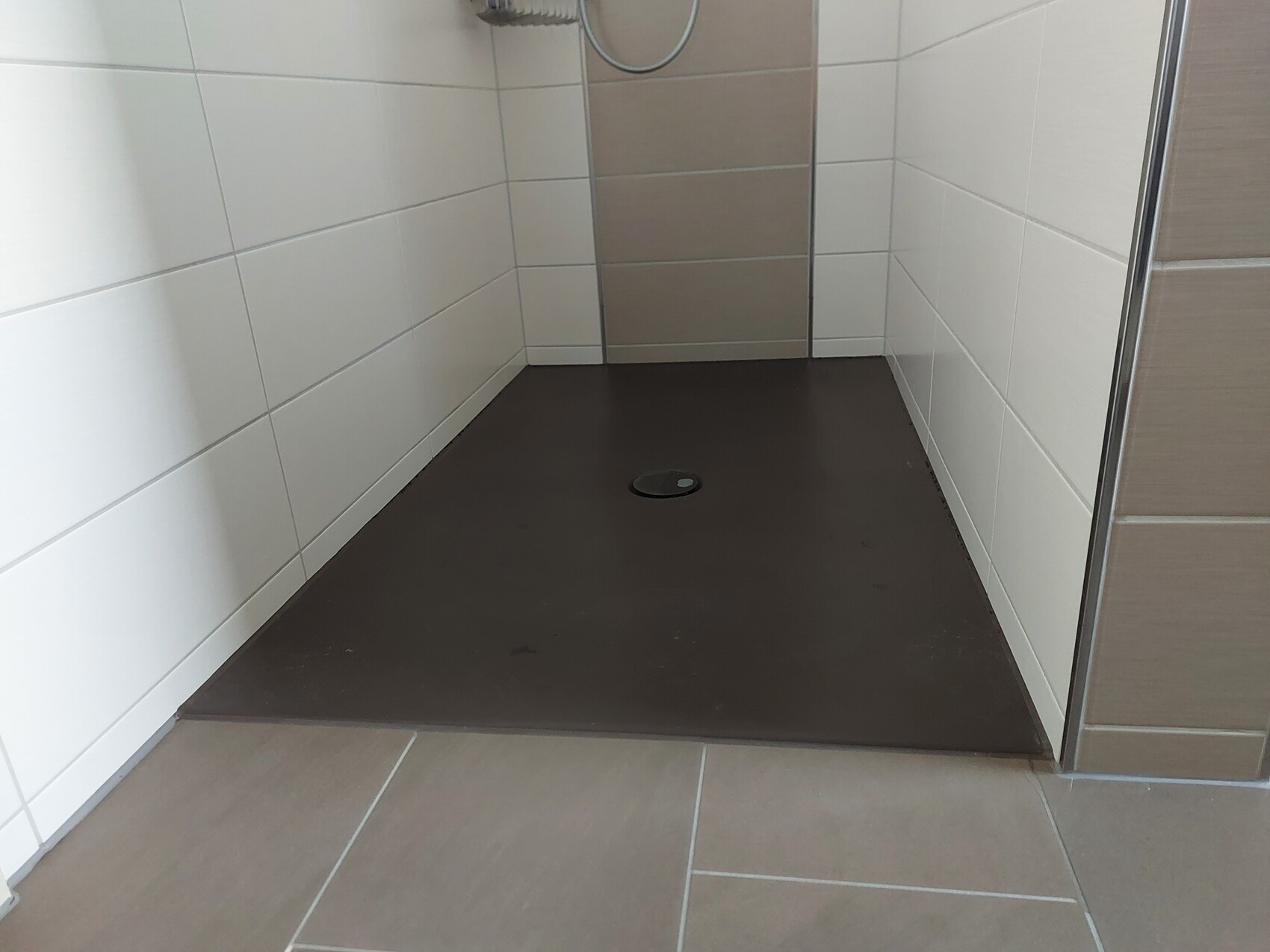

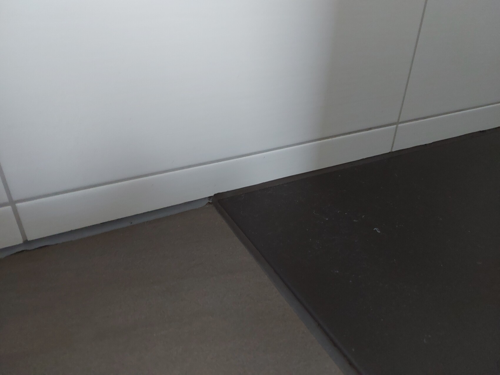

Musketier schrieb:
Here are 2 pictures of the shower tray. That is really helpful, especially the pictures. Thank you very much! It reinforces my belief that it can work without any problems.
Interestingly, these are the joints in my house that have not cracked or come loose yet. In many other areas, I had to renew the joints after a few years due to settlement cracks, and in some cases, they need to be redone again already. I don’t know if it’s because of a different type of silicone, better adhesion to the shower tray, or because the silicone never dries out from shower moisture. Perhaps it’s also because the stress can spread over large areas, as the shower tray only rests more or less loosely on the support.
