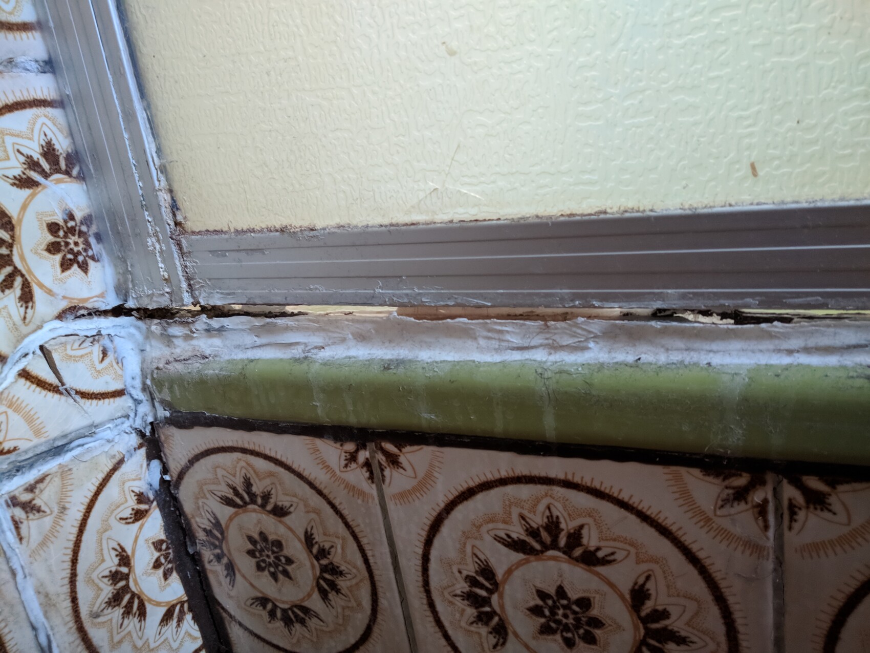

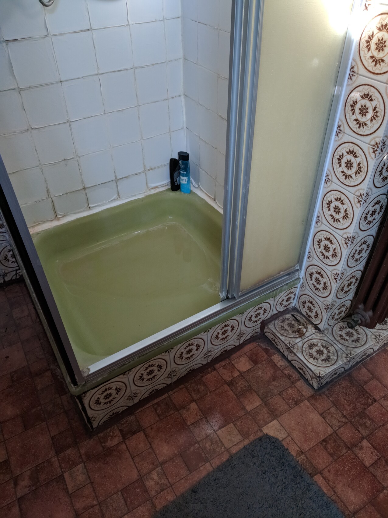

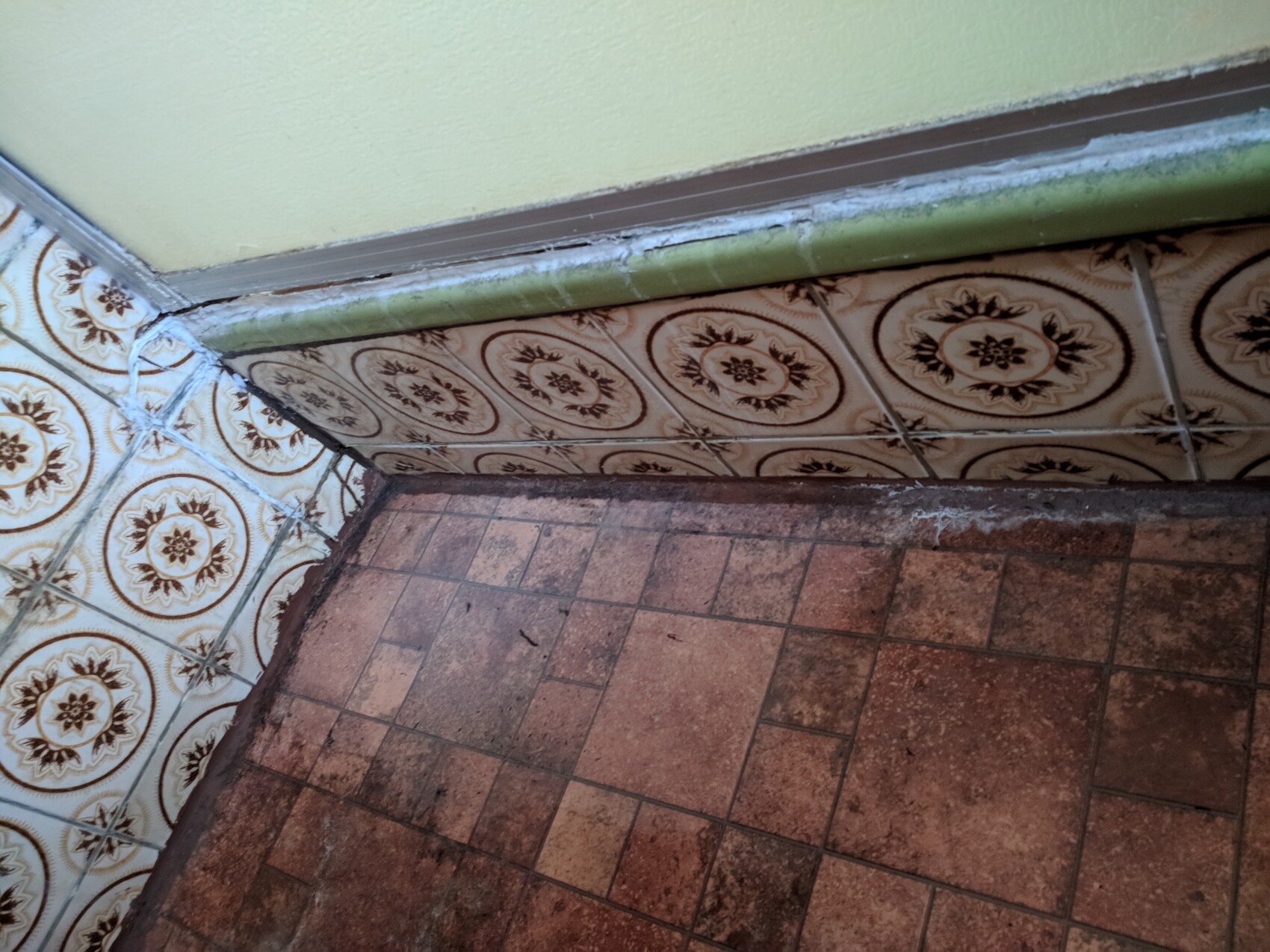

we have a problem with our bathroom, specifically the shower. Some time ago, we noticed that the floor around the shower is sinking.
The bathroom flooring is PVC (or a similar material), and in front of the shower there was a noticeable dip.
Now the entire shower tray has sunk by at least 1cm (0.4 inches). This is clearly visible due to the gap that formed between the shower enclosure (which is firmly attached to the wall) and the shower tray.

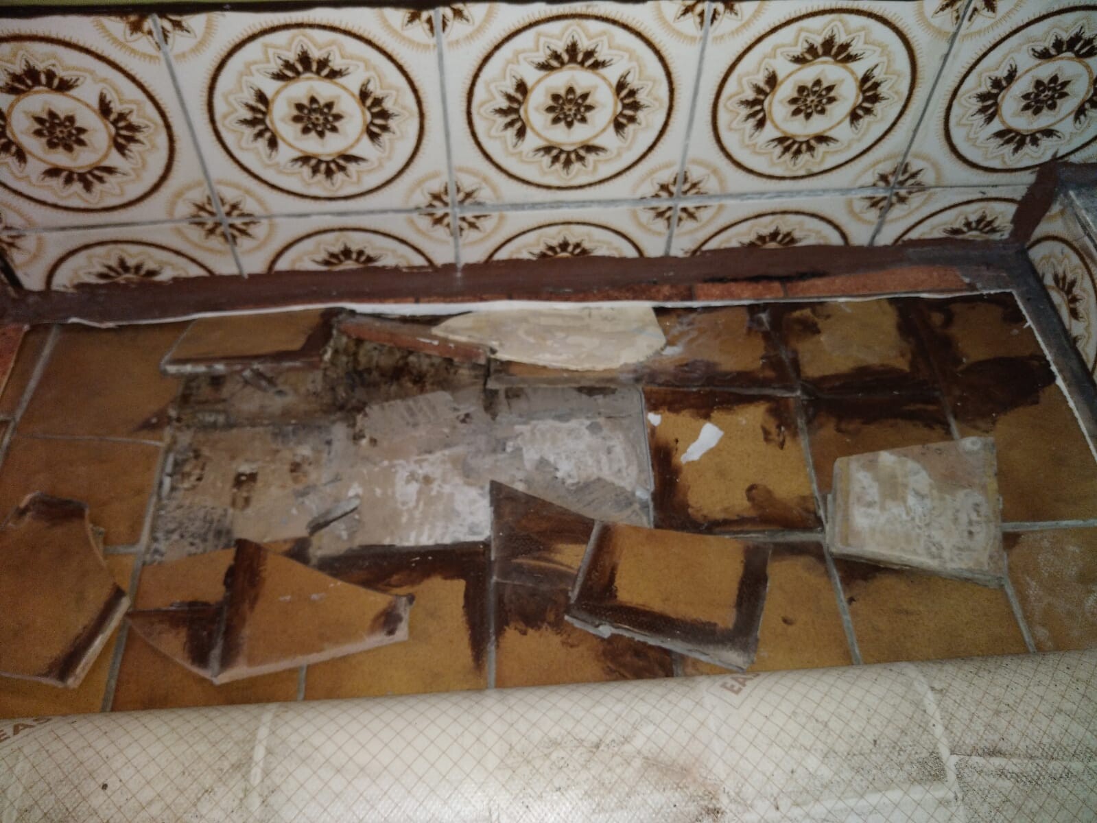

Bruderhertz14 Nov 2018 22:53hemali2003 schrieb:
Cleaning would definitely help... Sorry, but I would never post photos of tiles with 3 mm (0.1 inch) of dirt on them. Just looking at it gives me cold sores! Do you mean the white "wall tiles"? Those aren’t actually tiles, but adhesive foil that is peeling off... It was applied back then to cover up the ugly paint that the previous owner had smeared on the tiles. Of course, it looks really bad now and needs to be redone.
But regarding the issue:

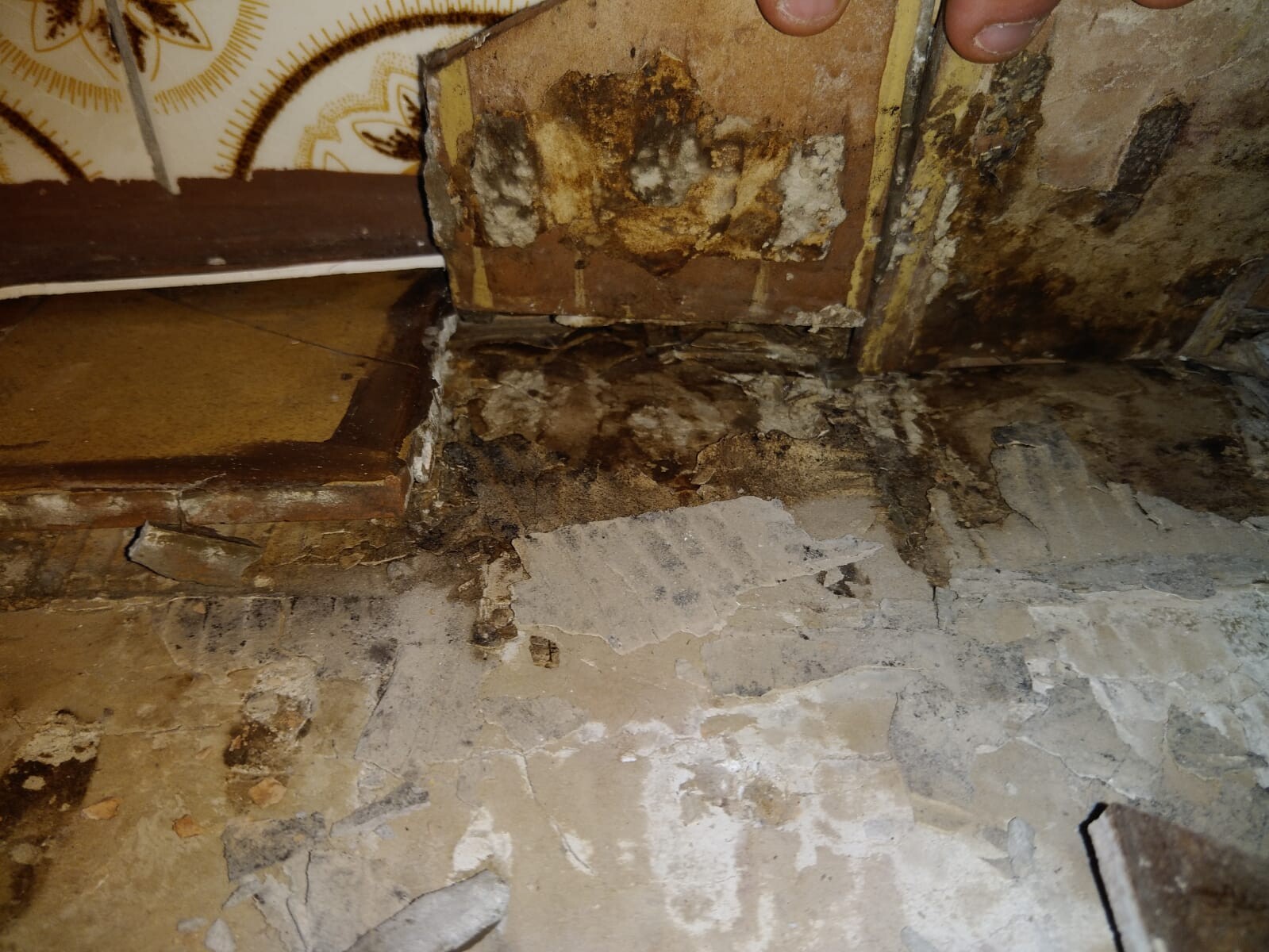

We have removed the PVC covering and the tiles underneath in front of the shower. Unfortunately, no real cause for the floor sinking can be seen.
(see photos)
The building dates from 1905; I don’t know when the attic was converted. Bringing in a structural engineer probably wouldn’t be cheap, which I would prefer to avoid.
My hope is still to simply level the floor with self-leveling compound and retile…

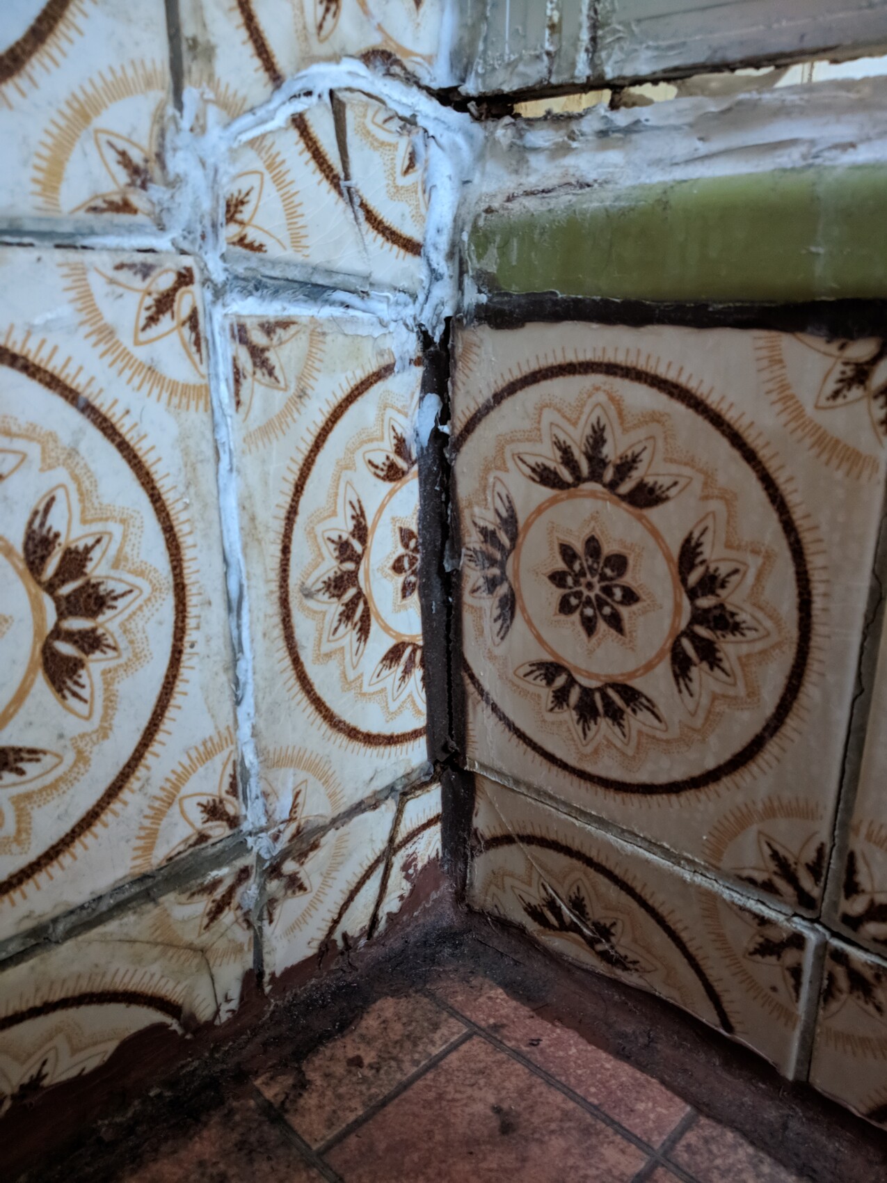

I would bet that the waterproofing (meaning the silicone sealant) around the bathtub has not been effective for quite some time, allowing water to flow under the shower tray. Since the building is from 1905 and the attic is involved, it almost certainly has a wooden beam ceiling, and the beams or their sheathing (floorboards, chipboard, etc.) will have rotted away.
As a result, the shower tray is sinking and will sooner or later end up in the floor below—if you're somewhat “lucky,” there might be a beam running underneath that could hold for a while longer. You won’t be able to avoid consulting a structural engineer, and for the sake of your health, you really shouldn’t try to handle this yourself.
Remove the tile adhesive or screed beneath the tiles that have already been broken up, and you will be able to see more. Alternatively, open the covering of the shower tray so you can look underneath.
