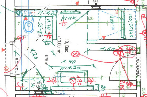

The shower will be mounted on the side wall. Here is a sketch with the planner’s rough notes (which already include the electrical planning). The exact location of the shower outlets has not yet been marked, but verbally we agreed on mounting it on the wall (the upper wall in the drawing, directly to the left of the seating area).
If I subtract 45cm (18 inches) for the seating area, there would still be 115cm (45 inches) of space left to the shower door. I think that is quite comfortable.
Yes, the idea is good, but the wall next to the toilet does not reach the ceiling. Additionally, in the area in front of the shower door, the extra towel radiator is installed. If I were to redesign it as suggested, the wall next to the toilet would have to be significantly higher (if not full height) (-> this would also reduce natural light in the shower), and the radiator would need to be relocated. This would allow me to enlarge the shower space further. However, the downside would be that it would restrict the space directly behind the sink. So, when standing in front of the sink, the shower door would be quite close behind me (about 1 meter (3 feet) or slightly less). This means I would have less freedom of movement in front of the sink. Having only about 1 meter (3 feet) of clearance in front of the sink is not very generous.
