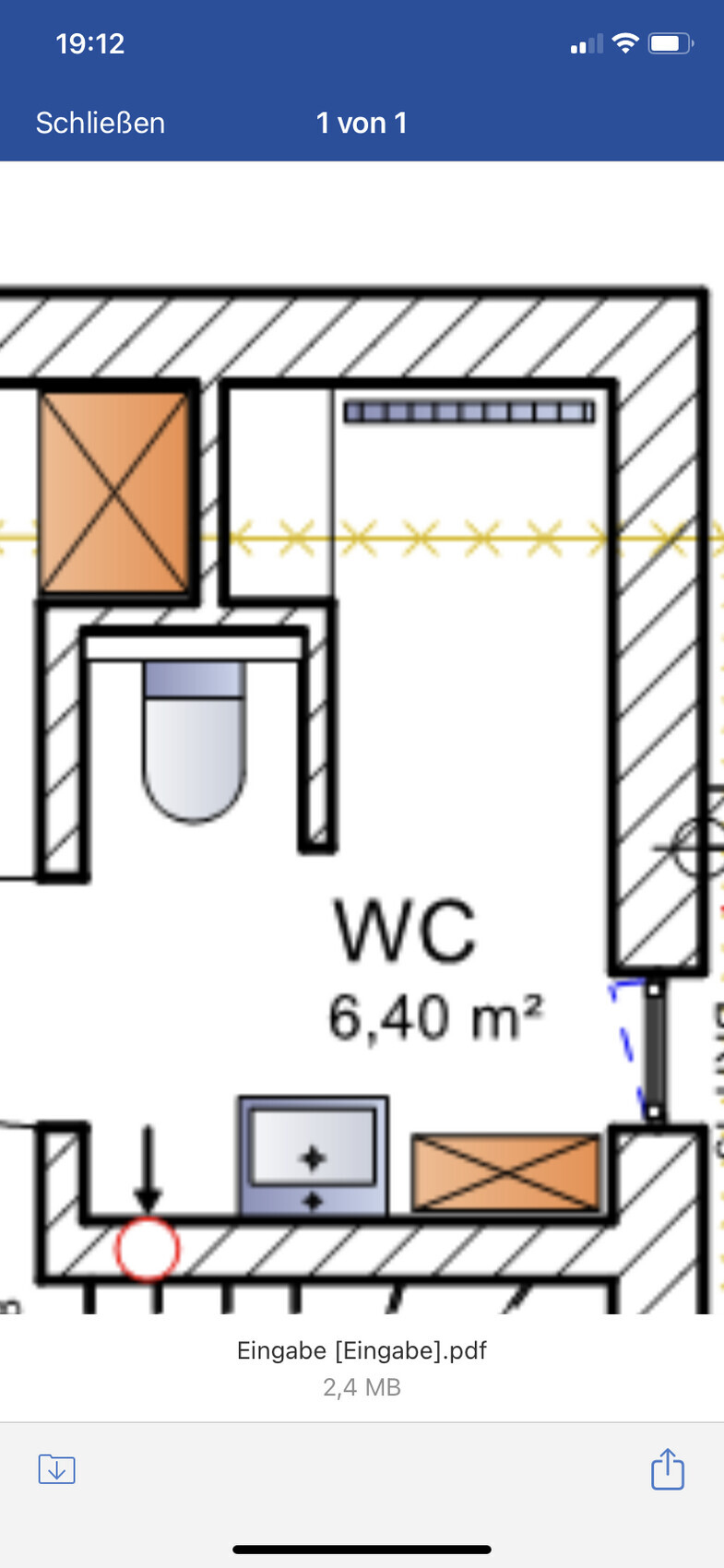

Allthewayup21 Jun 2023 19:22We have planned a seating depth of approximately 45cm (18 inches) and a width of 90cm (35 inches). The partition to the toilet will be remodeled, so the attached plan does not yet reflect the dimensions mentioned above.
The shower is 1.1m (3 ft 7 in) wide and 1.8m (5 ft 11 in) deep overall, so splash water is not an issue, and a walker or wheelchair can be moved further back if needed to avoid getting completely wet. We have decided to use a mineral casting shower tray measuring 1.6 x 1.1m (5 ft 3 in x 3 ft 7 in). It has the advantage of eliminating sealing issues caused by grout joints becoming leaky over time. The material is homogeneously colored (repairs can be made with color-matched synthetic resin if damaged), and the surface of the chosen tray is quite rough (slip-resistant).
