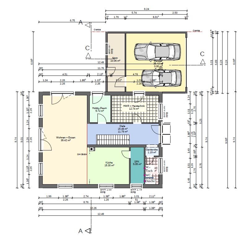

Since we are already on the topic... What do you think about the ground floor?
Layout of a single-family house with garage, living room, and kitchen
