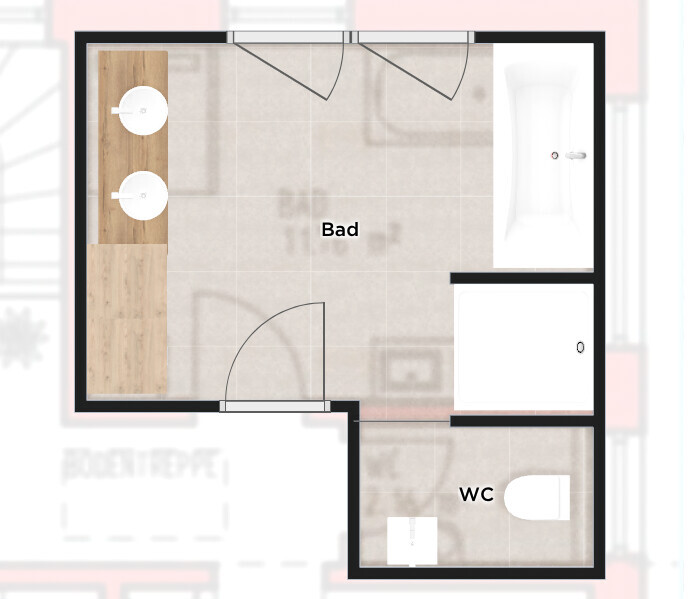

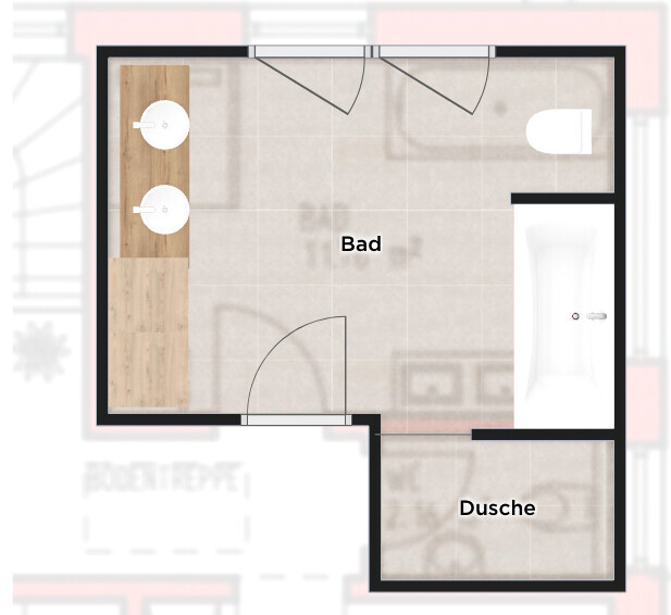

hanghaus20238 Oct 2025 14:06I would approach this differently. Some people may see advantages in having a separate toilet, but since there is very likely one on the ground floor, and this is a house for a family of up to four people, you can do without the separate WC. The benefit then is that you can quickly use the toilet before bathing or showering without having to go through the hallway. Otherwise, the privacy you want to achieve would be lost. Small separate WCs are quite impractical when caring for young children or even yourself.
The door should be positioned so that you can operate the washing machine without having the door hitting your back.
So either like this or like that:
