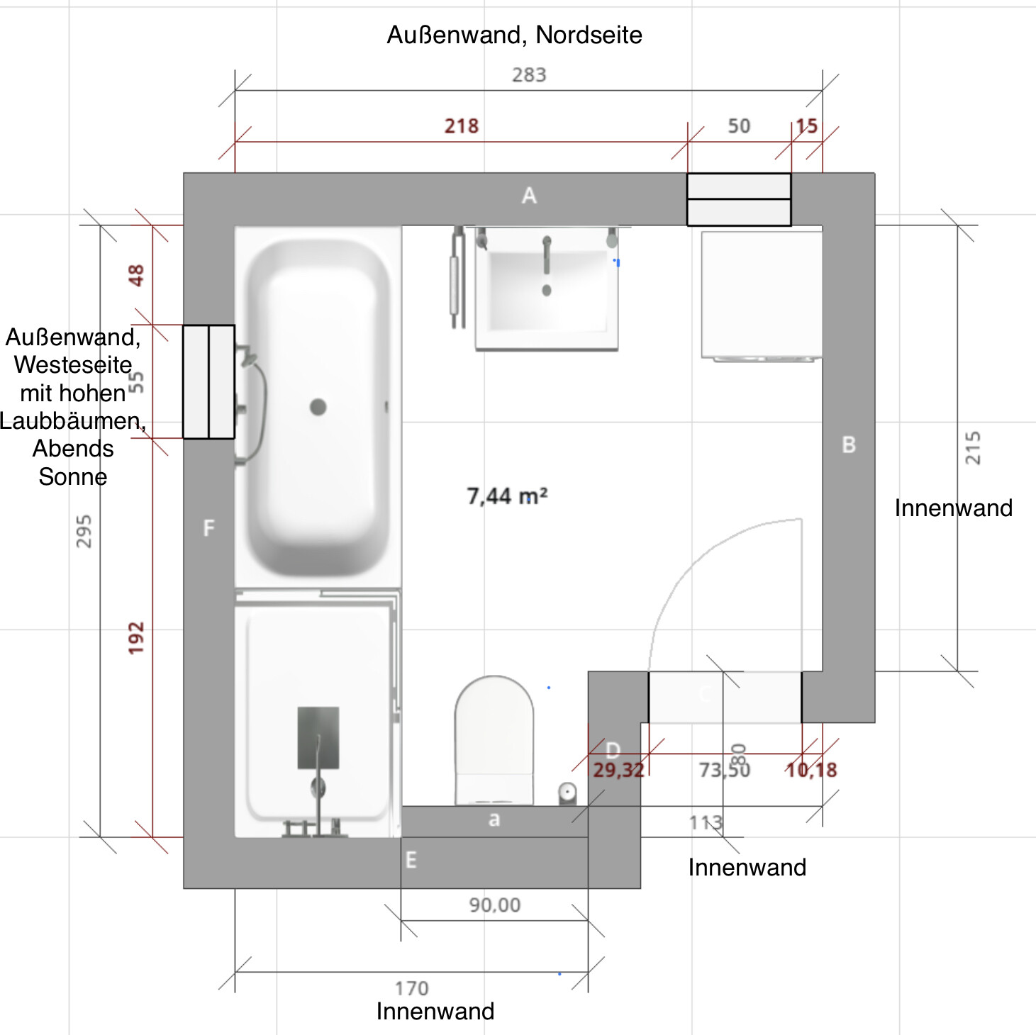

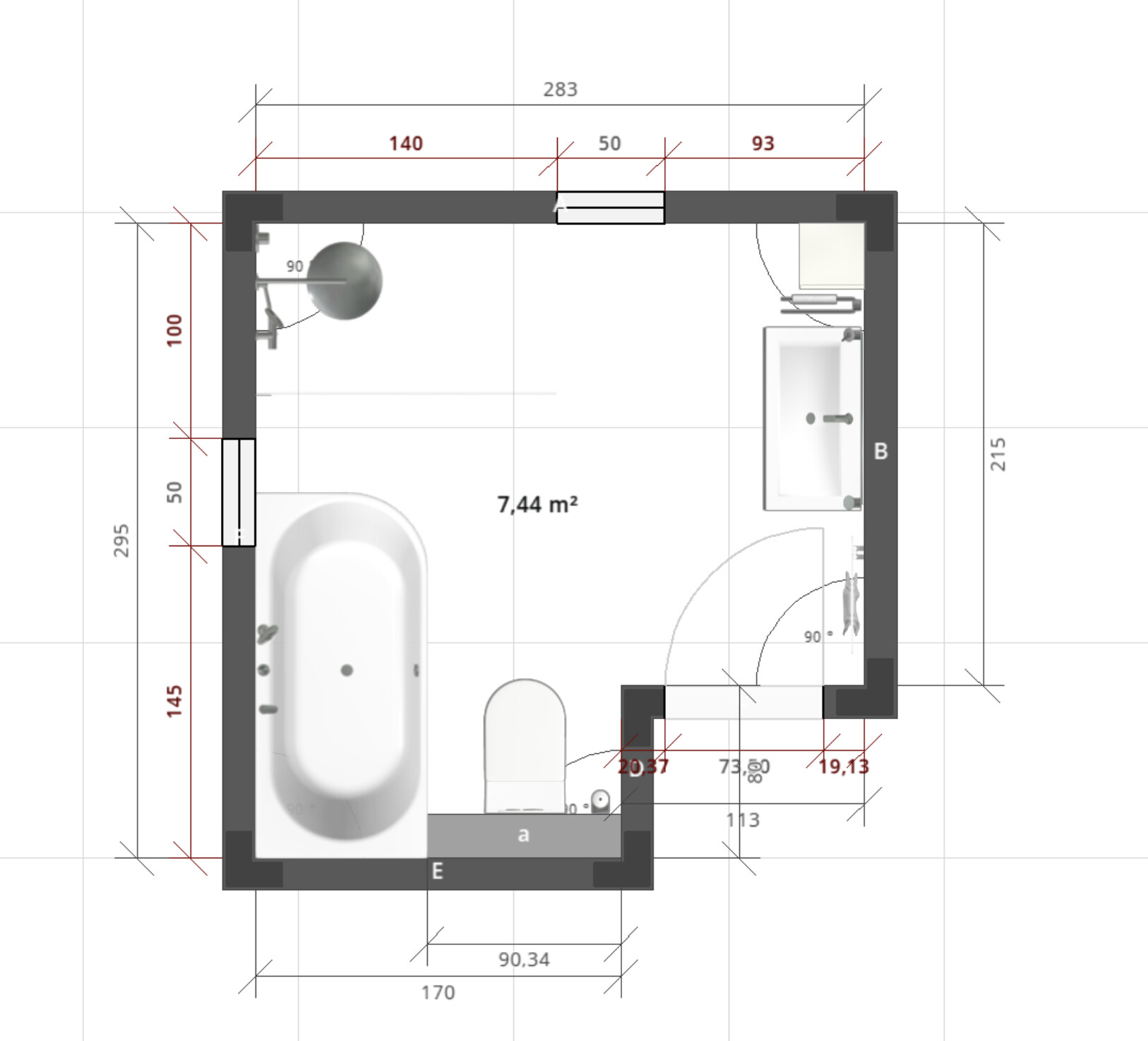

We are currently facing the challenging task of planning our approximately 7.5sqm (80.7 sq ft) bathroom (slightly L-shaped) and arranging the components and windows.
The two windows (one on the west side with large deciduous trees, one on the north side – both about 6m (20 feet) from the sidewalk, since it’s a corner plot) can still be adjusted in size and position, or even removed if necessary. The room dimensions are fixed.
Essential fixtures:
- Bathtub
- Separate shower
- Washbasin/vanity
- Toilet
- Heated towel rail
If possible:
- Space for a washing machine
- Create a sense of spaciousness in this small bathroom
- Avoid placing a wall or shower screen/glass wall directly next to the washbasin, as this may feel cramped (or maybe not?)
- Arrange windows to achieve a good balance between brightness, privacy, aesthetics, and functionality
- Small storage space for towels/cleaning supplies
We are missing experience regarding the position of the washbasin:
- How problematic is it to have the bathroom door behind you when standing at the washbasin? Online, there seem to be relatively few layouts where the washbasin is positioned as a focal point when entering the bathroom. It is usually placed on the wall to the left or right of the door.
We currently have two layout options (one without and one with a washing machine), both of which have some disadvantages.
Option 1:
- Difficult access to the shower
- Uncomfortable use of the washbasin with the door behind your back
Option 2:
- Lack of washing machine (no option in the basement, and due to the open kitchen-living area, loud spinning is only a compromise)
- Window arrangement issues
Do you have any ideas on how to improve the layout or other arrangement options that have proven to be a good compromise between aesthetics and functionality in practice?
We would be very grateful for your help and suggestions!

Schorsch_baut schrieb:
How about this? Bathtub in the alcove, then toilet and washbasin on the left, and shower plus towel radiator on the right? Thanks for your suggestion. In this layout, the shower would be directly in front of the bathroom door. Could that feel a bit artificially cramped?

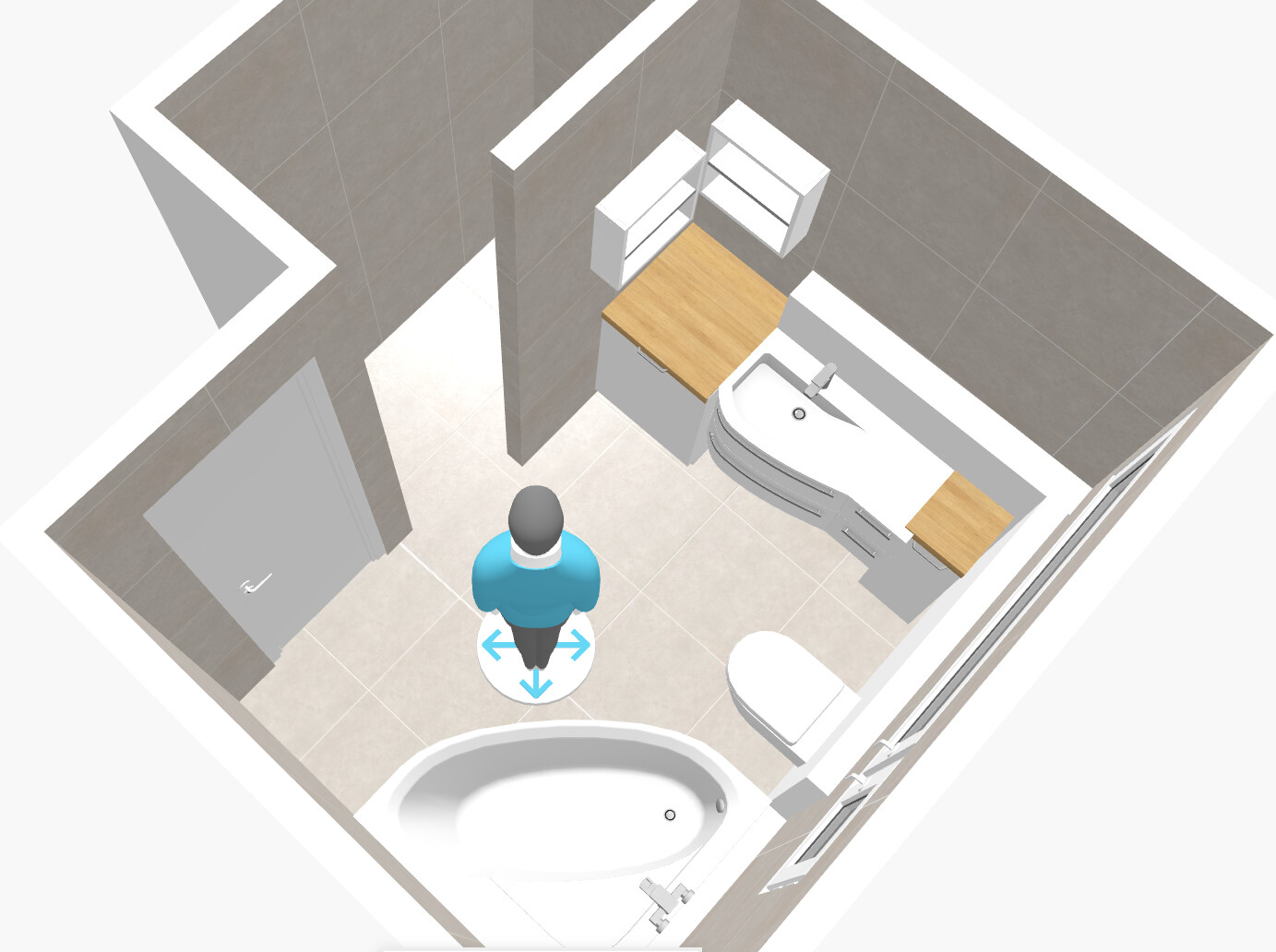

Personally, I would probably opt for a bathtub with a shower. That would make things a lot easier. Also, the 15cm (6 inches) wall projection should not be overlooked when it comes to centimeters.
I’m going for asymmetry at the washbasin, where the washing machine can fit underneath. The countertops are a bit improvised on my part; a carpenter can do it better.
