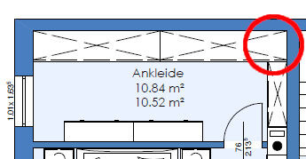

K1300S schrieb:
The corner cabinets in the dressing room cost you about 1 meter (3.3 feet) of usable space, so the second version is indeed larger in floor area but offers hardly any more storage capacity.
Have you planned for air conditioning?What do you mean by corner cabinets? Both versions have a straight layout.
A ventilation system is planned, and additionally, an air conditioning unit is still being considered.
hanse987 schrieb:
I tend to think more practically than design-oriented. How did your planner envision the routing of water supply and wastewater from the bathroom on the upper floor to the utility room?I had actually addressed that as well. Wastewater probably doesn’t need to go into the utility room and will be discharged through downpipes outside, around the house. Otherwise, the layout options are somewhat limited by the site conditions to consistently implement the recommended concept of keeping bathrooms, kitchen, and utility room close to each other.
doubleTT schrieb:
What do you mean by corner cabinets? Both versions are straight-lined. I see it differently:
doubleTT schrieb:
A ventilation system is planned, and additionally, an air conditioning system is being considered. With the window areas, however, I wouldn’t hesitate for long.
