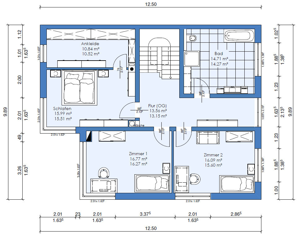

We are planning to build a solid structure house with a general contractor. After several planning rounds, we now have a preliminary floor plan.
The goal was an open layout on the ground floor and a cellar that can be used as living space as effectively as possible.
The house faces southwest with the terrace. The bathroom has not yet been designed.
To the north, the property borders the neighboring house.

Client requirements
- Full basement
- Number of occupants, age: 2 adults, 2 toddlers
- Office: home office
- 1 guest bedroom for extended stays several weeks per year
- open architecture
- modern construction
- open kitchen preferably with an island
- 8 dining seats
- Fireplace
- Garage + carport (located at the edge of the property – entrance to the house only from the sidewalk)
Designer: planner from a construction company
Preferred heating technology:
Air-source heat pump
Why does the design look the way it does now?
For example, which client wishes were implemented by the planner?
What do you think makes it especially good or bad?
Generous open floor plan on the ground floor, flexible room layout
What is the key/basic question about the floor plan in up to 130 characters?
- Kitchen: is there enough space for a kitchen with an island? Is there sufficient storage and workspace?
- Master bedroom: does the master bedroom feel open enough or rather cramped?
- Terrace: what is the best way to plan the roof/covering?
We are happy to receive your ideas and suggestions! 🙂

On the ground floor, the shower for the permanent guest is missing; depending on the guest, I would even consider an en-suite solution.
The dining area seems a bit awkwardly positioned, partly in front of the window. Storage space in the kitchen could be tight without a pantry.
The bathroom on the upper floor is just large, with unnecessary central space; this could be designed more efficiently.
doubleTT
31 Aug 2021 00:36
pagoni2020 schrieb:
On the ground floor, I find the absence of a shower for the long-term guest noticeable; depending on the guest, I would even consider an en-suite solution. The dining area seems a bit awkwardly placed, partly in front of the window. Storage space in the kitchen could be tight without a pantry. The bathroom upstairs is large but has wasted central space; it could be designed more efficiently.
The guest room on the ground floor will more likely be used as a study, and the bedroom in the basement will serve as the guest room for an actual regular family guest. That is why there is no shower on the ground floor but a bathroom planned in the basement.
The bathroom upstairs has not yet been planned in detail. Unfortunately, we haven’t gotten that far yet.
In the kitchen, the seating area at the cooking island will be removed in favor of additional storage. A pantry is planned in the basement.
doubleTT
31 Aug 2021 00:38
Upper floor plan: Bedroom, walk-in closet, bathroom, hallway, room 1, room 2
In my original post, I was still considering the bedroom with the walk-in closet. Now I have received an alternative solution where the walk-in closet is slightly larger and includes a daylight window, and the L-shaped layout of the bedroom is replaced by a rectangular room shape.
