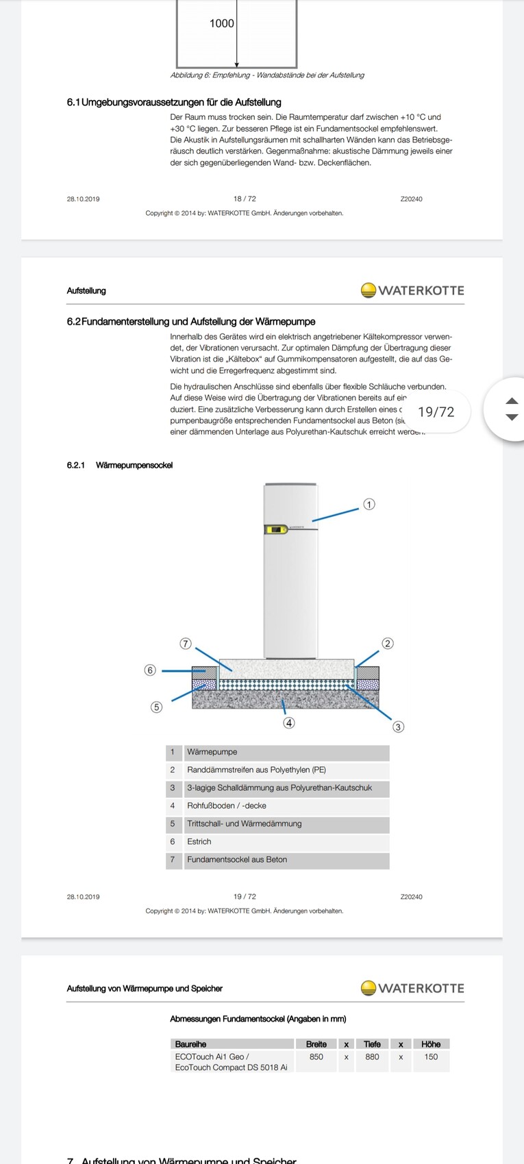

The small 4 feet of the ground source heat pump rest directly on the floor tiles.
tomtom7926 Sep 2020 13:51
In our case, they rest on concrete slabs the size of the heat pump, with rubber pads placed between the slabs.
This is where you should start; the screed is also decoupled from the slabs.
Mycraft26 Sep 2020 15:53
What type of heat pump is it?
tomtom7926 Sep 2020 17:54
Take a look at the recommended base detail.
Cross-section of a heat pump base with insulation, screed, and concrete foundation.
