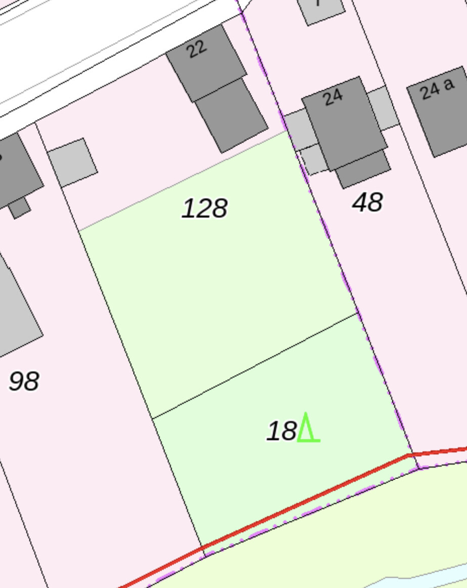

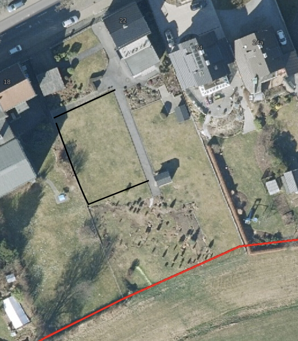

For better assessment, I have attached the Boris maps.
Parcels 128 and 18 both belong to the seller. We would consider the part outlined in black, which would probably be around 500 square meters (5,382 square feet)... to the south is garden land, and beyond that a nature reserve. This protection from development and the meadow and forest situation at the rear make it quite attractive.
The building is, of course, not specifically planned yet, but the options for the footprint range from 9.8 x 10 meters (32 x 33 feet) to 10 x 11 meters (33 x 36 feet)... so not a huge mansion, the plot width is about 18 meters (59 feet).

Besides that, on the aerial photos, we also noticed the manhole cover to the left of the lower part of the seller’s building.

According to the city, the connection point is right in the middle under the street, and when I mentioned the manhole cover, I was referring to a potential connection to the neighbor’s wastewater pipe…
