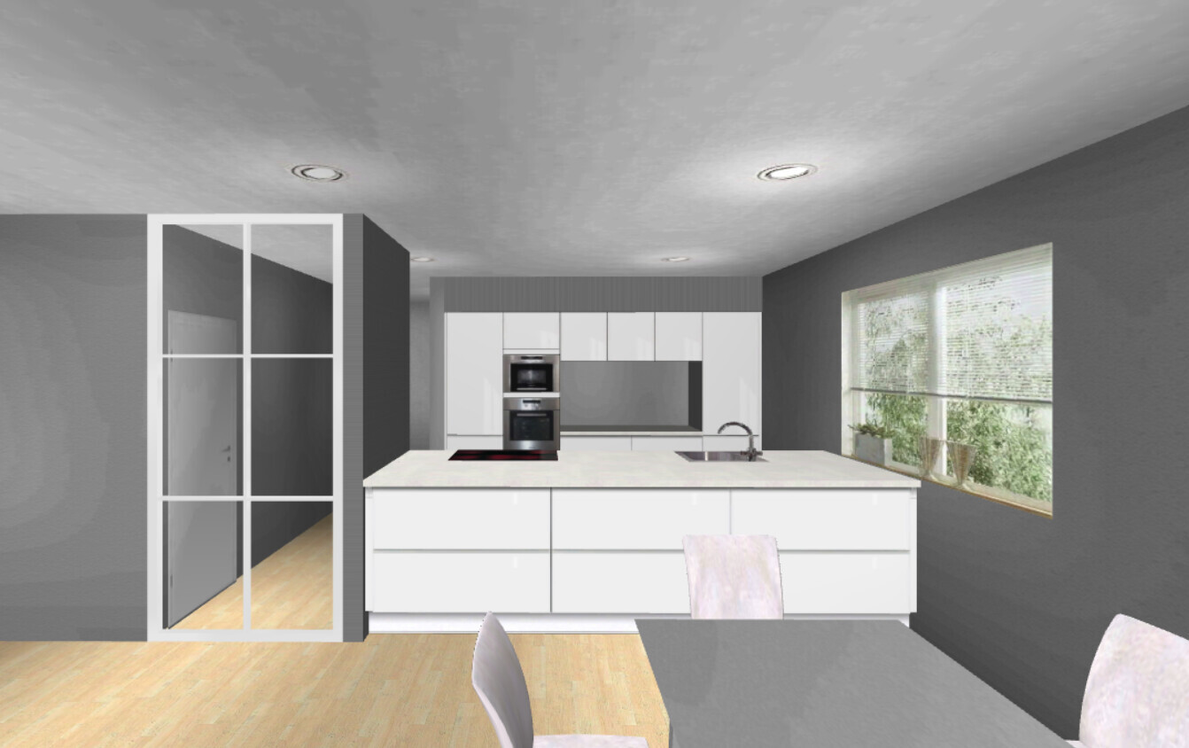

The kitchen won’t work as drawn in the plan. The room is 720cm (283 inches) long. Assuming a table is 180cm (71 inches) long. You need 100cm (39 inches) clearance around the table edge to the wall or furniture, so 380cm (150 inches) of the 720cm (283 inches) are already taken. That leaves 340cm (134 inches). The kitchen would end roughly under the kitchen window if made as long as possible. An island with a bar isn’t feasible at all.
What would fit very well, if the stairs are moved to the other side as already suggested. Then you would get a very large, practical kitchen with plenty of storage. I just roughly put it together.
[ATTACH alt="hausverliebt1.PNG"]66246[/ATTACH]
At the bottom of the plan, a niche for storage. What I don’t like is the window position and the less appealing view on the left side of the plan. I would plan the window to match the island. Distance between the rows should be 120–130cm (47–51 inches).
The dishwasher could be installed elevated at the bottom of the plan, and the distance between cooktop and sink would then be about 120cm (47 inches).
I might have the kitchen and stairs end at the same level, meaning the utility room might be slightly lower. The door from the utility room to the carport should definitely be kept.
I really like the open space in the entrance. Chrisw81 would be happy if his “suburban house” had this small wow factor. Just to explain, he finds his house boring. Thank you very much for the detailed response and your alternative suggestion. We would like to take advantage of the increased storage space in the kitchen, but we want a separation between the entrance area and the kitchen/living-dining area. If I understand correctly, in your proposal the hallway on the ground floor would lead directly into the kitchen? If so, is there a solution for that?
