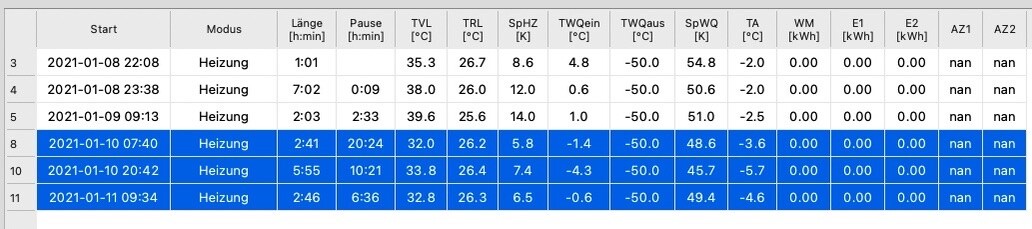

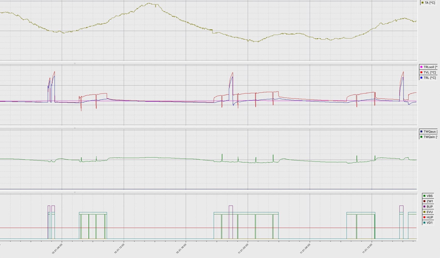

I would definitely turn that off; it doesn’t make sense in an occupied single-family house.Ok, I will do that.The differential in standby mode is widening again. The 3 highlighted lines in the screenshot represent the last 3 complete heating cycles in the graph. The current heating cycle is ongoing, with the return temperature at 23°C (73°F) and the supply temperature at 32.8°C (91°F).
So, the differential is increasing again and seems to be fluctuating, right?
I reset the pump optimization to "no" and set it to 180 minutes. Maybe my heat pump doesn’t respond well to that setting.
If the differential doesn’t improve after this, then I have no idea what else it could be, since the flow rate is currently at 1440 liters/hour (380 gallons/hour) and should actually be adequate, right?

Daniel-Sp11 Jan 2021 16:56Yes, then let's try it without pump optimization first.
I basically reset everything to the point when I had a 0.2°C (0.36°F) temperature difference in standby mode. That means,
- Total flow rate back to 1380 liters per hour (l/h)
- Pump efficiency nominal and minimum both back to 10.00 volts (V)
- Pump optimization set to no and 180 minutes.
Let’s see, one thing is clear: if the temperature difference in standby mode is already poor, it will be the same during heating operation.
