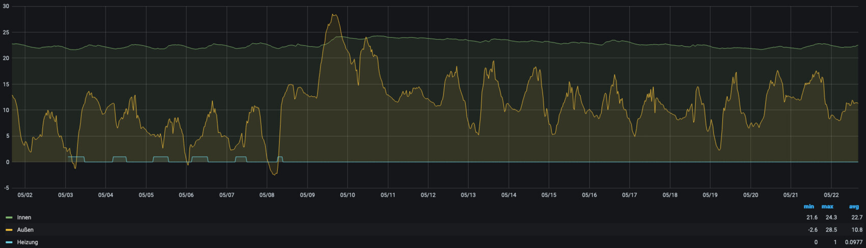

The underfloor heating was used for the last time on May 8th. HDD was 0.5.
Current annual consumption is 3200 kWh of heat including hot water.
Temperature trend: Indoor ~22–23°C (green); Outdoor up to ~28°C (yellow); Heating mostly 0 (cyan).
