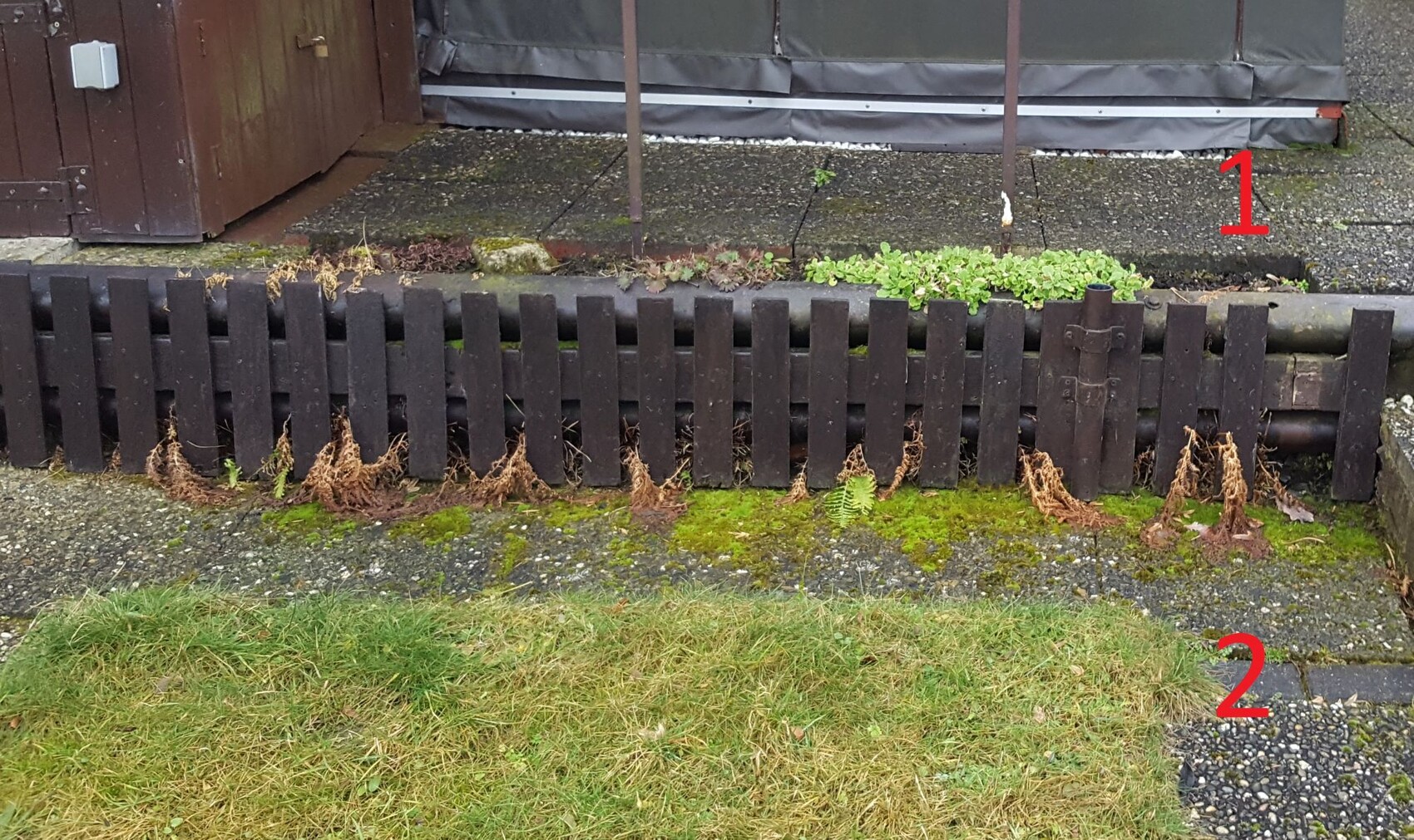

Yes, my plan is roughly like that. I have attached a picture showing the current status. Area 1 is the existing surface, and area 2 is the extension, which I want to raise to the same level as area 1. For this, I plan to use concrete paving slabs to build the platform to reach the required height.
What would happen if I do not place the 10 blocks individually and mix them with mortar, but instead build them offset with mortar, creating one complete block?
Unfortunately, I don’t have much room to maneuver, so your option with the extension is not feasible.
Or would it perhaps be better to build a wooden platform for area 2 and then install a WPC deck on top?
