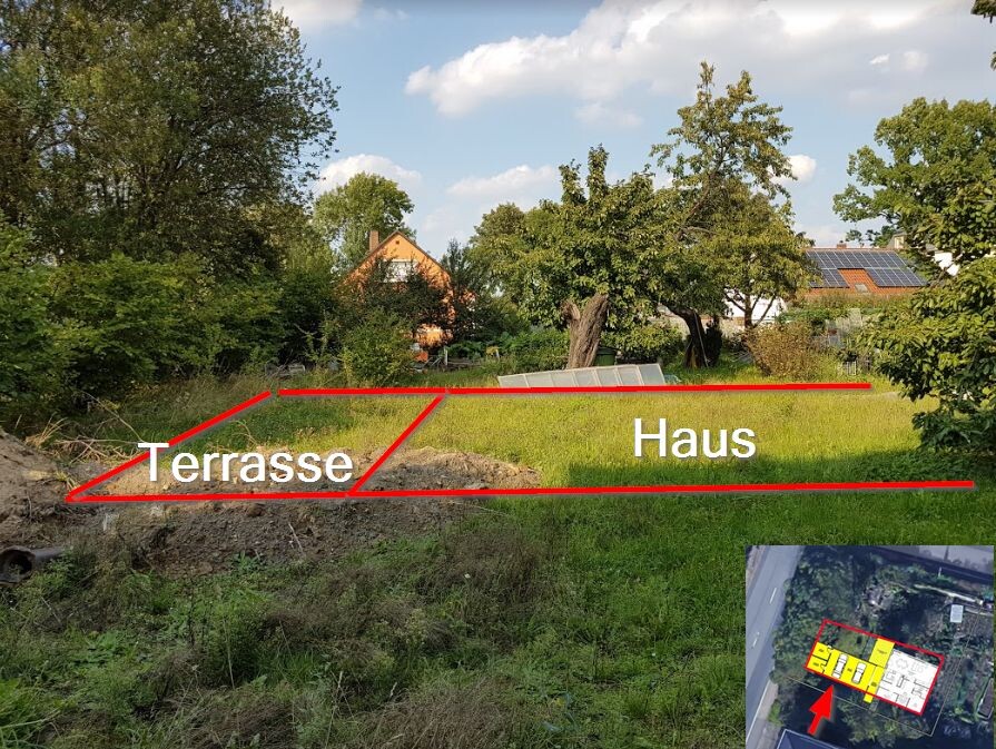

Changeling28 Aug 2017 08:37Sigh... We have to go back to the drawing board. Yesterday, we measured the plot again in detail – on the left (west) side of the property, about 4-5 meters (13-16 feet) are unusable because it slopes steeply down toward the street. So, if we want a double carport on the east side (at least 6-7 meters / 20-23 feet), some space between the house and carport (1-2 meters / 3-6 feet), the house itself (10 meters / 33 feet), and then a terrace (4-5 meters / 13-16 feet), we’re talking about 21-24 meters (69-79 feet) out of 26 meters (85 feet) of “usable” width. And this means, after inspecting the site in person:
You would be sitting on the terrace in complete shade from the trees from midday onward, almost directly facing the street. I took a few photos I can share if anyone is interested.
That just won’t work, plus the house would end up mostly in the western half of the usable area, casting its shadow over the entire space behind the house and carport, which in this position would cover more than half of the garden. It’s not a pleasant prospect.
So we will have to put the carport on the west side after all (we have to/want to). We are currently working on a new floor plan and exploring whether we can move the carport closer to the southern boundary. That would give us more space and sunlight on the terrace and inside the house. We’ll see.
Changeling28 Aug 2017 08:56I had roughly sketched this out before, but without any measurements (and oriented to the north):
The plot measures almost exactly 30 x 30 meters (about 98 x 98 feet), although as mentioned, the left 4–5 meters (13–16 feet) are not usable (the trees are also located there).
I will upload some photos tonight and revise the sketch of the building envelope if it is still too imprecise.

Changeling28 Aug 2017 11:19I will try to create a sketch this evening or expand the existing sketch from the construction company.
Here are some photos that might help illustrate the challenge. I have added a small overview of the viewing angles to make it clearer what is shown. It is about 4:30 PM.
View from the southwest corner facing north, showing the slope. The road is planned to be built on the right and will initially go steeply uphill.
View on the west side of the property looking north. If the carport were on the east side, it would look like this:
There would not be much garden left, mainly on the north and east sides. The trees on the left are quite tall; they probably need to be trimmed anyway (they are willows).
For completeness, here is the view south towards the old building, which partly contains apartments and partly is still under construction:
If the carport were on the east side, the house would only extend up to the dirt mound (see previous photo, I am standing on the theoretical terrace).
If the carport were on the west side, the house would end at the tree on the left, roughly flush with the projecting edge of the old building.
