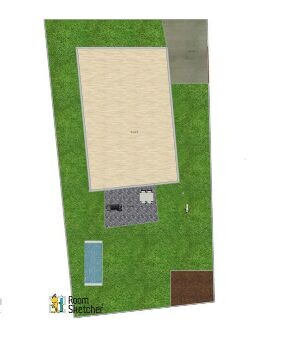

Josilicious9 Aug 2016 08:04Please don’t laugh. This was my very first attempt. I know the picture doesn’t show an angled bungalow, but this is how we imagined the layout. The terrace is supposed to be located at the angle.
At the front, we want to keep only the 3m (10 feet) setback to minimize unused space.
The floor area ratio is 0.3, which equals 164.1. So, it would be allowed.
