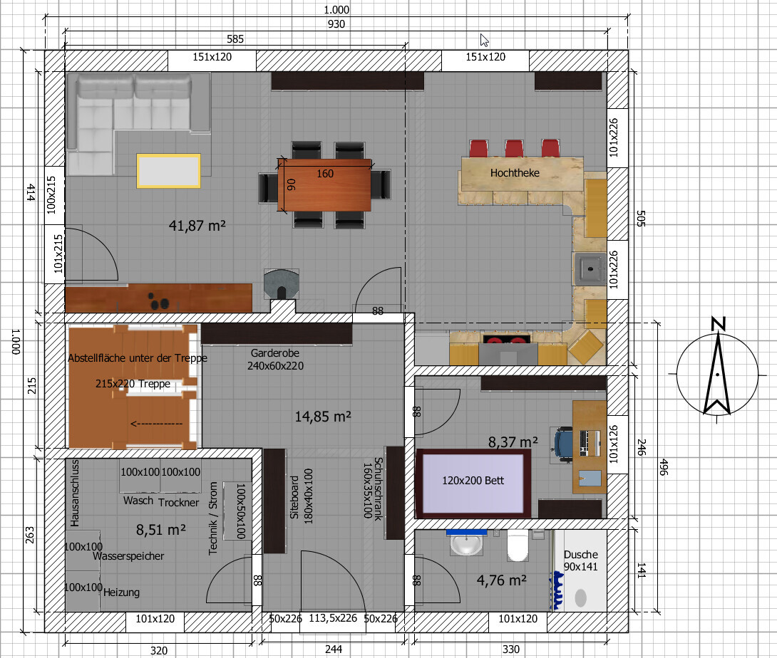

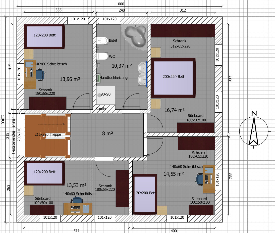

Invi8521 Aug 2017 15:01
I just played around a bit with the rooms and tried to fit everything together somehow. Since I’m not an expert, it might all be useless…
However, it’s still not the ideal orientation to fully take advantage of the sun, but the carport wouldn’t need to be planned elsewhere.
- Instead of the raised counter near the kitchen, you could also make space on the wall for a desk (home office in the living room).
- The hallway gets sunlight and feels brighter thanks to the fixed large window element on the upper floor. (If the staircase is designed as open)
- There is space for wardrobes in the hallway, and shoes, stroller, etc. can be stored under the staircase. (If the staircase is designed as open)
No idea if any of this is helpful for you or maybe opens up new possibilities for your own planning.

PS: With an extra meter (10 x 11 m (33 x 36 ft)), everything would probably work better, and it would be easier to make use of the sun’s path.

Invi85 schrieb:
However, this is still not the correct orientation if you want to fully take advantage of the sun, although you wouldn’t need to plan the carport somewhere else.
Somehow I don’t understand this – hasn’t this improved at all?!

Invi85 schrieb:
I just played around a bit with the rooms and tried to fit everything together somehow. But since I’m not an expert, it might all be useless...
I’m also just a self-proclaimed observer among more skilled self-proclaimed architects here, but I still have the following opinion: Unless there is a structural impossibility or costly difficulty, this version is better.
My note: The hallway now has a truly generous width to incorporate the glass elements at the entrance.
At the explicit request of the original poster, items like shoes should be stored under the spacious canopy construction that connects the entrance with the carport located to the west.
That’s why I’m asking whether it might be possible to save some space in the hallway and use it elsewhere.
