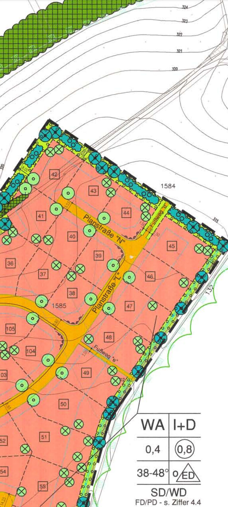

I’m attaching an overview plan; north is at the top of the plan, and our plot is Plan Street L No. 48. The requirements of the development plan, as mentioned, are not interpreted this way. Recently, a two-story house with a different roof pitch was approved without any problems.
Overview plan of a building area with yellow streets, pink parcels, trees, and contour lines.
