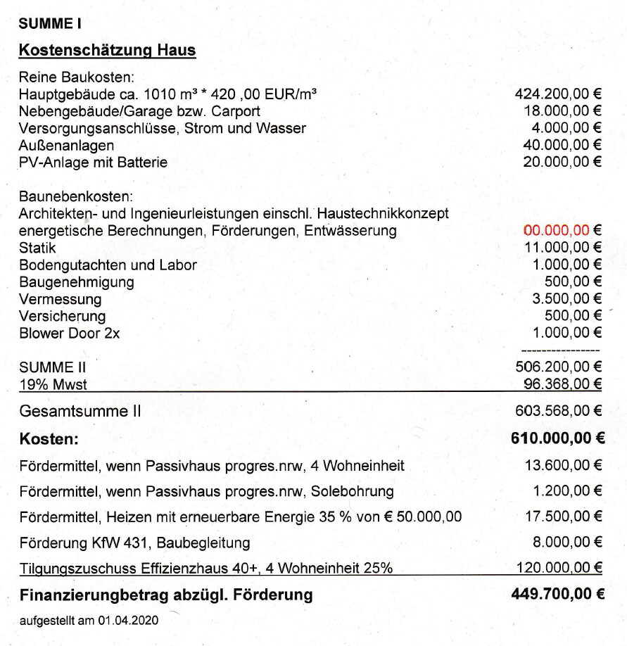

knalltüte
2 Apr 2020 18:00
Hello, may I join the discussion? The topic fits perfectly...
After a long, informative Webex session today, the architect shared his ideas regarding the wall, roof, and ceiling structures, among other things, and provided a cost estimate. I am attaching both the estimate and his draft contract here. The architect is a certified engineer, architect, and energy consultant, and so far we are very impressed with him. His costs also seem reasonable to me.
Nevertheless, I would like to have an independent third-party review. I want to make sure nothing important or consequential is overlooked.
The only point that seems extremely high to me is the structural engineering fee, but this work might be handled by the construction company anyway.
Vertragsentwurf zum Neubau eines Passivhauses (Effizienzhaus 40+) mit HOAI und Leistungsübersicht
Kostenschätzung Haus: Bau- und Nebenkostenliste mit Summe II und Gesamtsumme 603.568 €
