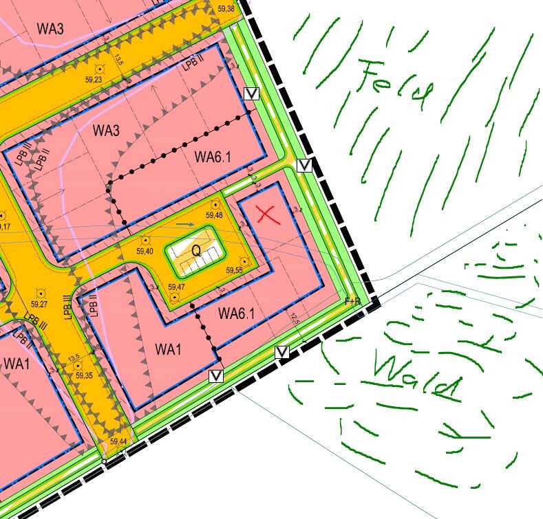

In the next few days, we’re going to meet with the architect to discuss the next steps in our plan. We have prepared by reviewing the current design room by room and noting down what we like and dislike, so that we have a solid basis for the discussion.
In the meantime, we have looked at many other floor plans and visited several building developments in the area. One thing we often notice: there are no straight-run stairs with landings. It’s either spiral or straight flights everywhere.
Another topic that keeps coming up for us is the entrance location. Most floor plans place the entrance on the eaves side, which has the advantage of entering the house through the center. However, for us, this would mean having the entrance on the side. We much prefer having the entrance on the front gable side because it looks better and avoids having to walk past the car along the driveway to reach the front door.
Does anyone have any thoughts on this? 🙂

Varrader schrieb:
What we often notice: Platform stairs are nowhere to be found. Everywhere you see spiral or straight stairs.
That doesn’t really mean much other than spiral stairs save space and are therefore probably more common. Straight stairs are often a personal preference of some homeowners and are implemented at all costs.
Varrader schrieb:
And one topic that keeps coming up: Most floor plans have the entrance on the eaves side, which has the advantage of entering the house in the middle. For us, however, this would mean an entrance on the side. We like the front entrance (ridge side) much better visually, so you don’t have to walk alongside the car along the driveway to get to the front door.
Does anyone have an opinion on this? 🙂
Yes. I think it clearly depends.
Basically, I would always prioritize the entrance according to the best overall floor plan. If a side entrance suits the layout of the other rooms better, then that’s where it should go. Sometimes site conditions also play a role and force the entrance to a certain location. The more money you spend and the bigger the house is, the more appearance and presentation matter. This is not about showing off – I just expect that from a certain budget upward. For a true city villa, a central entrance is definitely a criterion – if that’s what you like.
For the average homeowner, I would always recommend creating the floor plan first and then adapting the entrance accordingly. If the entrance has always been part of your dream house, then mention it to the architect.
In the end, the question is always: What is it worth to you?

Varrader
25 Oct 2022 14:56
Well, it’s like with car color—some people say, "I don’t care, I sit inside and don’t see it anyway," while others think it’s important...
We agree in terms of appearance that we prefer the entrance at the front, since you can create a small, attractive path with a front garden leading to the door. An entrance on the side, especially if it’s under a carport roof, tends to look like a service or delivery entrance.
Attached is a north-oriented overview where you can see a bit more of the surroundings, which I think helps to better understand the overall situation (I don’t believe I posted this before?).
