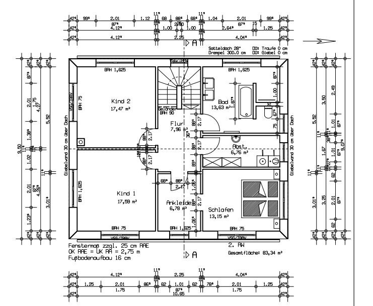

We are currently in the schematic design phase with our architect and now have a design draft that largely meets our requirements and that we like. I would be interested to know if you see any potential for optimization or if there are details/distances that seem completely unrealistic or impractical.

Thank you very much for all the valuable input. Attached are the drawings again in higher resolution, along with a section of the cadastral map and our thoughts on your comments. Note: We have purchased both plots number 11 and 13, which have been merged.

- Dressing Room/Bedroom
- I think moving the wall to widen the dressing room is a good idea. In general, there was the question whether the 50 cm (20 inches) on either side of the bed (2 m (6 ft 7 in) wide) would be too tight.

- Utility Room Upstairs
- It is intended to be used as a storage and laundry room. The planner has included a sink, which we don’t need. This room should accommodate the washing machine and possibly a drying rack.
I have another question as well. Do you see the possibility of fitting a staircase with a landing if the stairwell is given a bit more space towards the east (clear ceiling height 279cm (9 feet 2 inches))? Perhaps the wall between the kitchen and the utility room, as well as the small wall between the staircase and the kitchen, could be moved slightly eastward.
Myrna_Loy17 Mar 2022 08:58holm667 schrieb:
- Utility room on the upper floor
- It is intended to be used as a storage and laundry room. The planner included a sink, but we would not need it. This room should have space for a washing machine and possibly a drying rack in the future.
So basically a storage closet. I would rather divide this narrow space between a wall-to-wall closet in the bathroom, a slightly wider bedroom, and a closet accessible from the hallway. To do this, reduce the bedroom size and incorporate the dressing area space. holm667 schrieb:
I have another question. Do you see any chance of creating a landing staircase if the stairwell is given a bit more space towards the east (clear ceiling height 279cm (9 ft 2 in))? Perhaps the wall between the kitchen and utility room, as well as the small wall between the stairs and kitchen, could be shifted slightly eastward. No, that’s not possible. The problem is the door to the bathroom on the upper floor.

No, that won’t work. The problem is the door to the bathroom on the upper floor. What if the storage room was omitted as suggested?
K a t j a schrieb:
That would be a mess. It doesn’t fit upstairs either and breaks up everything downstairs. If it’s that important to you, then a bay window for the staircase would probably be the easiest solution. Of course, it costs. Or you would have to completely redesign.
If you own both plots, why is the house positioned like that? The average builder prefers a west-facing terrace – east-facing terraces are less popular. It was just an idea. I don’t have a clear sense yet of how far a landing staircase would extend into the living area. If the utility room upstairs were removed and the bedroom and bathroom enlarged, it might be possible to move the door. The half-turn staircase is fine for us. A landing staircase would simply be easier to walk on. We don’t want a bay window outside for cost and aesthetic reasons.
