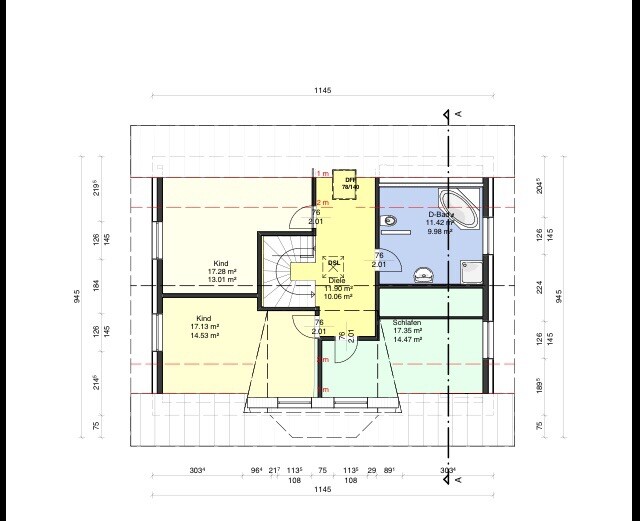

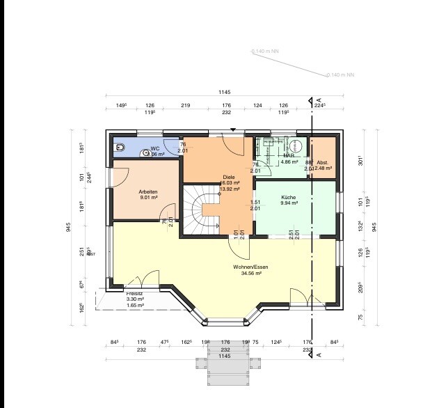

Our architect has presented the first concept of our single-family house based on our suggestions.
Living area according to DIN 163 m² (1755 sq ft)
House dimensions 11.45 x 9.45 m (38 x 31 ft)
Please share your opinions or any improvements and ideas....

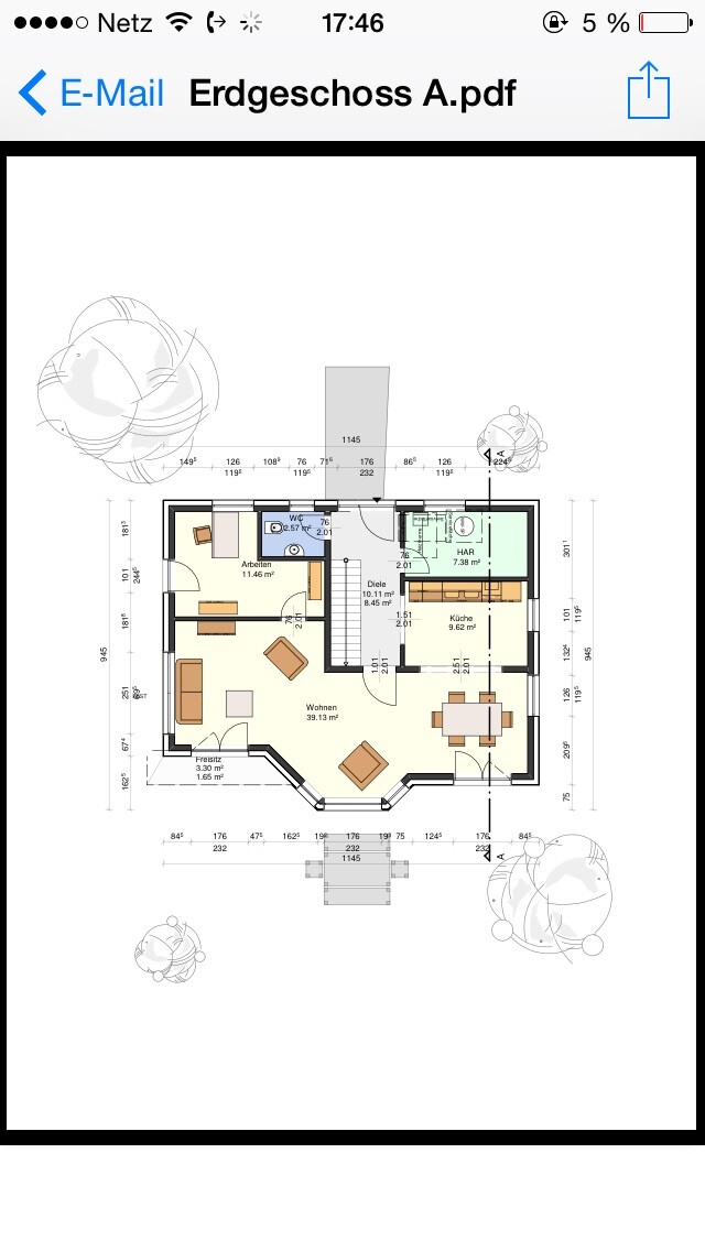

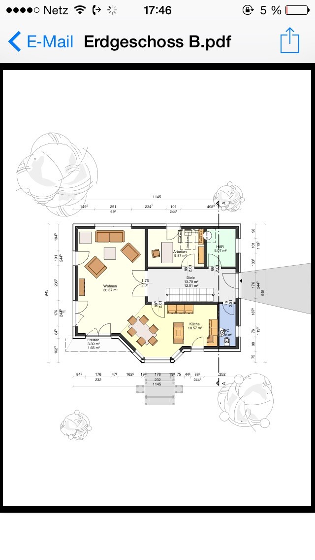

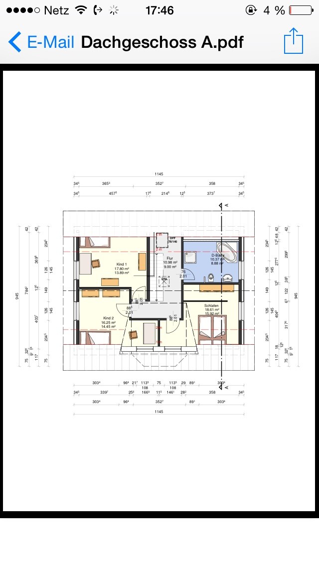

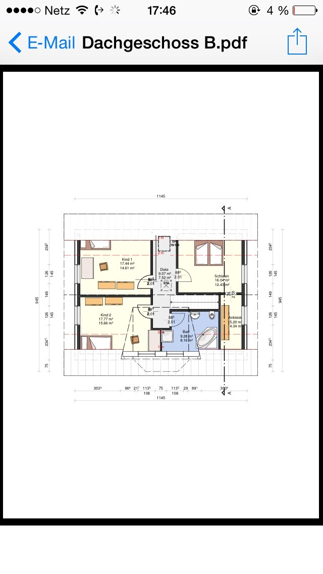

So, friends... there are 2 final floor plans: Option A and B...!
Your opinion will definitely help us! Which option do you prefer?

Upper floor plan with two children's bedrooms, master bedroom, bathroom, and corridor.
Upper floor plan: master bedroom, 2 children's bedrooms, bathroom, hallway, dressing room, corridor.
BauPaar29 Nov 2014 18:23
A / Ground Floor: The office feels too awkwardly shaped to me. Is there a door from the hallway to the kitchen? Does the utility room need to be that large?
A / Upper Floor: Walking in front of the sloped ceiling (into the bedroom) is, in my opinion, not acceptable. The children's rooms are also awkwardly designed. What is behind the shower under the sloped ceiling? A dirt trap is inevitable there, right?
B / Ground Floor: Small study, but (positively!) with a door leading outside. Guest toilet is too narrow and corridor-like (tight!). Very open kitchen-dining-living area (I personally prefer closed kitchens, but that’s a matter of preference).
B / Upper Floor: Walk-in closet looks tight, shower under the sloped ceiling??? Oh wait, that’s the attic extension... I could imagine a slightly narrower bedroom with an enlarged landing there.
L
Legurit
29 Nov 2014 19:43
Walk-in closet with a width of 1.22 meters (4 feet) – that probably won’t work.
A lot of wasted space at the entrance of the bedroom.
The toilet room is very large for what it contains (a narrow space).
Bathroom layout is inconvenient – is there one meter (3 feet) of unused space behind the shower? In the other bathroom, a shower with 1.5 meters (5 feet) of headroom?
A lot of wasted space in one of the home offices.
The wardrobe doesn’t work in either room?
So, I don’t think either option is good.
DNL
29 Nov 2014 20:06
I like the half bed in the children's room.
But seriously: I would strongly recommend having the design done by someone who knows what they're doing. There are simply a lot of impractical corners and things like that in it. Some parts even seem unfeasible to me.
