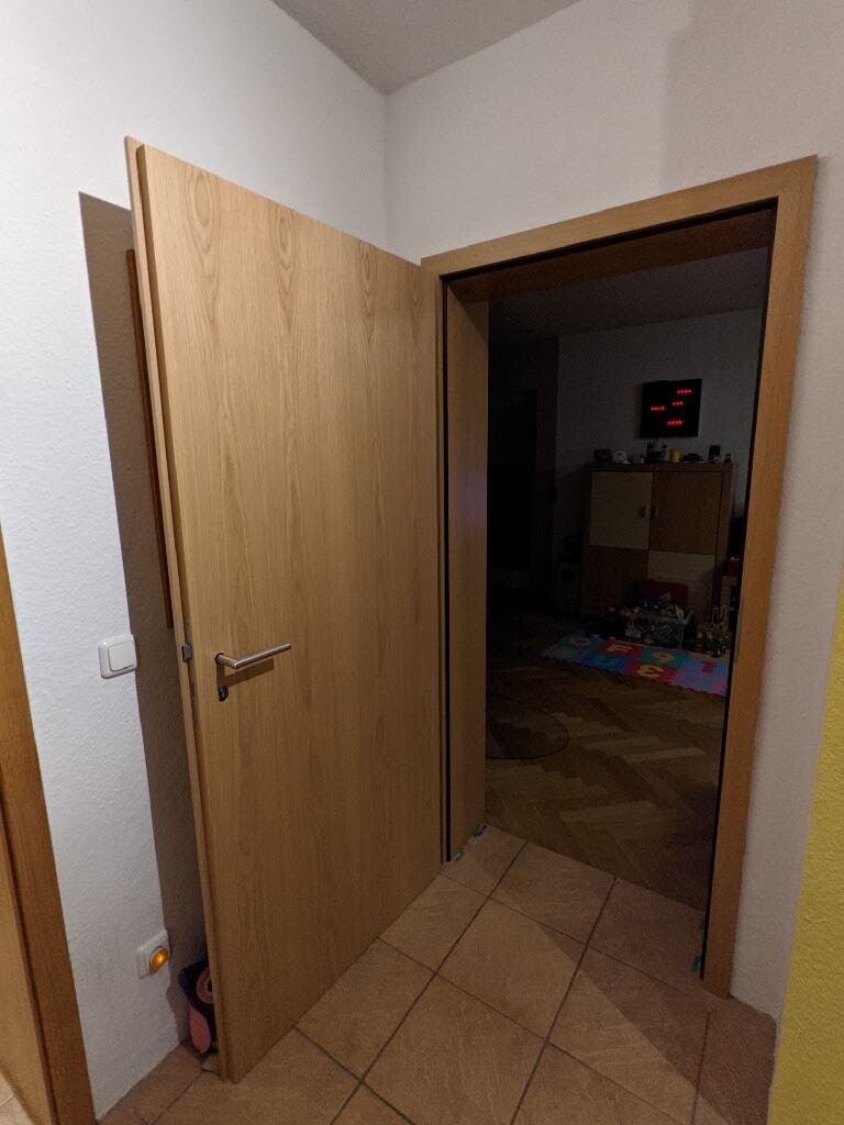

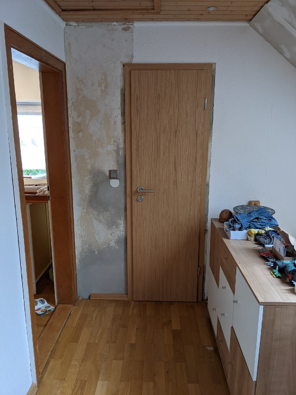

This allowed some time for small tasks. The doors of the living room and study were replaced:
Open wooden door in hallway leads to living area with play area in the background.
Hallway with wooden door, plastered wall and sideboard with tools.

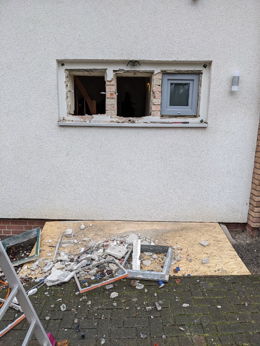

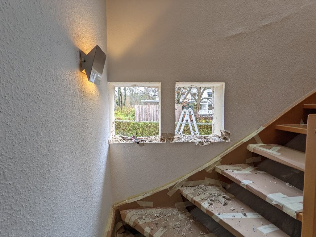

During the Christmas break, there was also time to replace the two stairwell windows.
The removal went fairly quickly with a large hammer:
Renovated stairwell with dust, two window openings, exterior ladder visible
Damaged exterior wall with open window niche, construction debris and fragments in front.

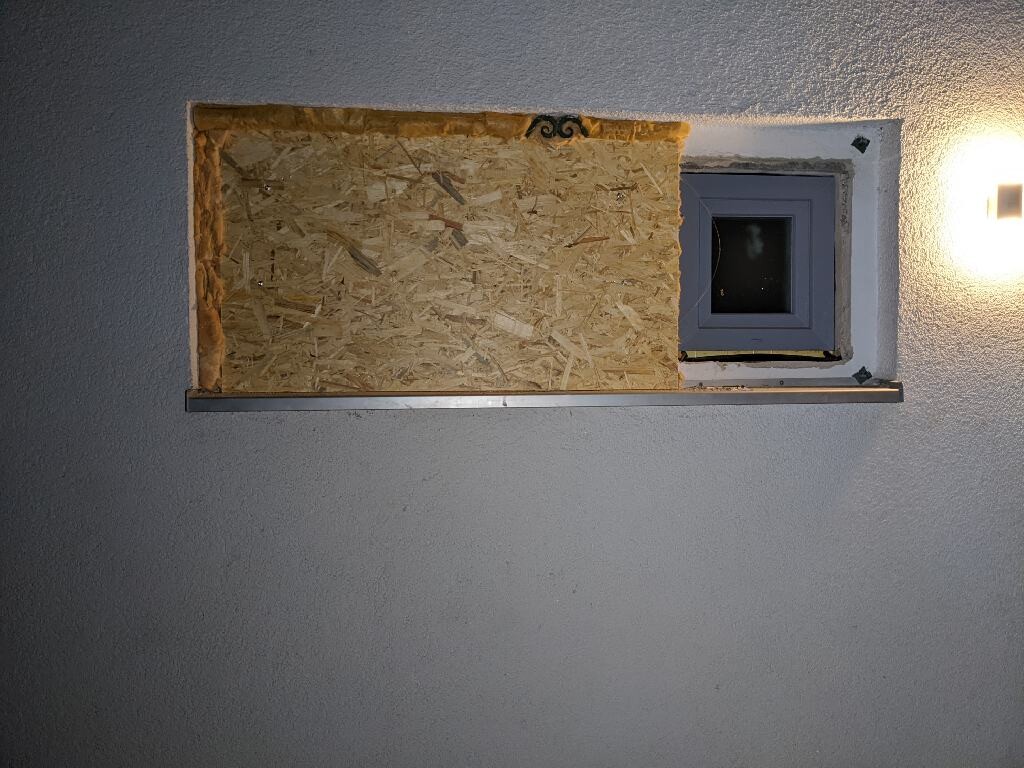

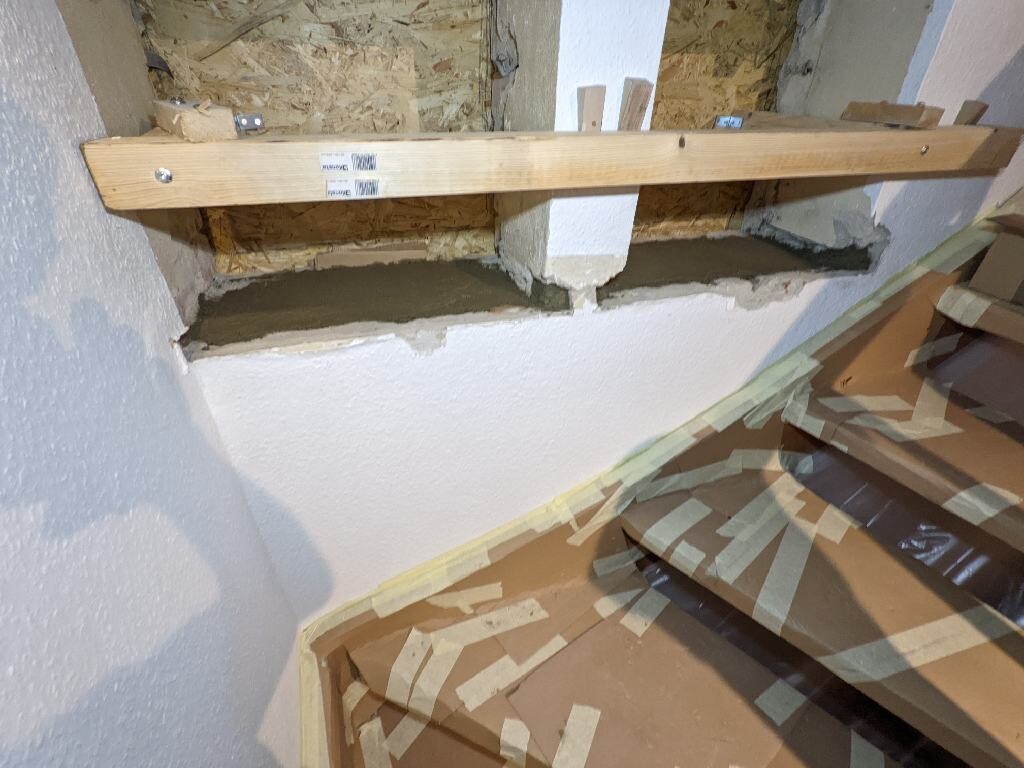

Afterwards, the opening was secured and some preliminary work for the installation was done:
Exterior wall with small blue-framed window; OSB board on the left, outdoor lamp on the right.
Construction site: wooden beam over styrofoam wall, OSB boards in the background, protective foil on the floor.

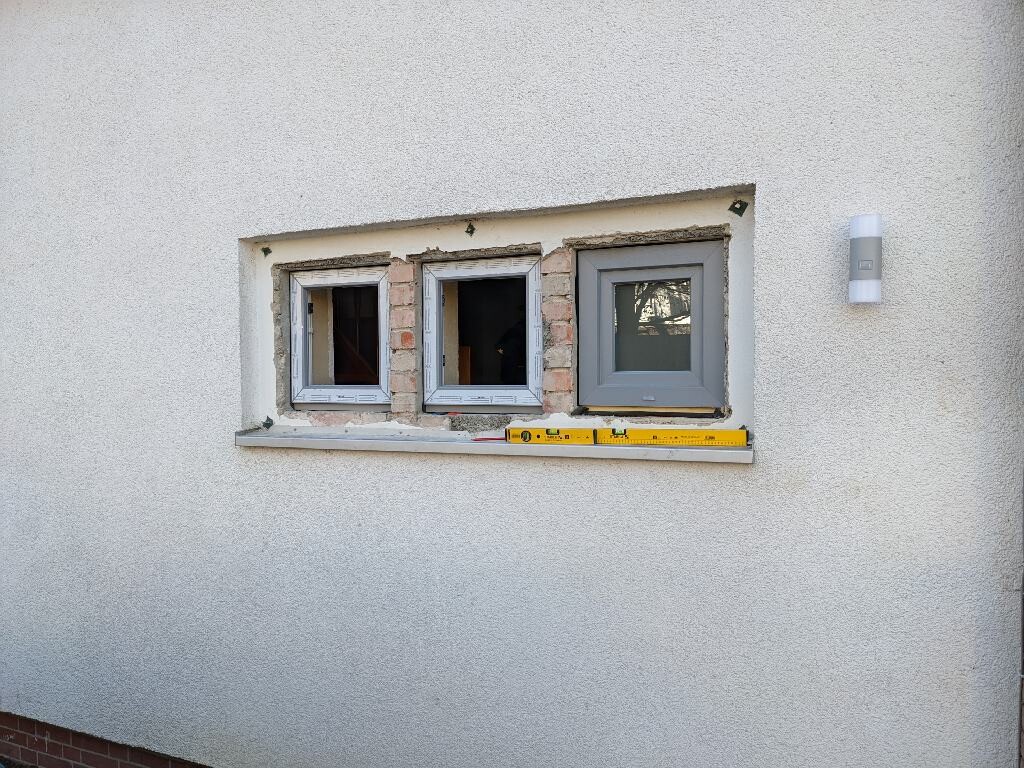

Then it was just a matter of fitting the windows:
Exterior wall with three windows; damaged areas around the frame; level lies on the windowsill.
Attic room with two small windows; angled staircase, masking tape on the steps.

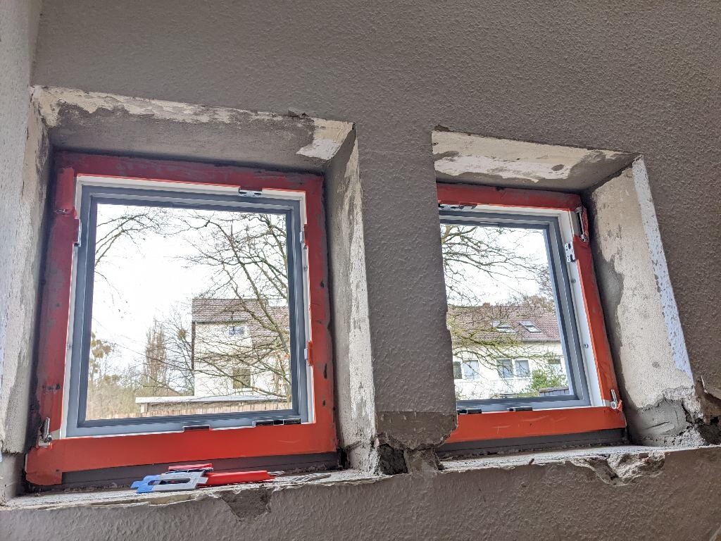

Later, the plastering was done on the inside. Outside work will continue once the weather improves and temperatures are higher.
Two windows with red frames in unfinished interior; view outside onto houses and trees.

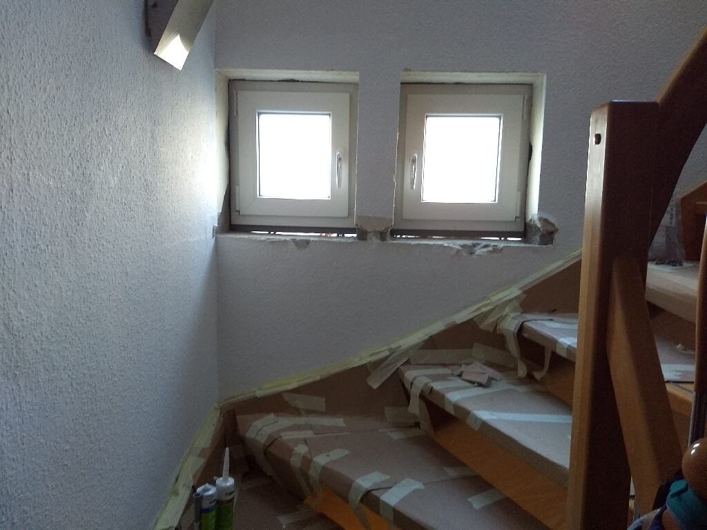

After the replacement delivery, the window sills were glued in and everything was plastered.
Two small white windows side by side in a yellowish wall; to the right a wooden staircase.
Two small windows in a damaged plastered wall next to a wooden staircase inside.
Two small square windows in a raw wall, plastic sheeting and orange masking tape.
Then wallpaper (and meanwhile paint) was added, and inside things are calm for now.
Two square windows in the stairwell with blue flower pots on the windowsill; wooden steps.

Looks great, but wouldn't fixed glazing with slim frames have been more worthwhile for all those small windows? This way, there is very little window area overall. And how wide is the door near the sloping roof?
LordNibbler1 Mar 2022 16:05
Clearly, having more window area would be nice. But with a standard frame, the difference compared to others isn’t that significant in the end.
Inside, it’s actually brighter than before, as the colored glass blocks used to absorb a lot of light.
The door to the study has a frame width of 580 mm (23 inches).
Climbee2 Mar 2022 15:36
Instead of two small windows placed side by side, I would have installed one wide, fixed horizontal window. Somehow, these two tiny windows next to each other look a bit odd...
