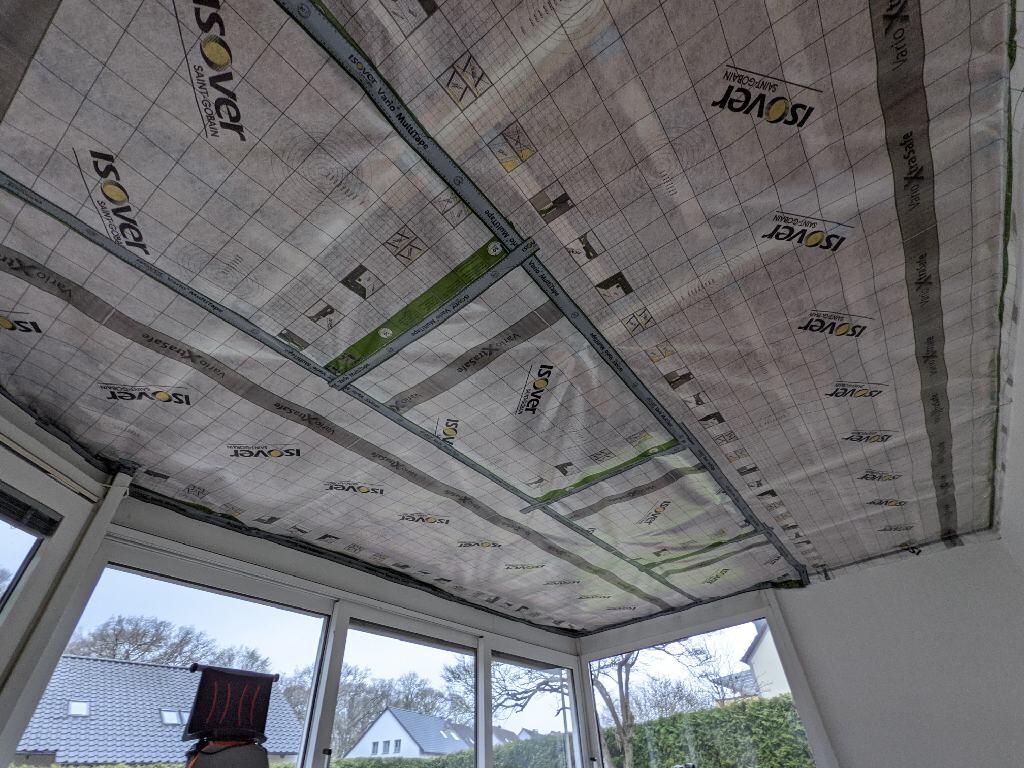

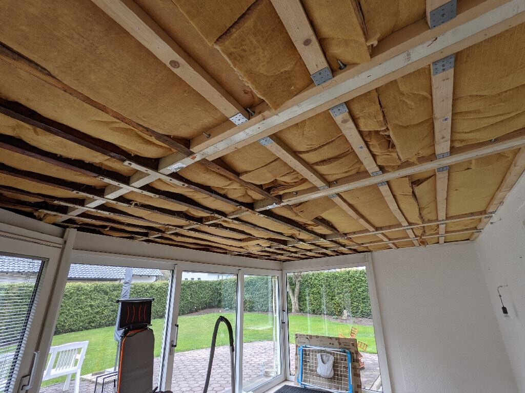

Conservatory equipped with new insulation and a climate membrane.
Ceiling with Isover insulation and metal strips; view through the window onto houses outside.
Open ceiling with insulation and batten structure in the conservatory; garden visible.

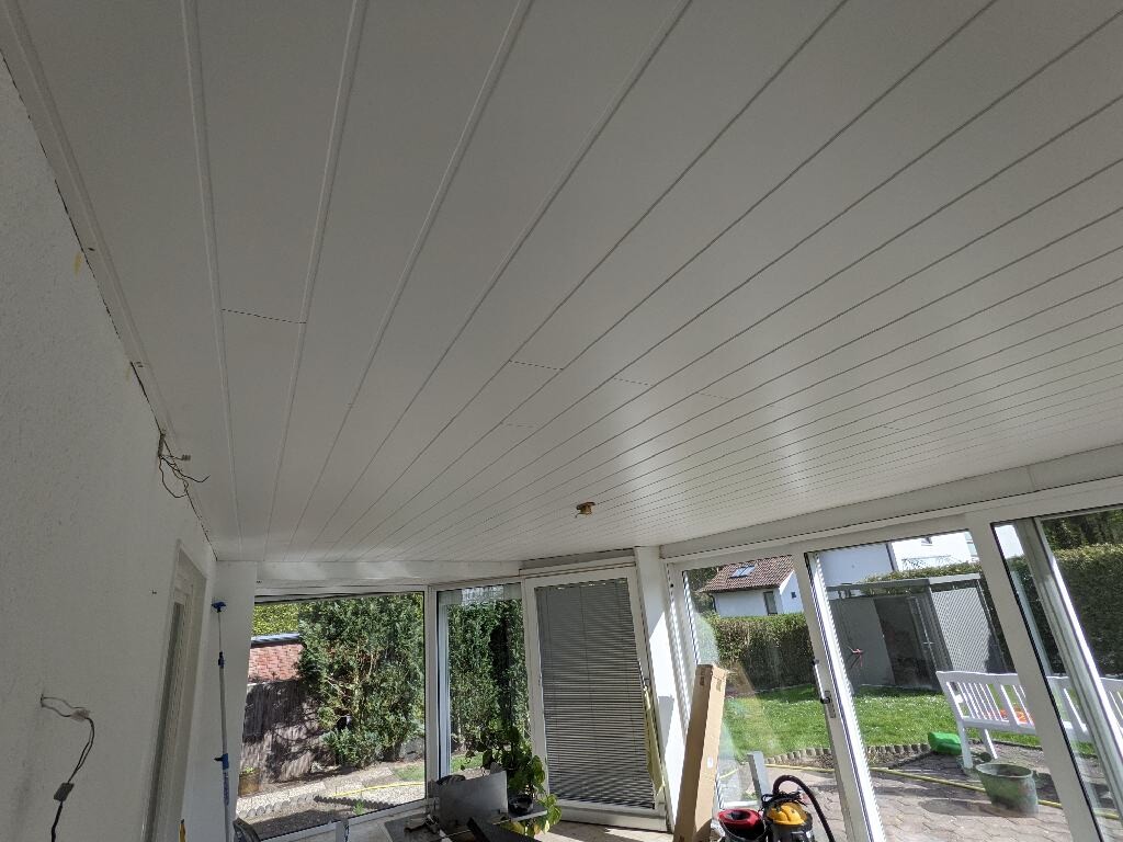

LordNibbler28 Apr 2021 09:14
The ceiling in the conservatory has been reclad. Only the finishing trims are missing.
Veranda with white panel ceiling and glass fronts; view of the garden, tools in the room

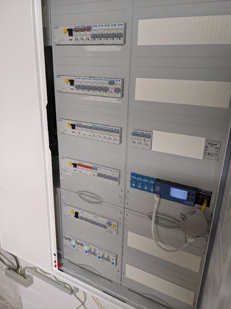

The distribution board has also been reorganized slightly, and an RCD + MCB have been added for the wallbox.
Electrical switch cabinet/distribution board with many circuit breakers and blue measuring device with display

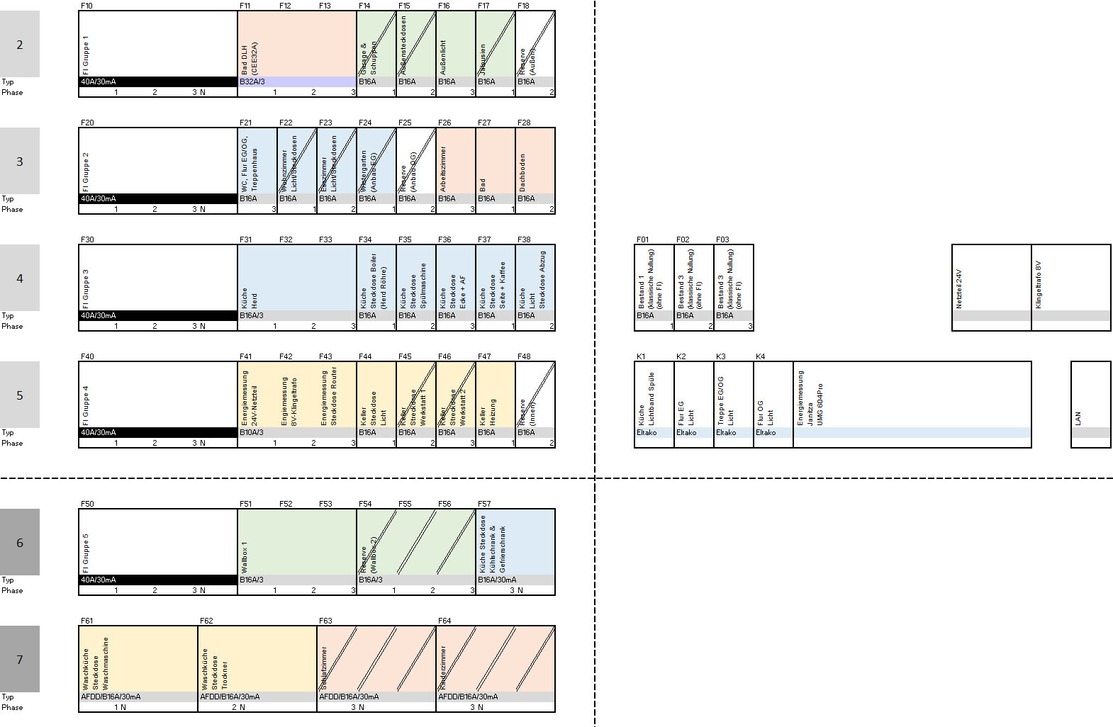

LordNibbler28 Apr 2021 09:37
Here is the setup inside the electrical distribution board. This should provide enough capacity for future needs.
Schematic installation plan with colored fields, labels F10–F64, and groups 2–7.
nordanney
28 Apr 2021 10:46
LordNibbler schrieb:
Here is the setup in the electrical distribution board. This should provide enough capacity.
Where is the surge protection device (e.g., Dehn combined arrester or similar)?
LordNibbler28 Apr 2021 11:11
nordanney schrieb:
Where is the surge protection device (Dehn combined arrester or similar)?
Behind the left door, above the meter. Here is the original condition after the electricians installed the panel:
The electricians are at home; the panel is operational.
nordanney
28 Apr 2021 11:57
Behind the left door, above the meter. Here is the original condition after the electricians installed the cabinet:
I didn’t remember the "old" pictures. That fits then!
