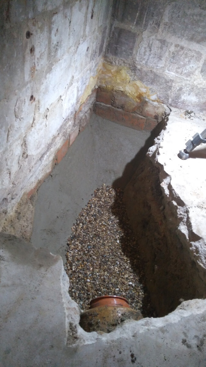

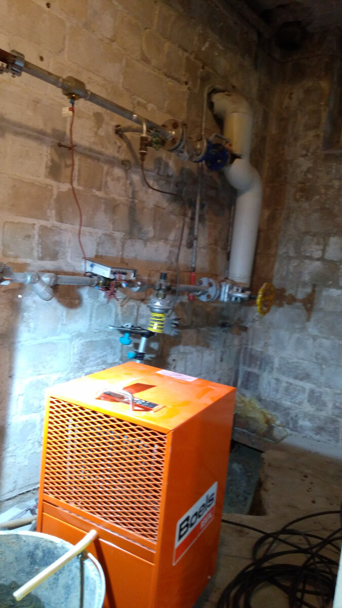

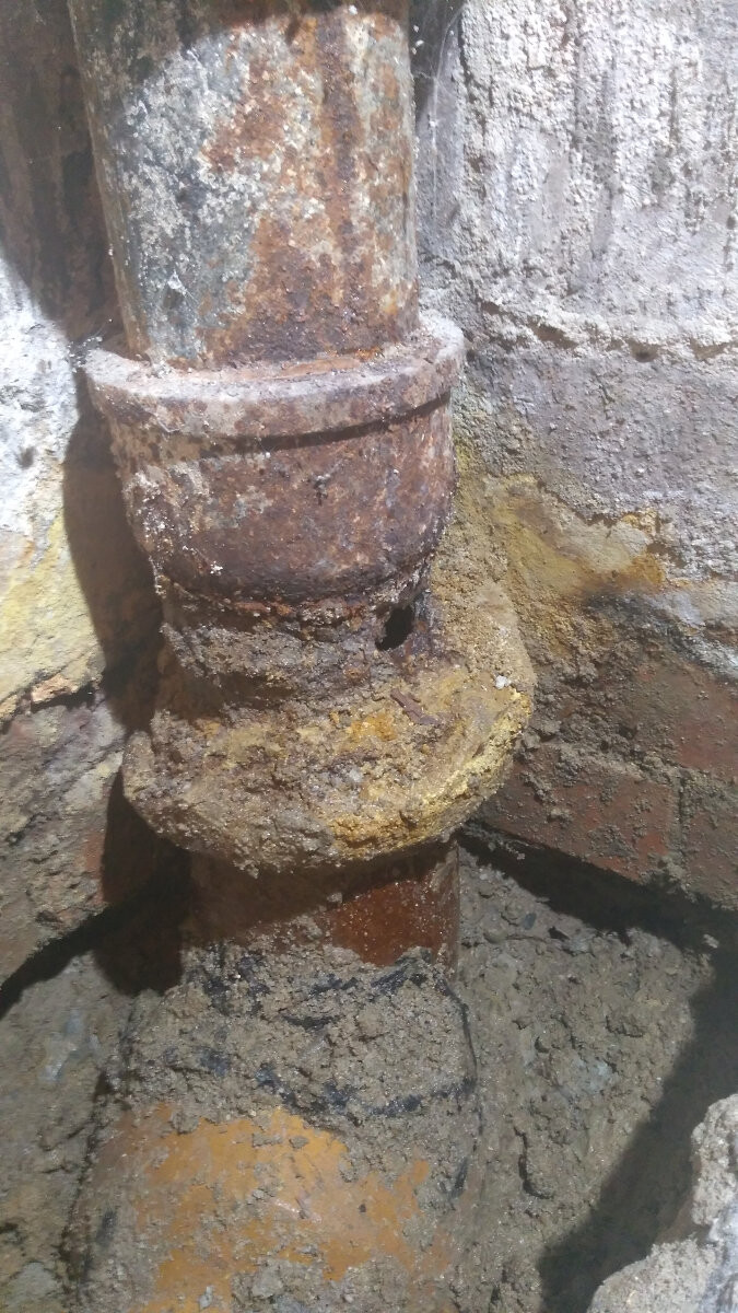

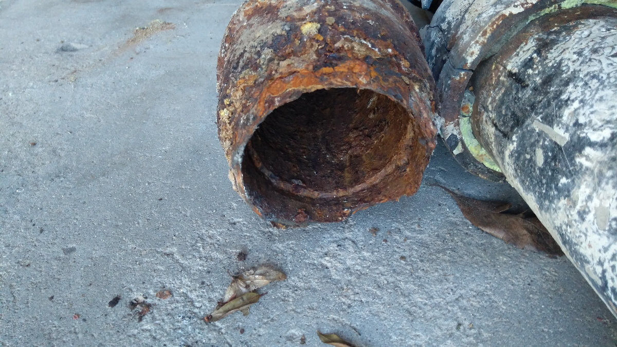

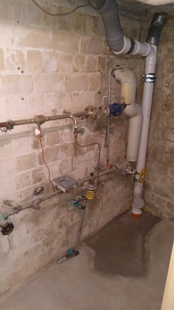

The main project in the basement will be to replace the soil pipe leading to the guest restroom. For now, only in the basement and without having to open anything inside the restroom itself.A brief update on the past few months. With a child in the house, progress is a bit slower, but it continues.

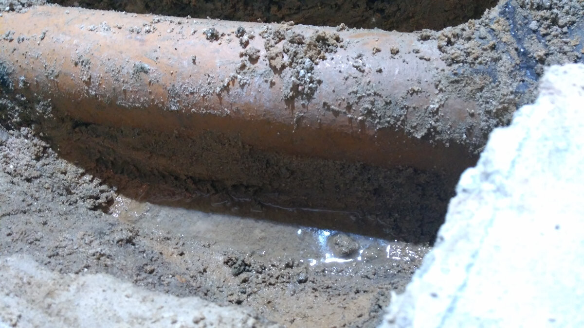

First, the wastewater pipe in the "boiler room" is being addressed. As shown, the corner is already very damp and the cast iron pipe is heavily corroded. After exposing it, the following condition was revealed:
The wall thickness was minimal, and two holes immediately formed. To work more easily, I broke up the floor up to the next socket.
The next day, the jackhammer quickly dealt with the stoneware pipe, and the cast iron part was cleared as well. It is clearly visible how little of the pipe wall remains.
Then, a construction dehumidifier was used to reduce some of the moisture.

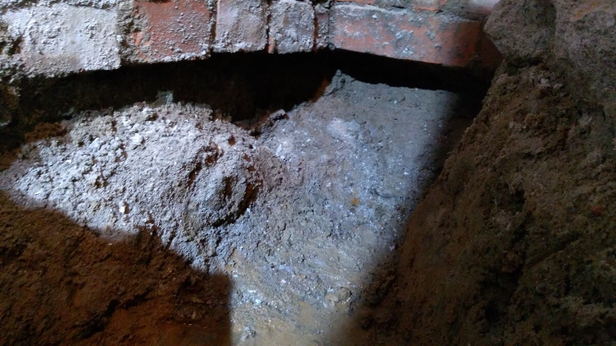

The corner area’s foundation was not fully formed and was also damaged by moisture.

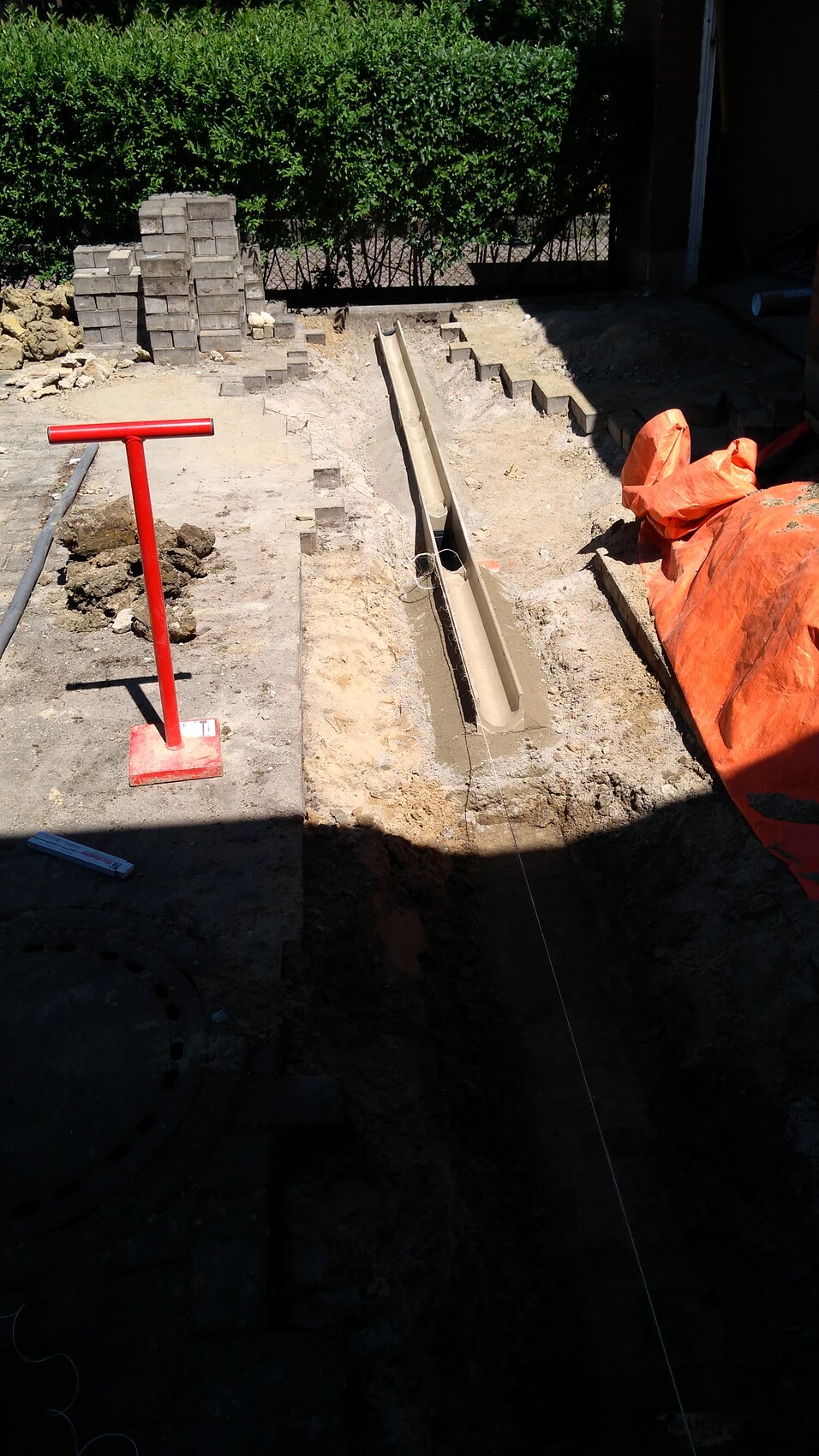

This was backfilled, and a gravel bed was laid to support the new drainage pipe (KG pipe).
In the end, all pipes were installed and the floor was closed back up.
The connection going upstairs is still temporary, as the guest restroom still needs renovation.

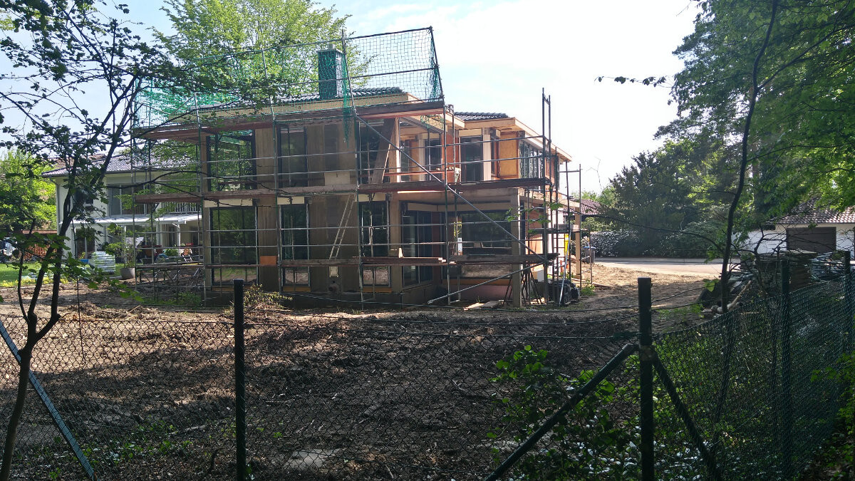

Just for comparison, here’s what others are doing in the residential area:

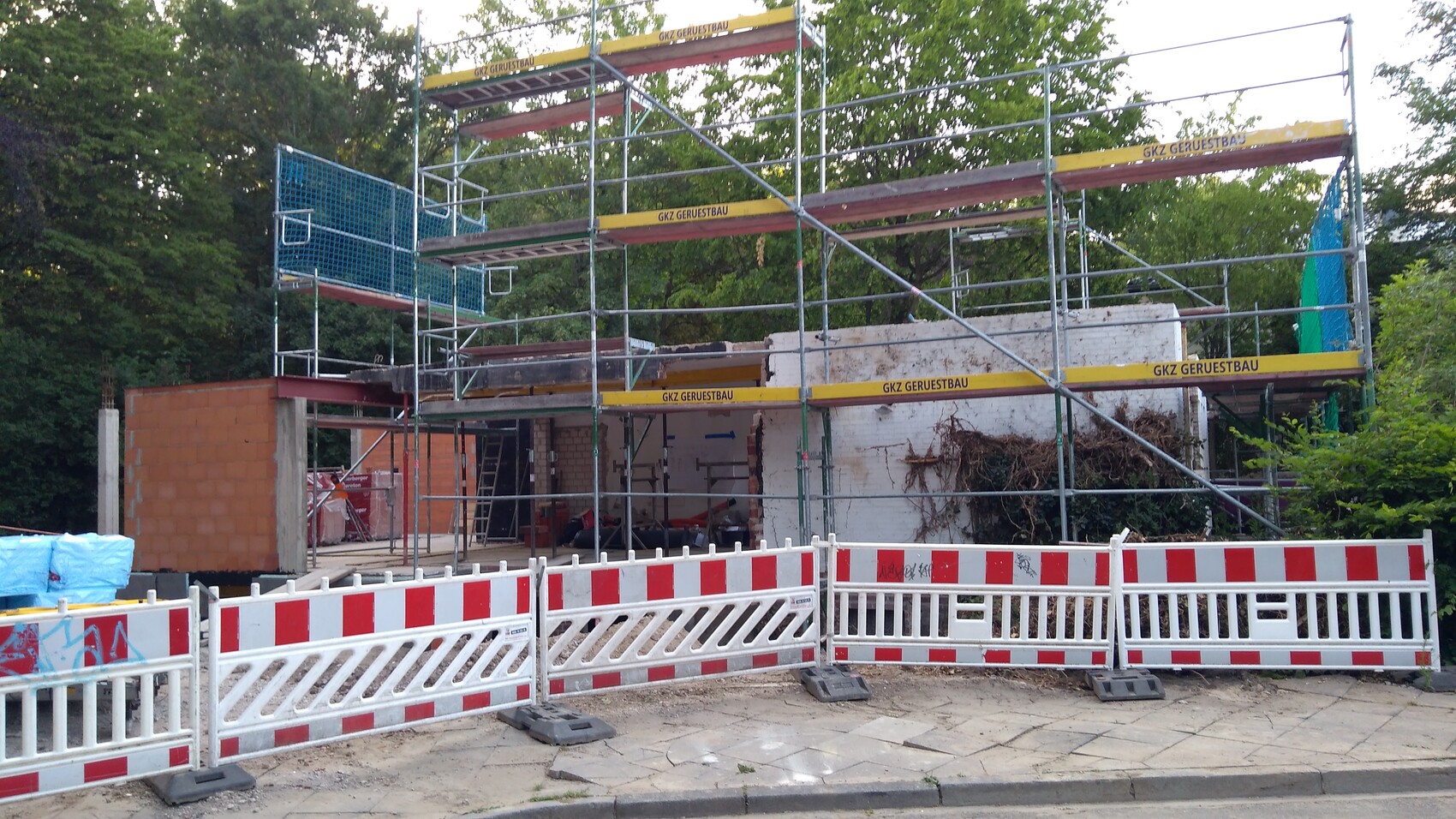

Here is an update from the other construction site in the neighborhood:
The entire pitched roof on the upper floor and half of the ground floor were demolished and partially rebuilt on a larger footprint.

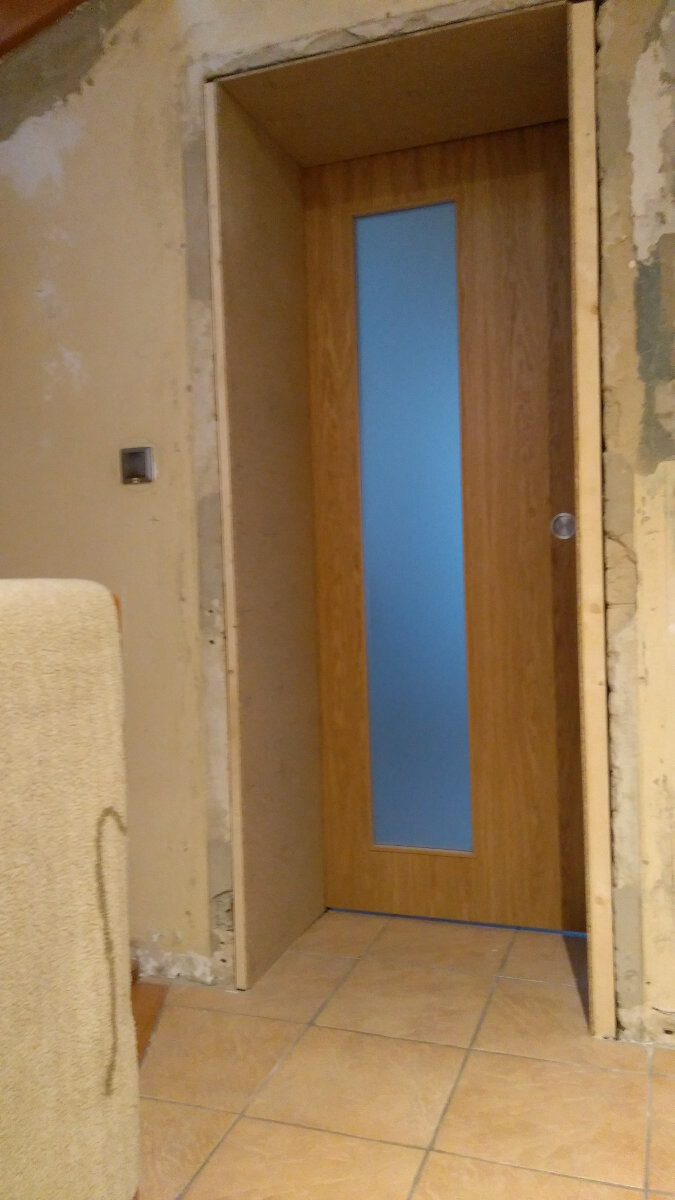

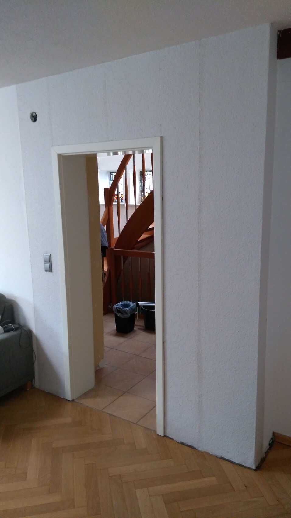

In the hallway, the sliding door has received a side panel until the carpenter has time and materials to install a proper door frame.

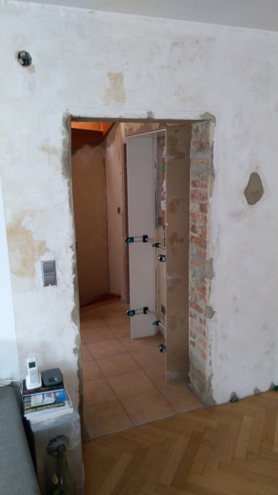

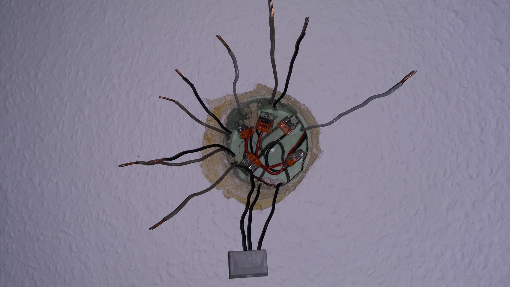

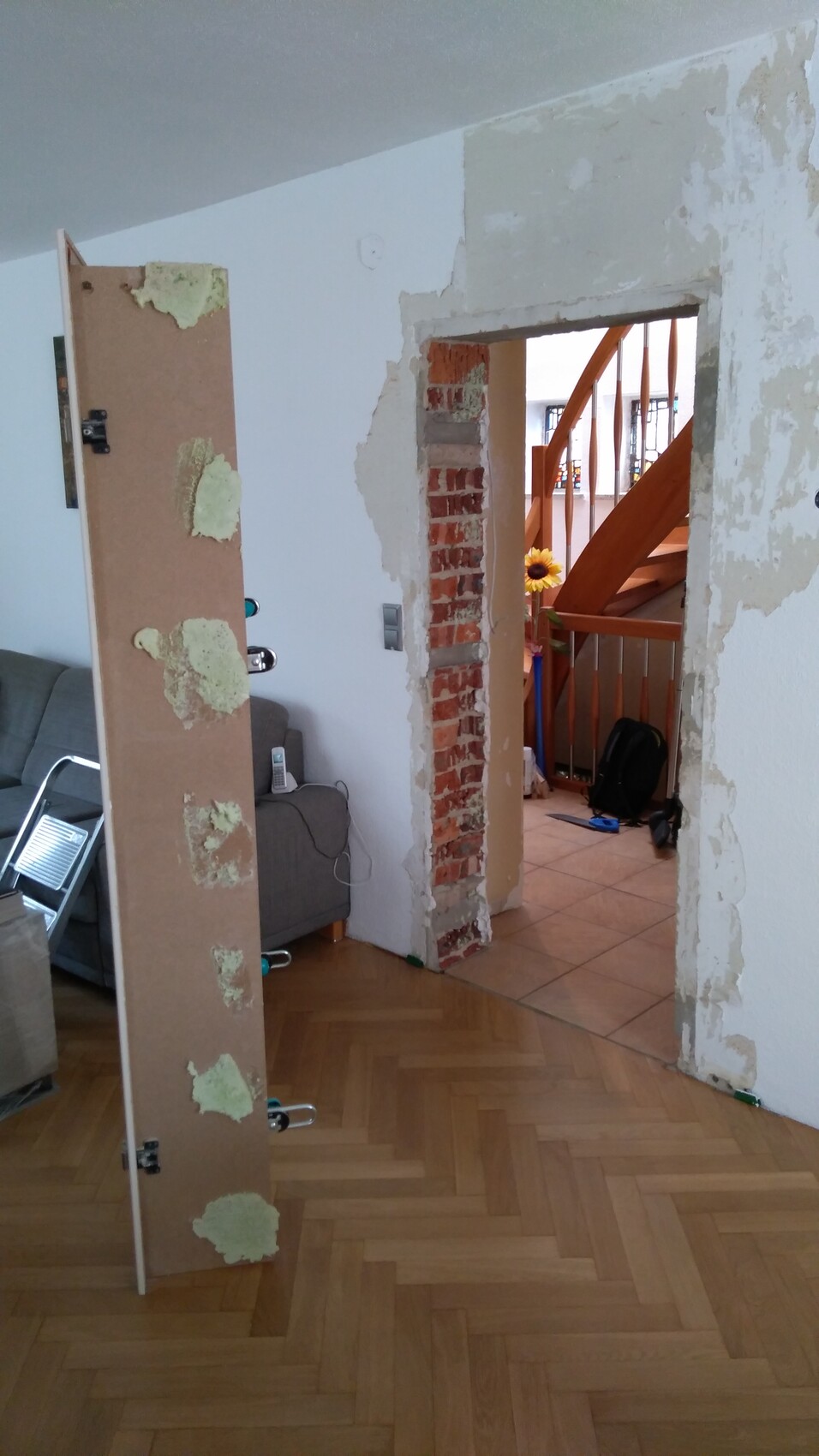

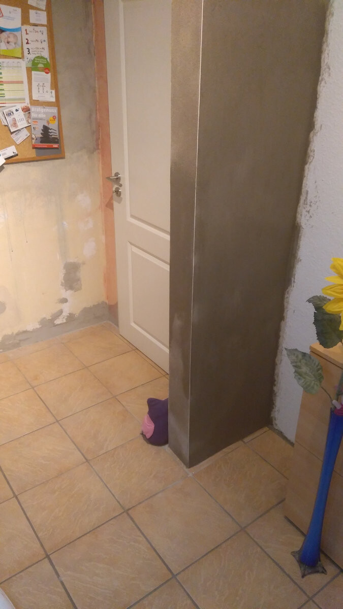

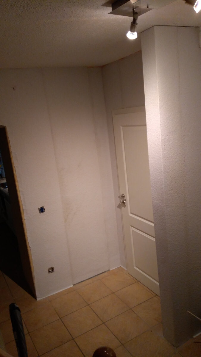

During the removal of wallpaper, repositioning of the living room door, and renewal of electrical wiring, some areas of the hallway walls were damaged. These have only been replastered so far.
(23.02.2020)
With wallpaper (and shortly after, paint), the work behind it is hardly visible anymore.
(01.03.2020)

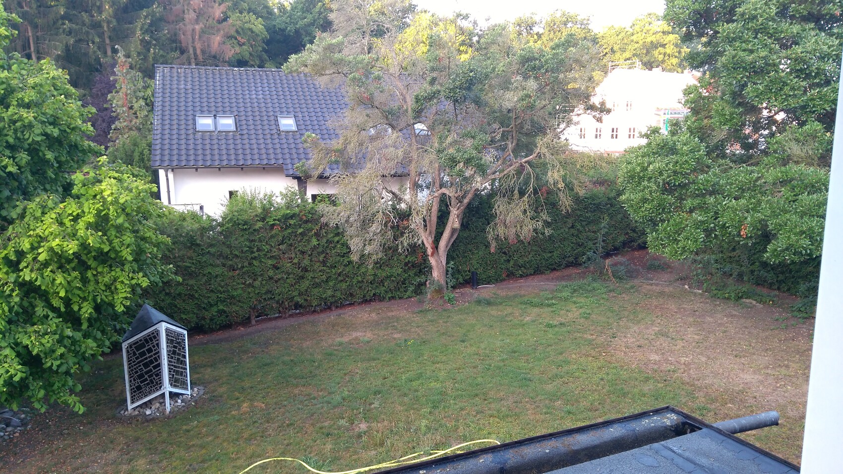

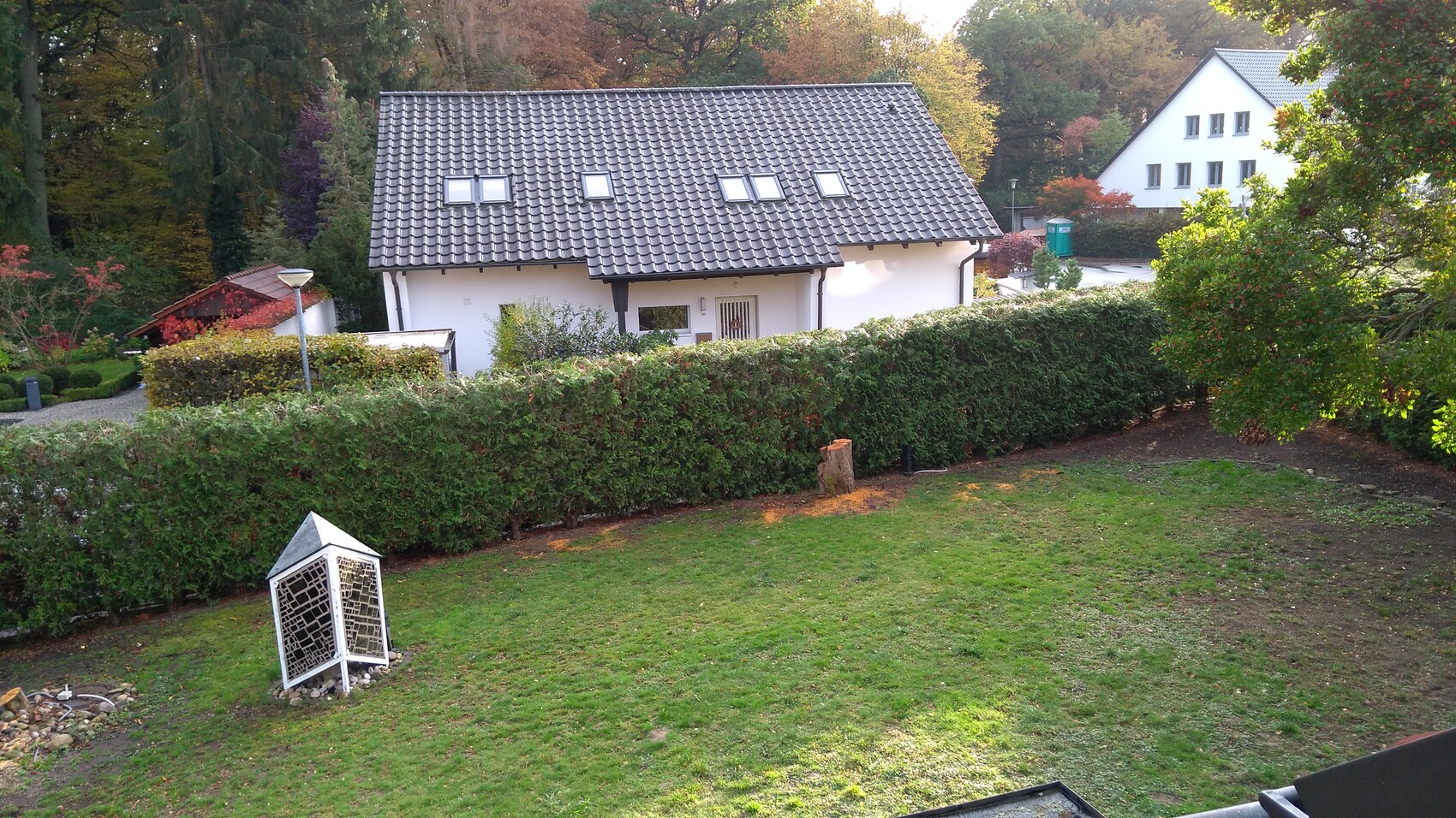

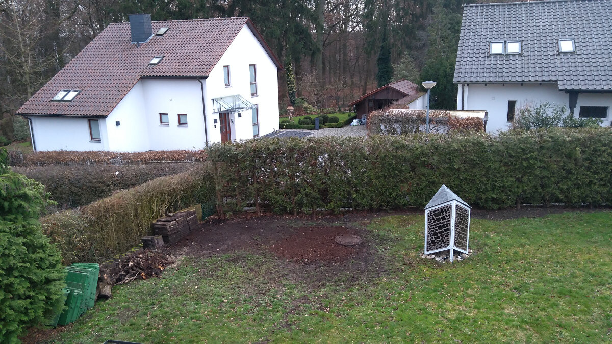

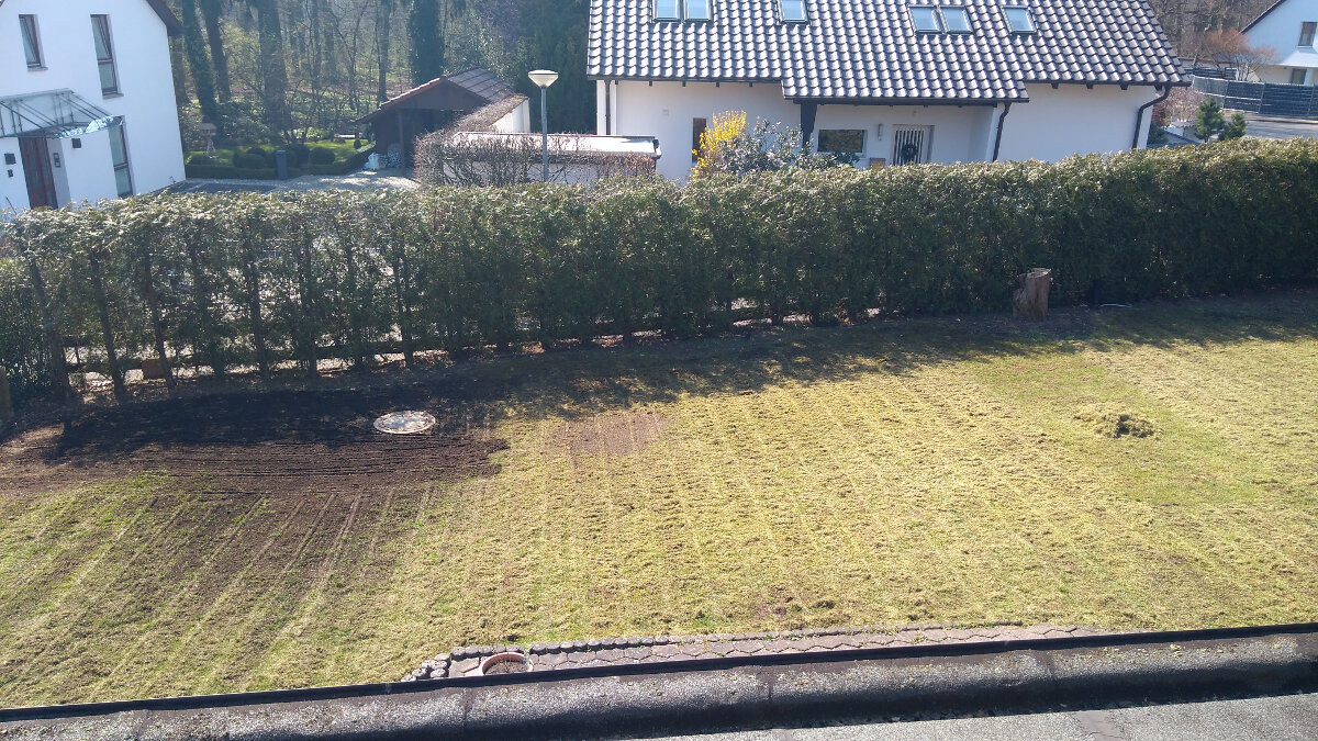

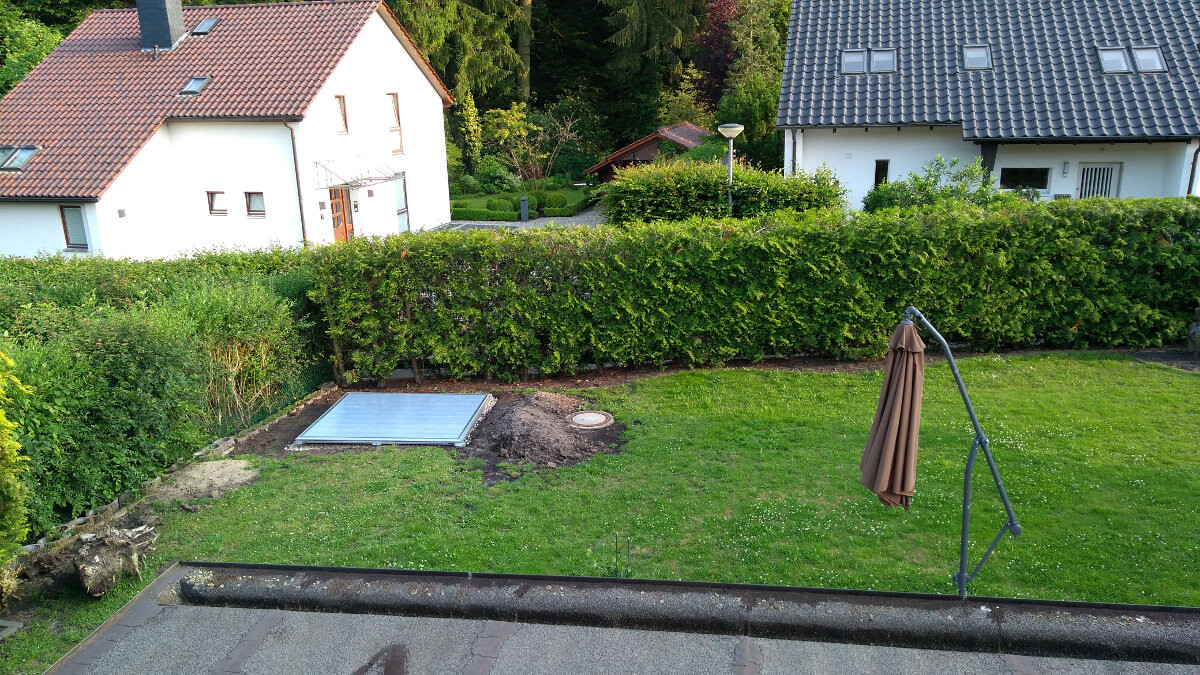

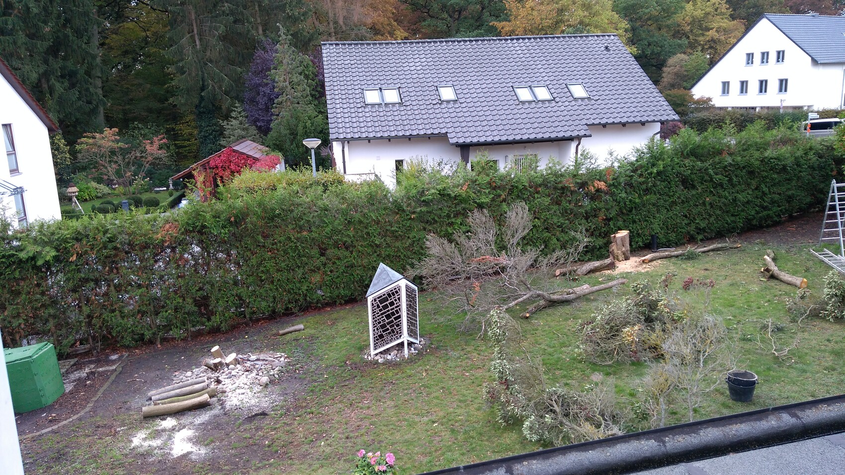

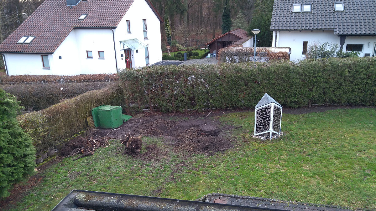

By the end of the year, the garden looked like a battleground. After most of the hazelnut remnants were cleared, the soil was slightly leveled and the compost was removed.
(24.12.2019)
(31.12.2019)

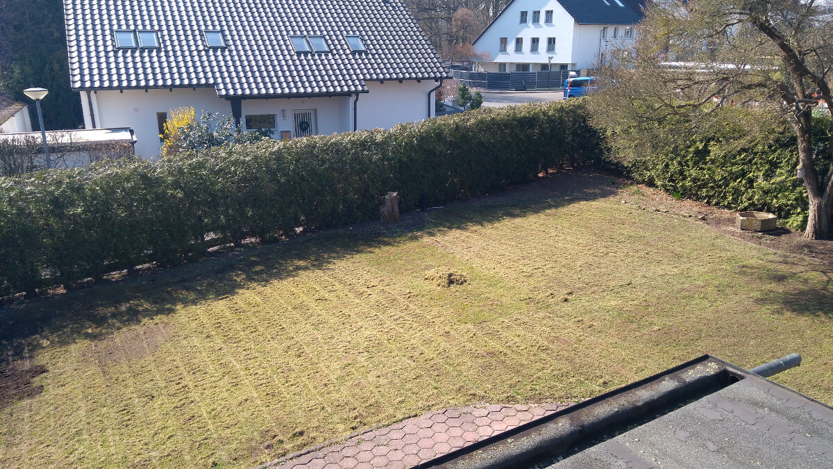

At the end of March, the entire lawn was scarified.
(28.03.2020)

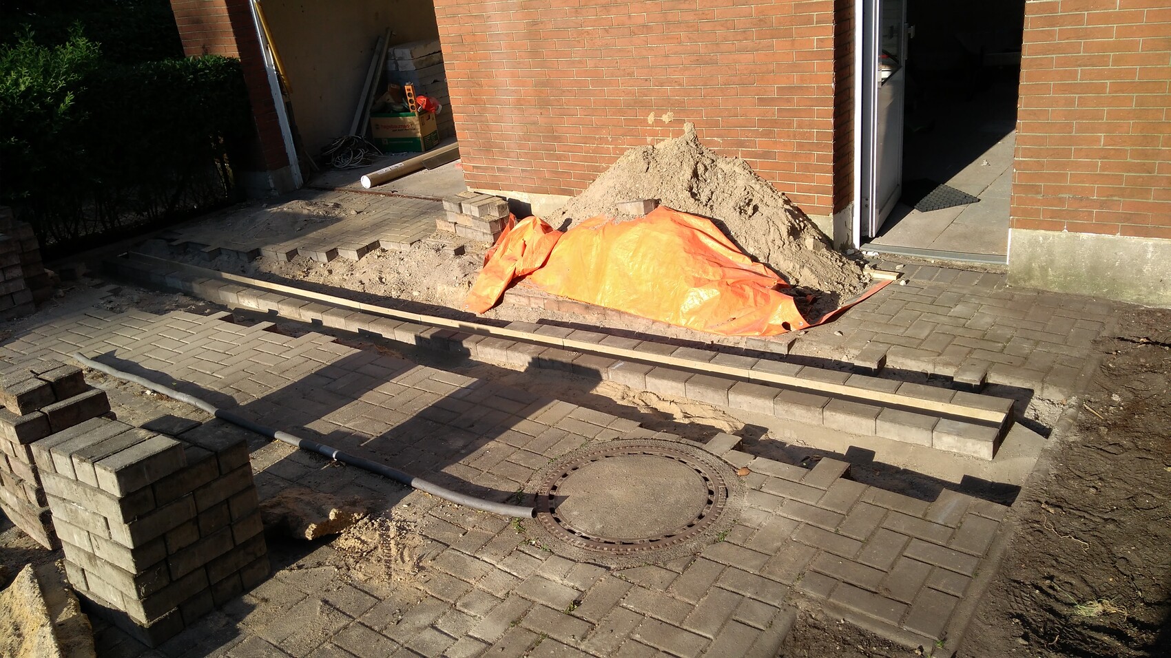

Currently, a tool shed is being built so that the patio area and the shed by the garage can be demolished:

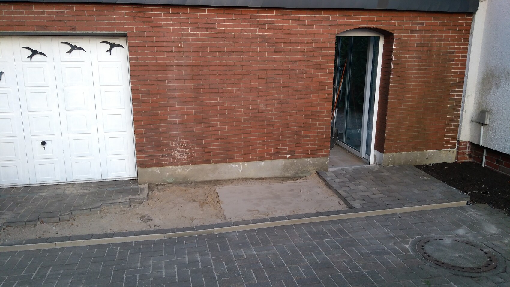

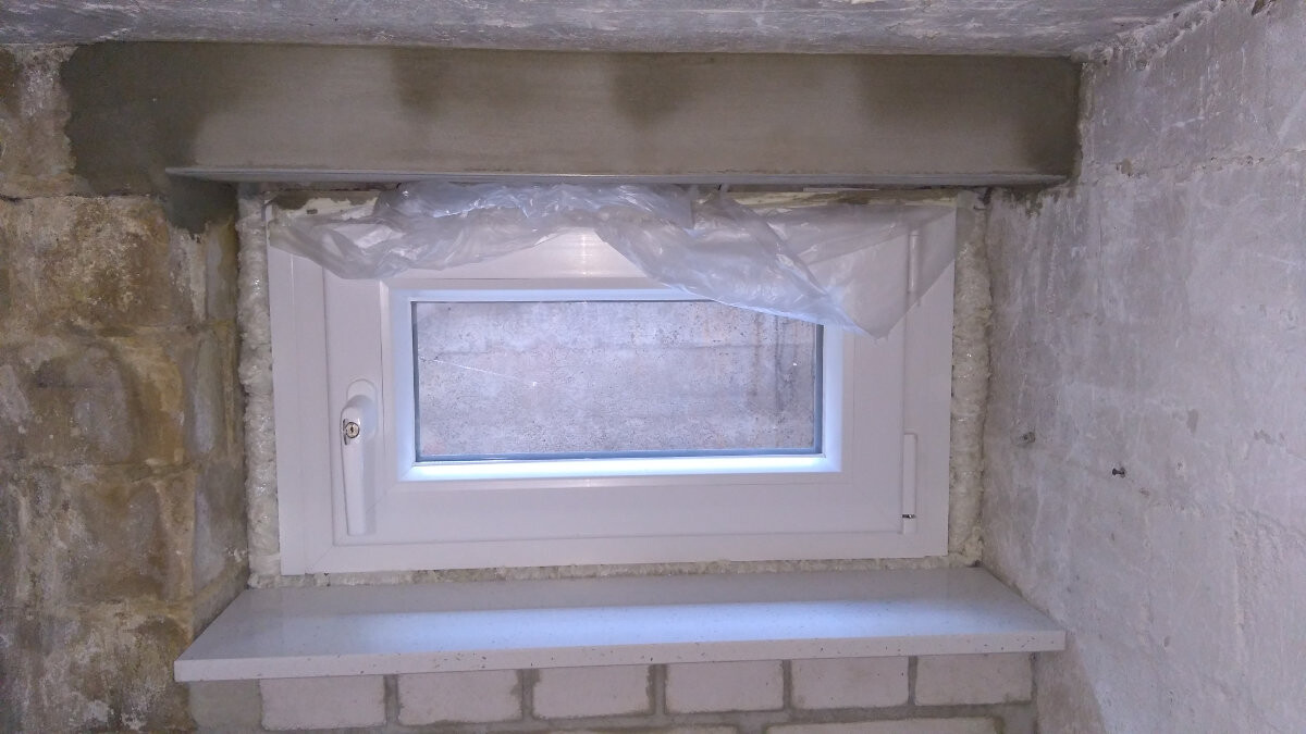

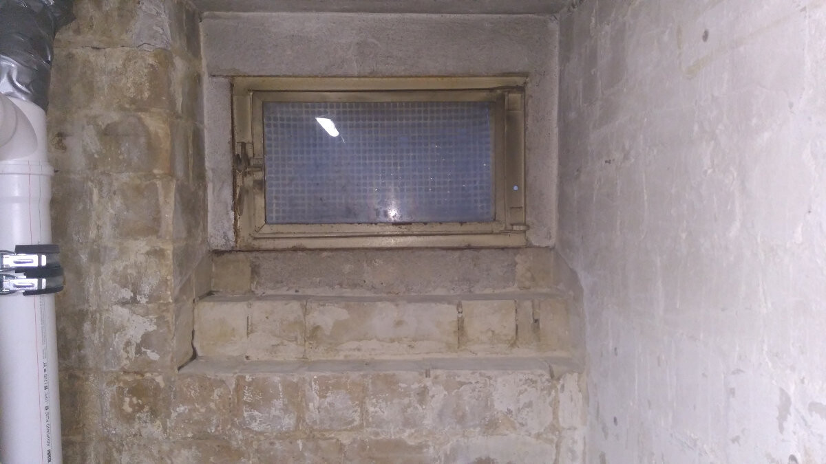

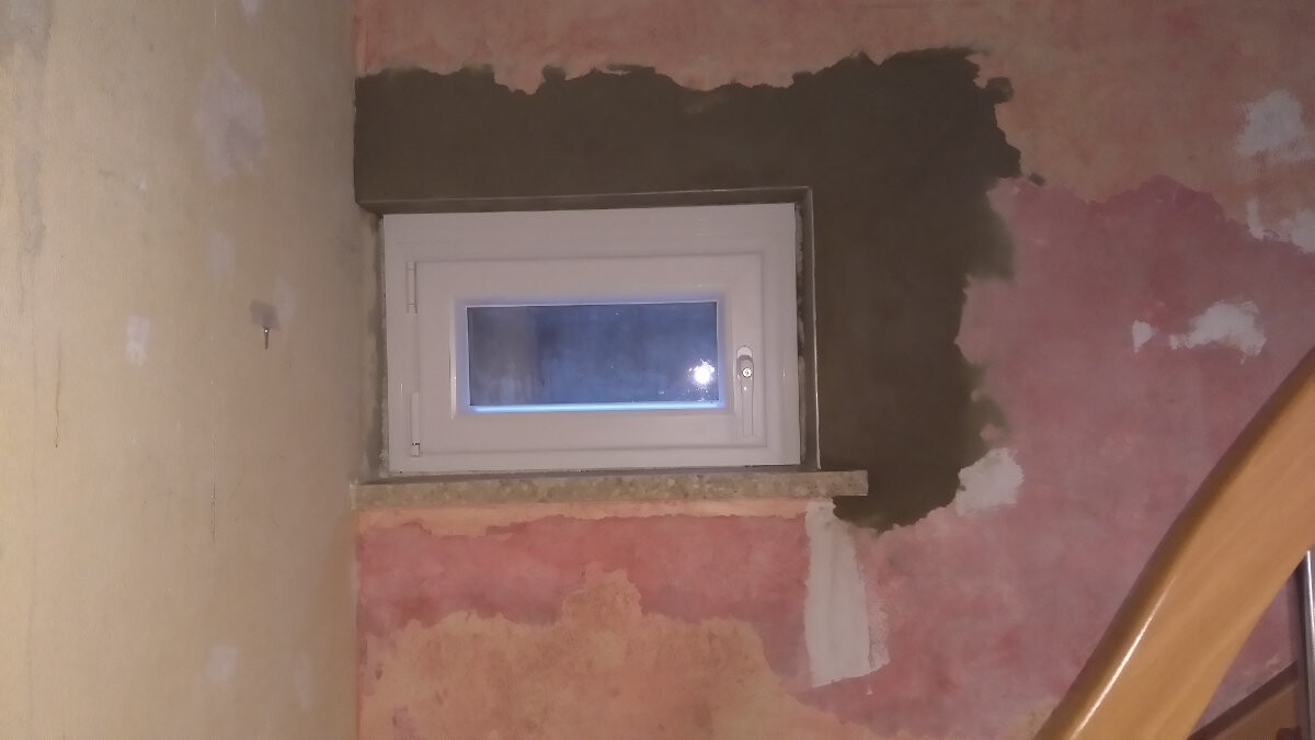

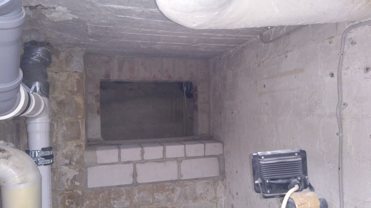

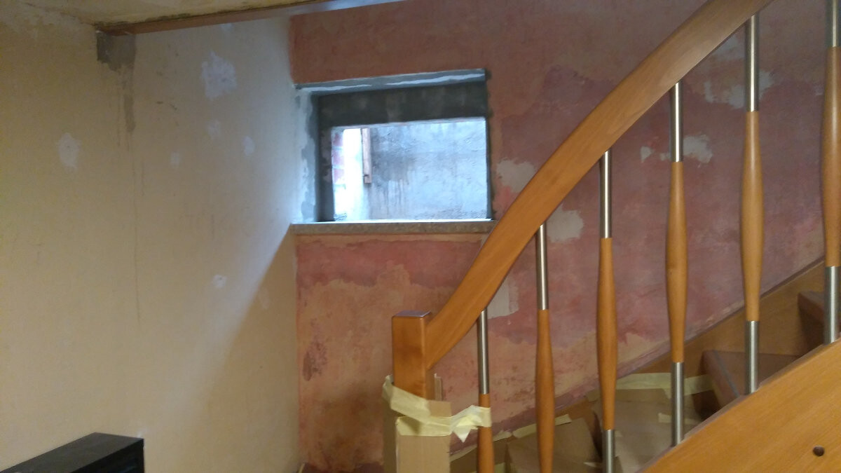

The basement windows were due for replacement. Until now, they had been made of metal and single-glazed. Over the years, they had become drafty and partly rusted. After removing the "window sills" (concrete slopes), the situation for measuring for the window installer was as follows.
(09.05.2020)
The stained glass window by the stairs was removed.
(08.08.2020)
The missing sand-lime bricks were rebuilt (@11ant: please ignore the overlap measurement):
(16.05.2020)
I’m not sure what exactly the window installer measured, but why sometimes more and sometimes fewer profile extensions were included remains a mystery. We had also explicitly offered to remove the windows before his measurements to allow for the largest possible glass area structurally.
In the end, for visual balance, we added a pseudo lintel (plastered aerated concrete block attached to the ceiling):
(09.06.2020)
The two rebuilt windows received window sills:
