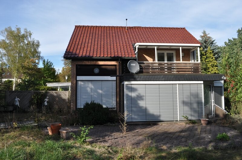

Then, at the beginning of 2018, an offer came up that didn’t fully meet our criteria but was in the same neighborhood.
- built mid-1958
- very high-quality construction and workmanship for the time
- architect-designed house (engineer) for a medical professional (MD)
- hillside location, split-level, integrated garage
- district heating with concealed convectors
- well maintained, so renovation was minimal (bathroom tiled + ceramics, new roof 2002, new windows 1995)
- well-kept garden, granite paving
- 165m² (1,776 sq ft) living space + 40m² (430 sq ft) utility space
- 905m² (9,740 sq ft) leasehold plot at a dead-end street
- 493,000 €

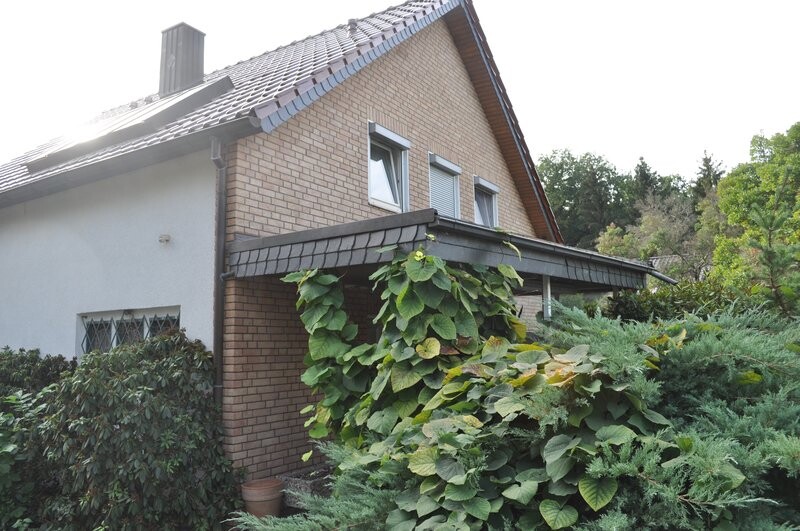

Later, however, a late response arrived that I only found in the mailbox weeks later. (We used a prepaid phone number and a throwaway email address to avoid spam from real estate agents.) The following information was provided:
- A small house on the same street as our apartment
- Built in 1960 with about 125m² (1345 sq ft) of living space
- Freehold plot of 787m² (0.19 acres)
- Basement with sauna and “wine cellar” with open fireplace (a kind of party room)
- Ground floor with living room, kitchen, toilet
- Upper floor with bedroom, children’s room, shower, bathroom
- Roof replaced in 2000 with high-quality tiles
- PVC windows from the mid-1990s
- Partially insulated
- Partially in need of renovation and modernization (e.g., electrical system)
- Price €450,000 private sale without broker

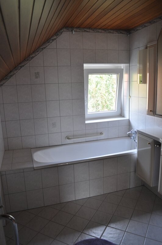

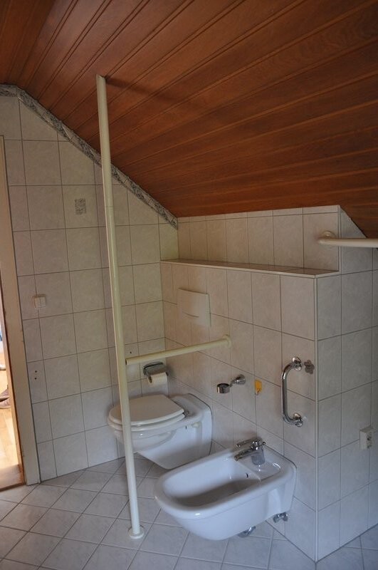

But pictures say more than a thousand words—so what was the initial condition?
We had "modernized" the bathroom between 1995 and 2000. It was tiled, with a new instantaneous water heater and ceramics; the bathtub and pipes were still original.
Long-term idea: Keep the bathtub as is, move the shower to the position near the toilet, remove the bidet, and move the toilet to the right of the bidet (where the radiator currently is).

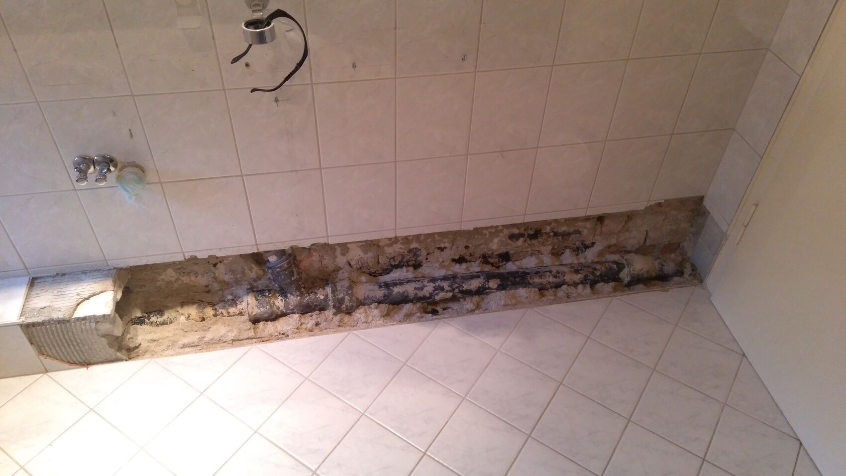

Under the washbasin, there is a base in which water and drainage pipes for the basin and bathtub should run from the door side. So open up the floor near the door and connect to new pipes there. On the toilet side, remove the bidet, open the stud wall, and reconnect the toilet.
Ah, how naive we were and how simple it all seemed.
Spoiler: The pipe sits much deeper, and water supply is elsewhere.
(December 15, 2018)
(December 24, 2018)

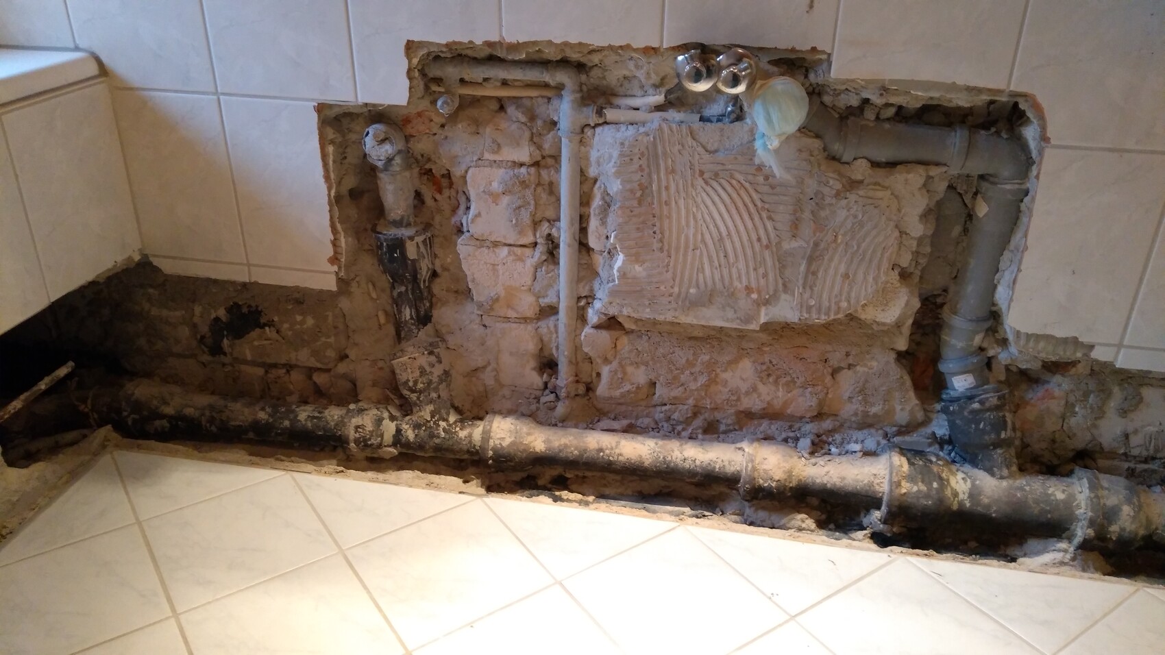

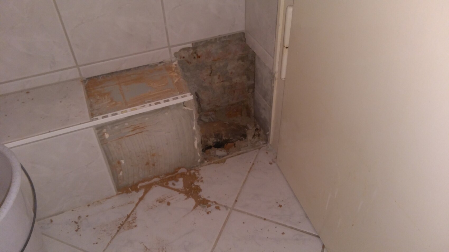

The entire base up to the bathtub had to be removed to get the old pipe out and make room for the new one.
And during the previous modernization, as little as possible had been changed—there were apparently two washbasins before:
(December 25, 2018)
Cleaned up neatly, bitumen waterproofing restored:

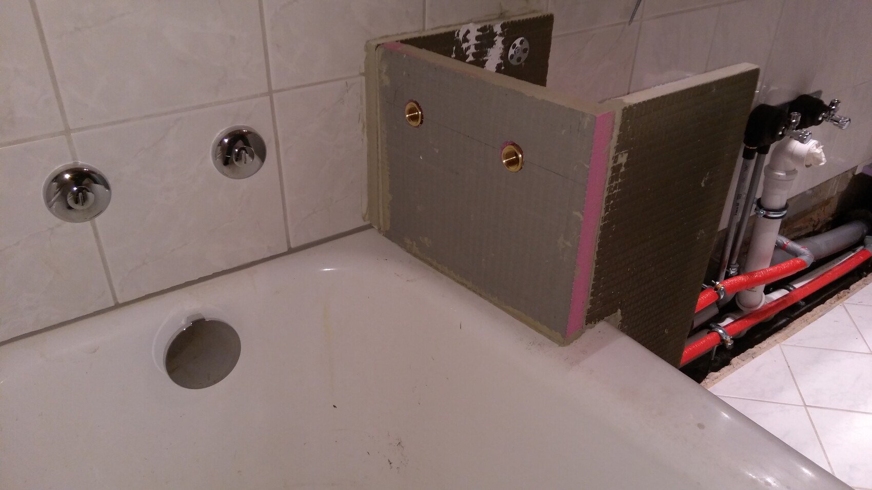

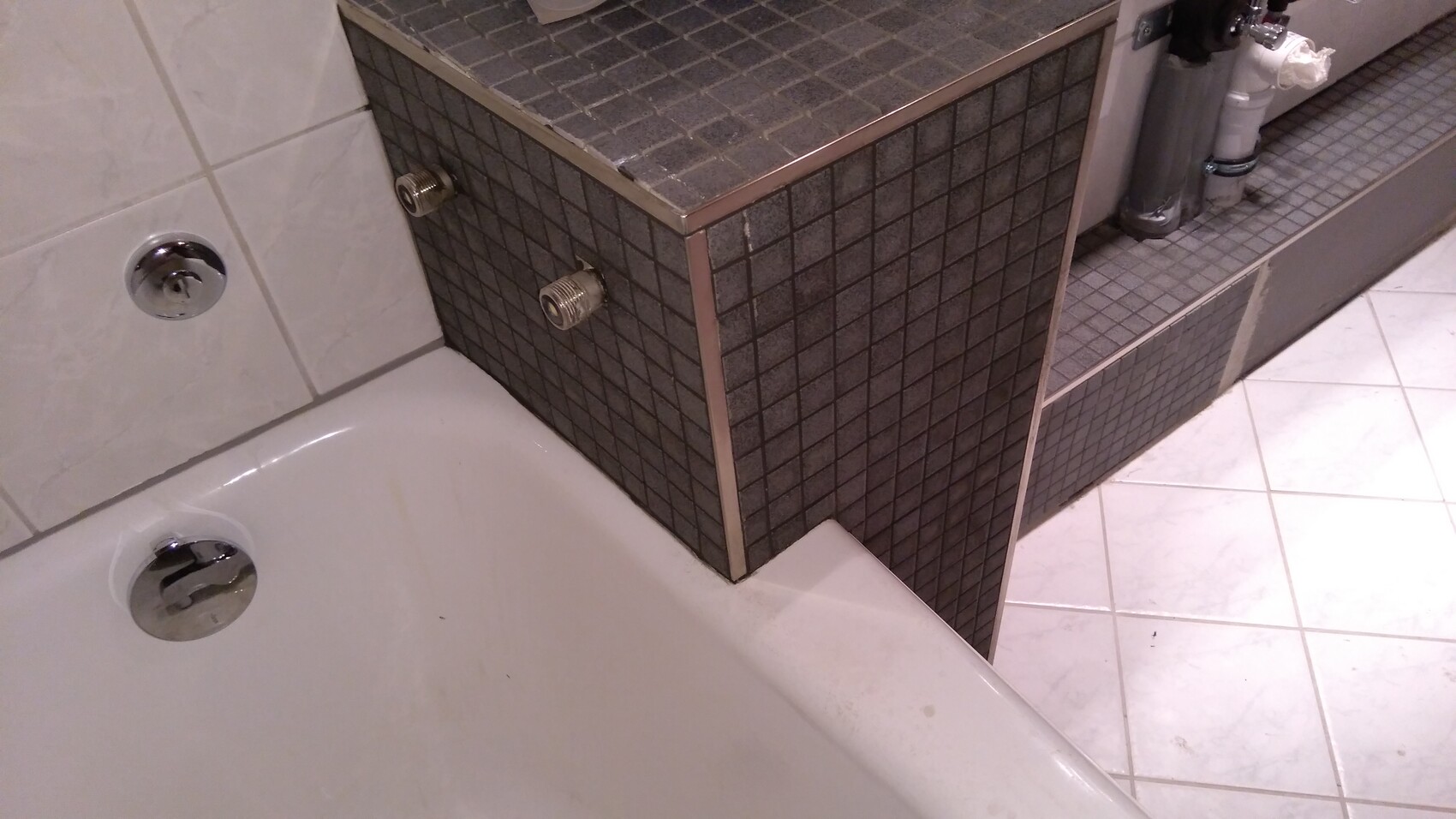

A few months later, it was time for pipe Tetris at this location. Besides the drainage pipe (DN50), cold water, hot water, and circulation pipes had to fit in. And all of this into the small base, as a full stud wall would only be built with the redesign. The pipes are planned for a central water supply but initially had to be temporarily connected to the new and relocated instantaneous water heater.
(March 16, 2019)

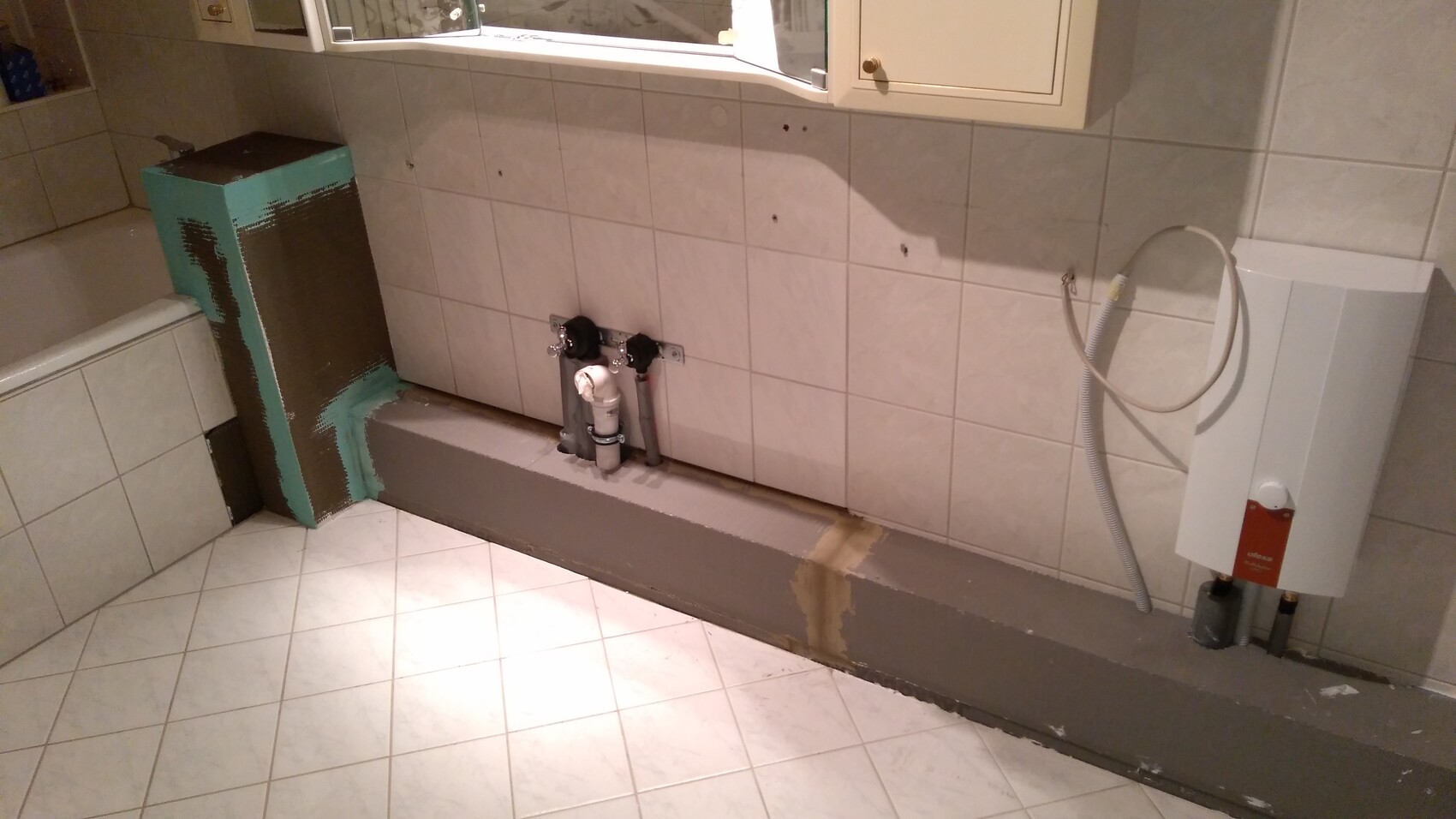

At the very end, everything had to be hidden under WEDI boards*, and an alternative tap position for the bathtub had to be created (the wall was not to be chiseled open).
(March 28, 2019)

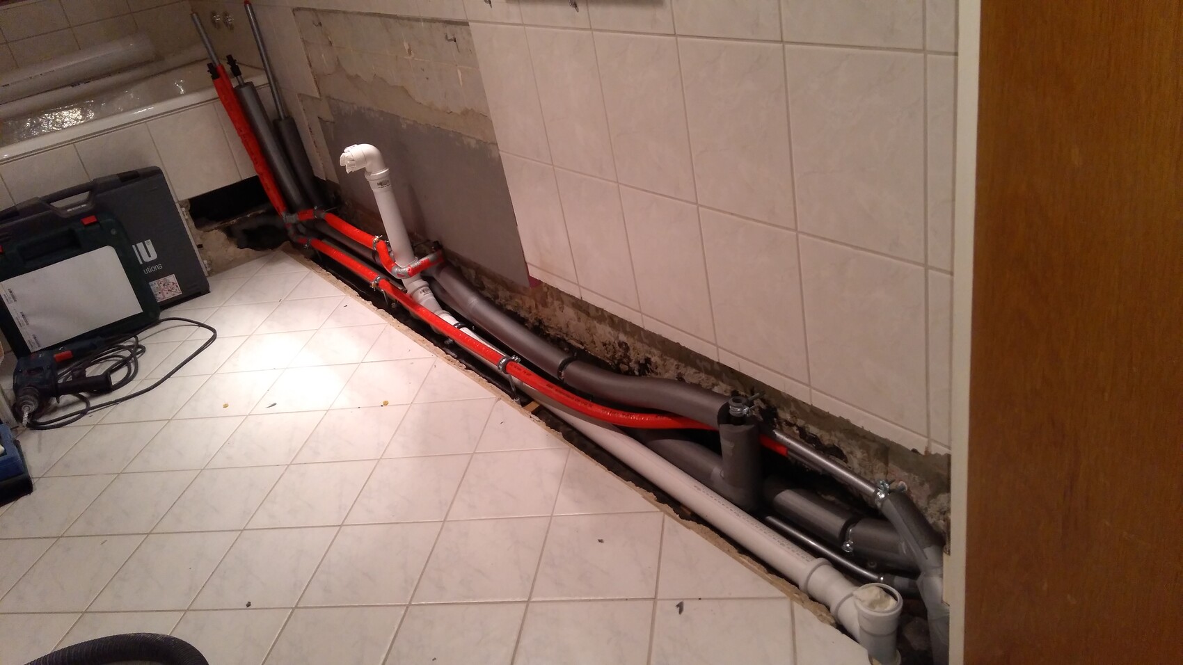

Beforehand: Due to my professional background, I used Raupiano wastewater pipes and Rautitan Stabil potable water pipes. Especially the push-fit sleeve system is truly foolproof and suitable for beginners. Furthermore, I have programmed and commissioned enough machines and quality control systems for these utilities to be familiar with the quality, and I have dealt with almost every pipe installed in some way using my own equipment. It’s also a nice feeling to have the product of previous work in your hands.
On a personal level, I once experienced living in a house that was being renovated over the years during my youth. For technical questions, I also have my father (architect/civil engineer), mother (landscape planner), my wife (PhD engineer), and myself as an engineering informatics specialist.
Now moving on to the WEDI boards:
(03/28/2019)
(04/02/2019)

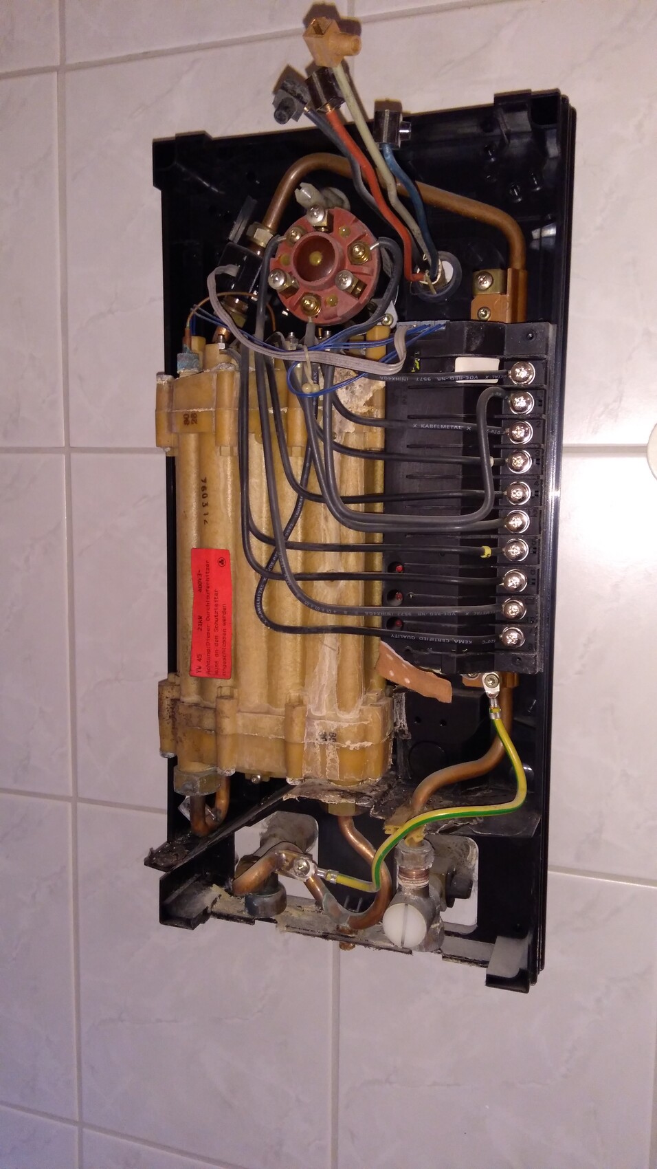

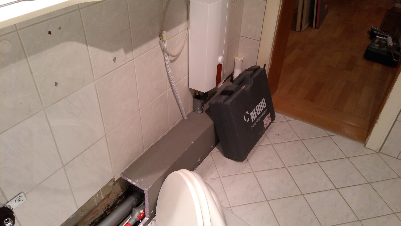

Why a new tankless water heater? Because the position above the bathtub was not good for it.
(You’d be surprised what a wound dressing can help with.)

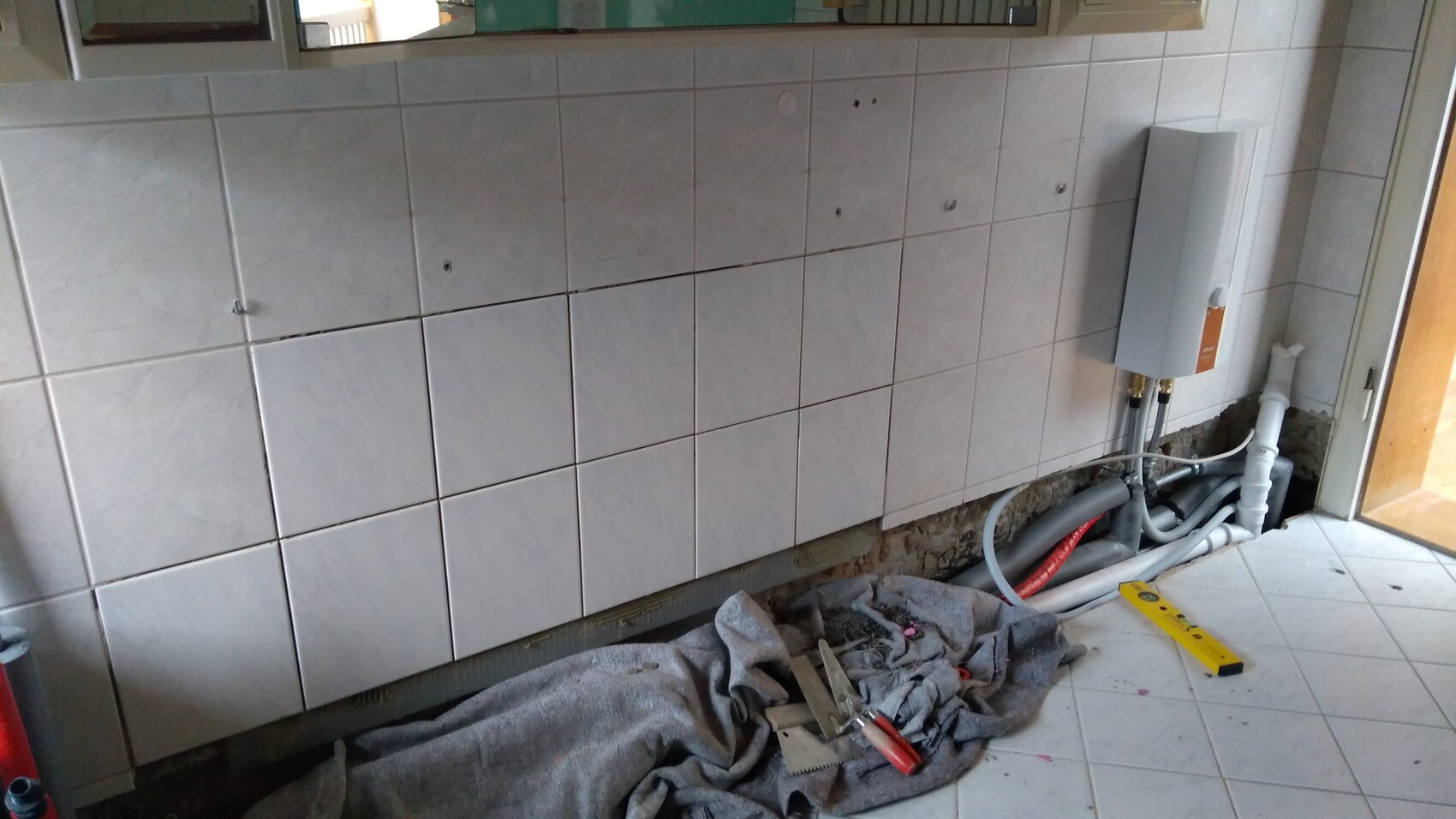

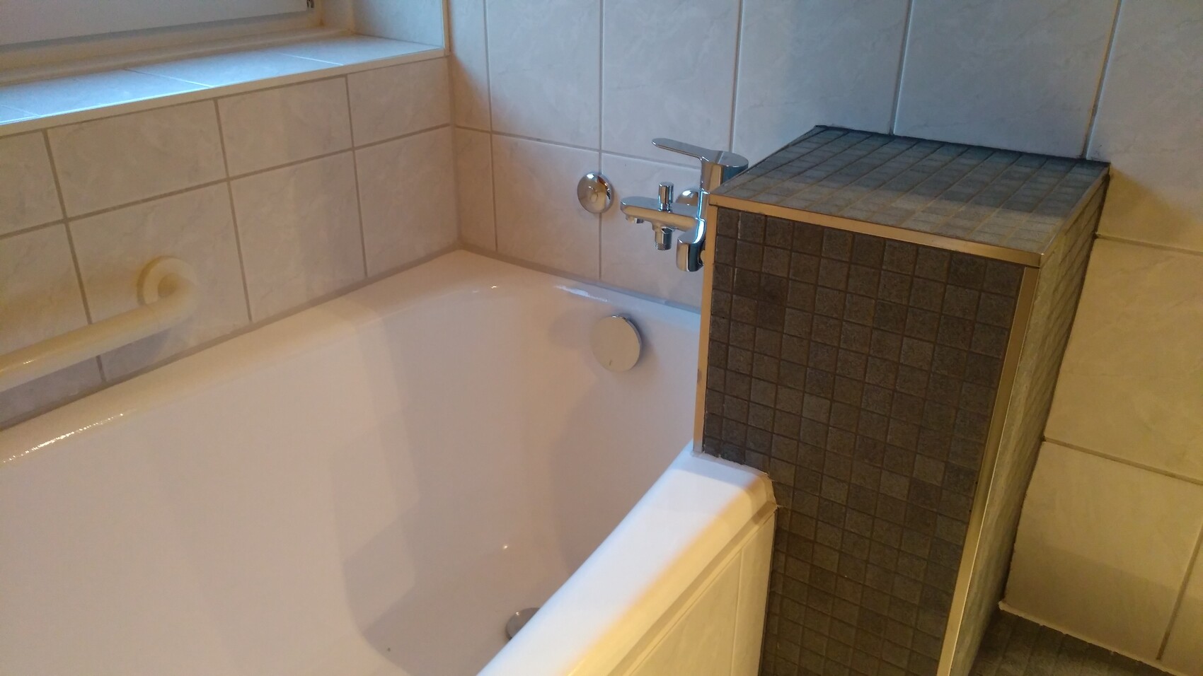

Now new tiles with a color accent to complement the old ones:
(04/14/2019)

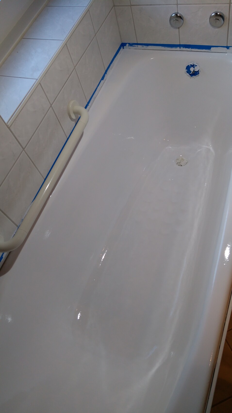

And refreshing the bathtub with new paint:
(04/17/2019)
Silicone joints, fixtures...
Then reinstalling the washbasin, and the move is ready to go—just in time on 04/23/2019.
