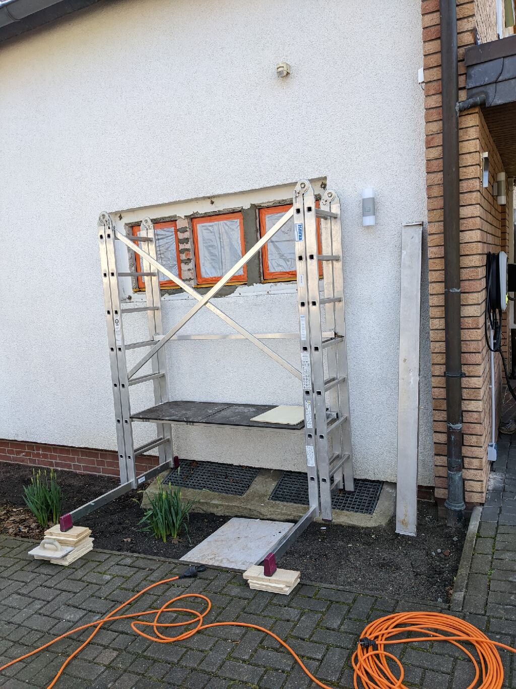

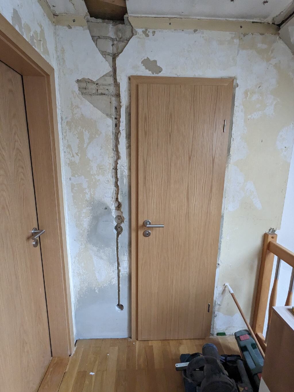

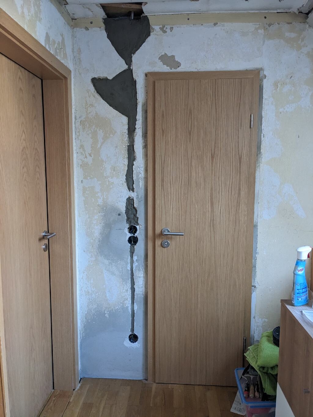

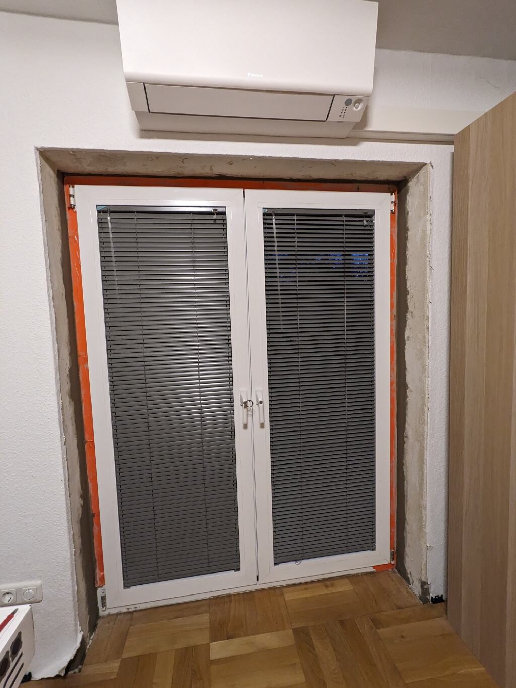

The balcony door was sealed with silicone only on the inside. Outside, there was just the old metal frame over the gap between the frame and the masonry. But nothing in between. Not even expanding foam. That’s why some mold is forming at the thermal bridge.
Everything was exposed and sealed with special foam. Then it was replastered.

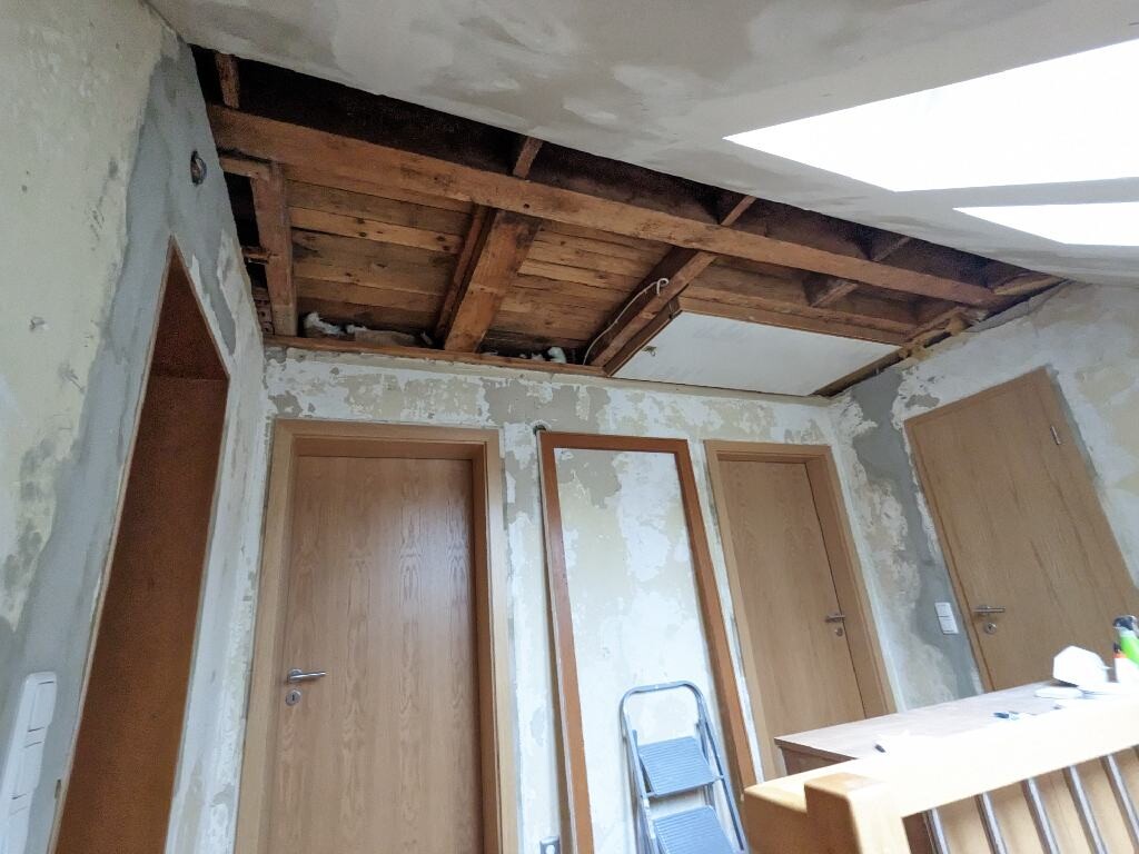

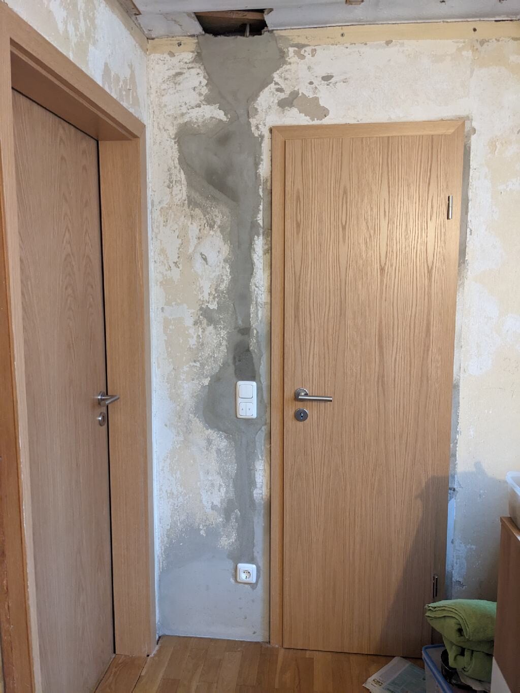

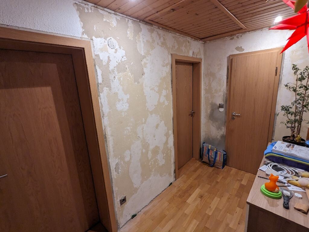

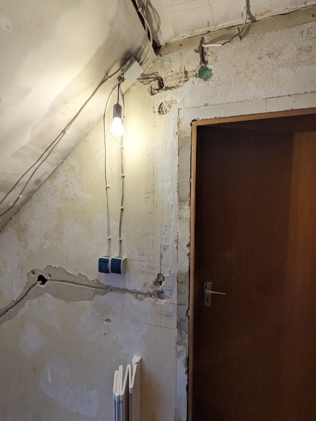

In the upper floor hallway, wallpaper and ceiling cladding were removed so everything can be redone.

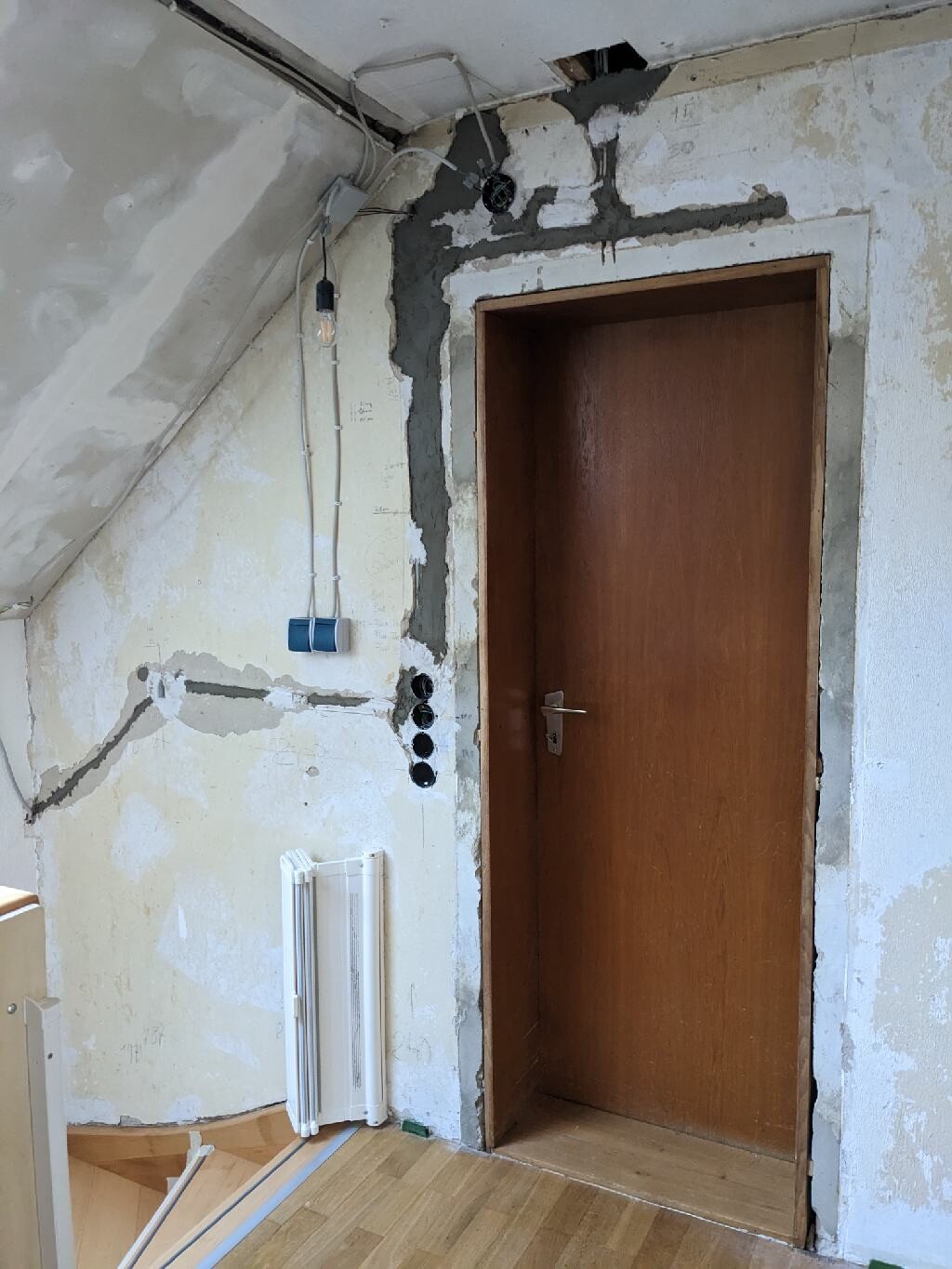

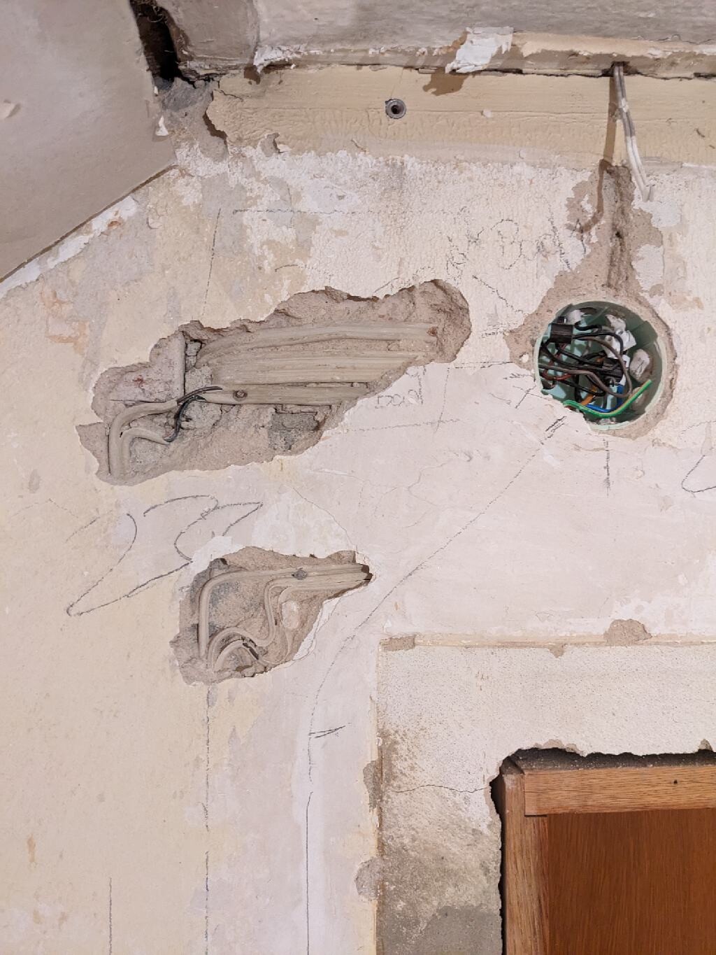

Then some investigation into the electrical system, since that will also be replaced.

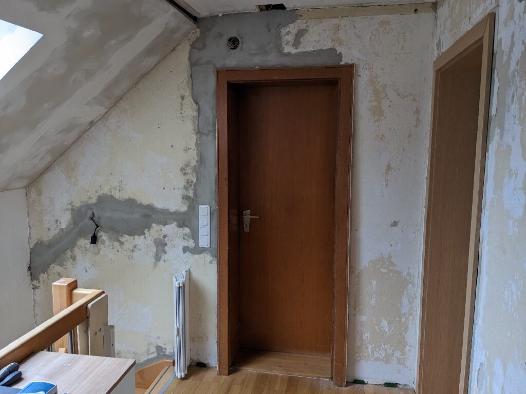

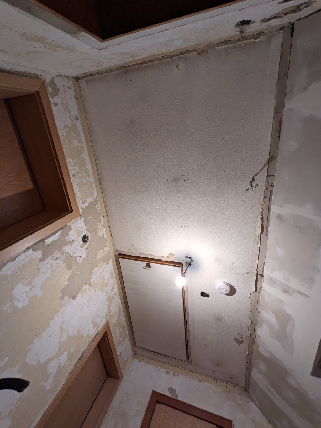

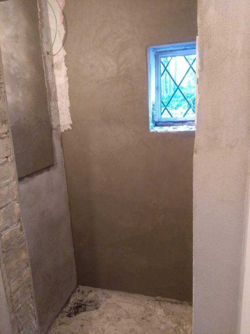

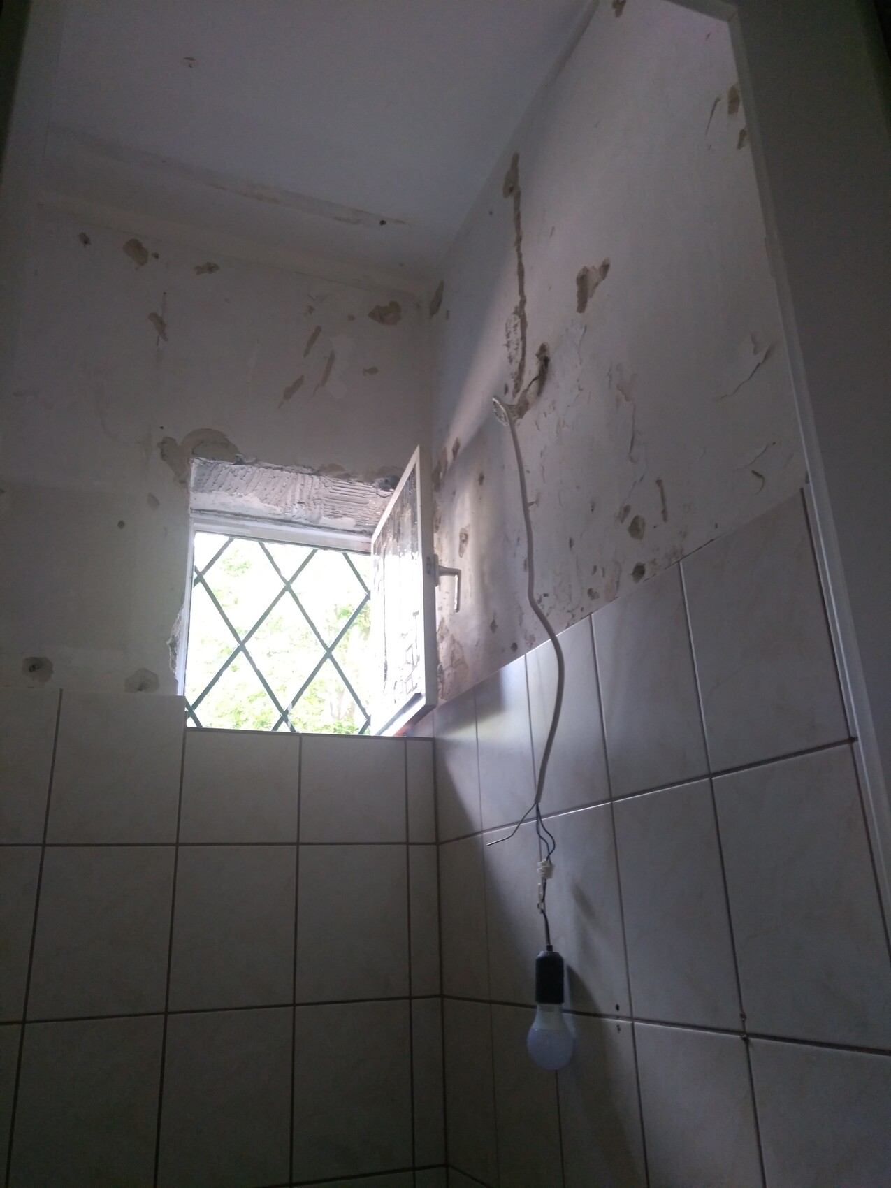

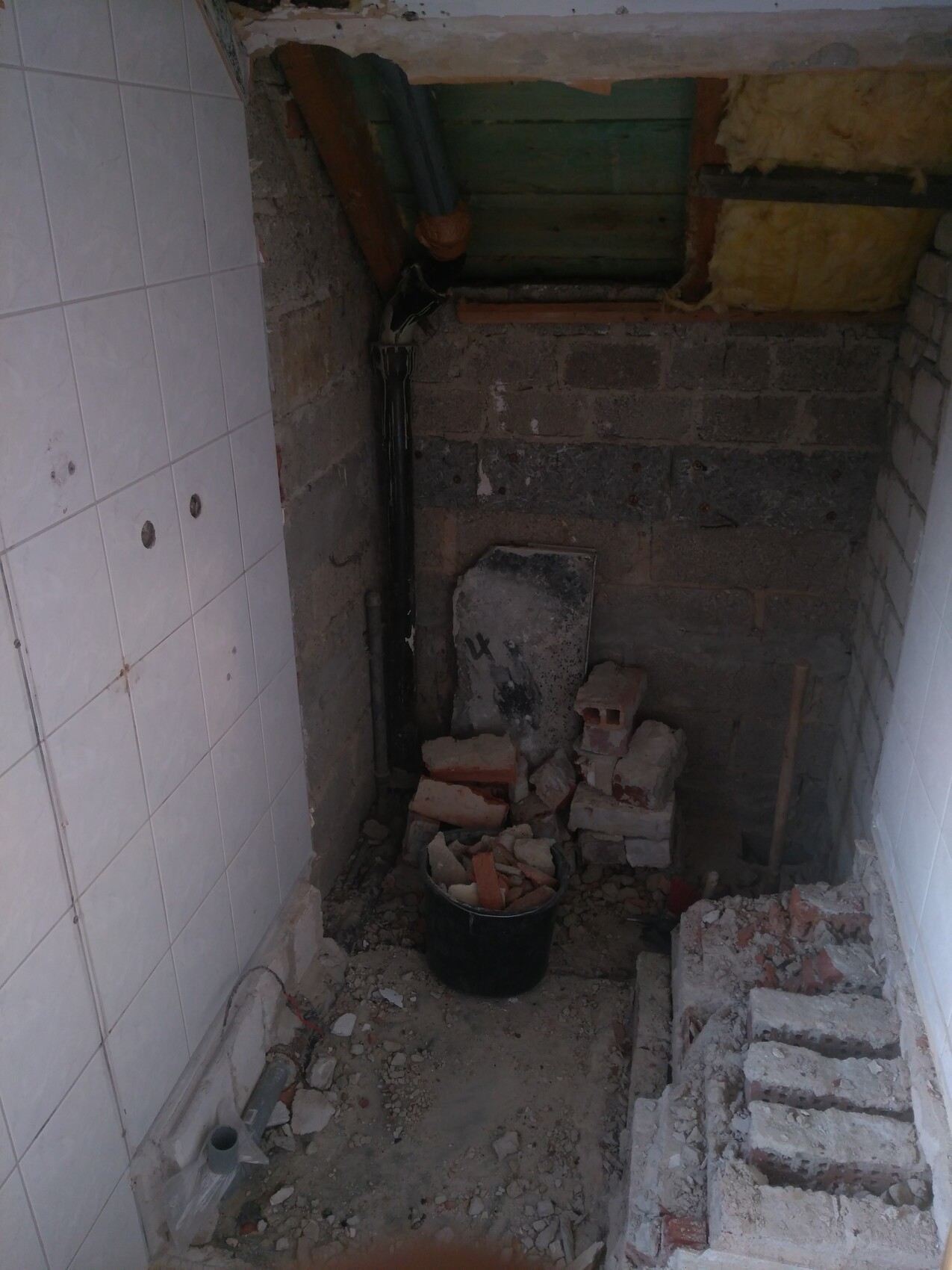

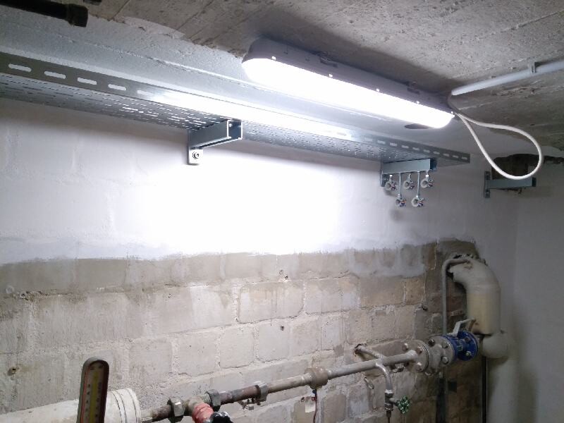

Small update.
It has now been plastered, rewired, and all temporary installations removed.
The old drywall ceiling, including insulation, has been removed.
New insulation has been installed.
PS: This will be my last post for now. Due to the new "technical notice," writing here has become difficult, and adding pictures no longer works.
You’ll have to guess which image belongs to which text.
