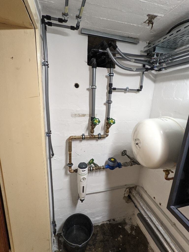

The last radiators have now been installed and all missing pipes laid. Over the weekend, the connection to the water network and the filling of all radiators and the hot water tank took place.
Now, only the startup of the district heating station by the local utility company is pending.

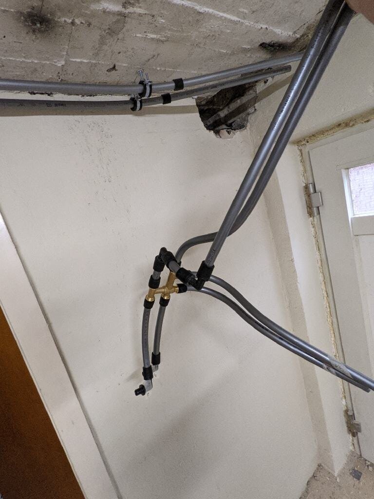

Prepare pipe junction for the ceiling penetration:

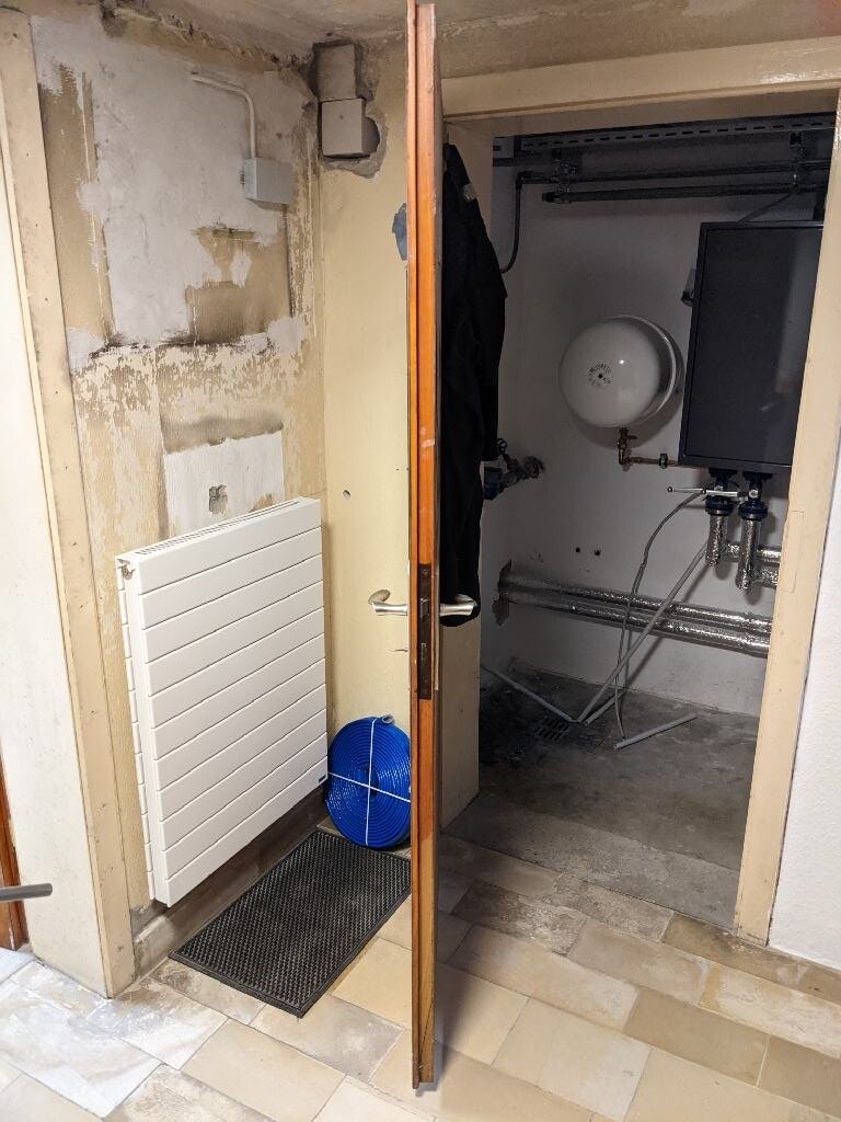

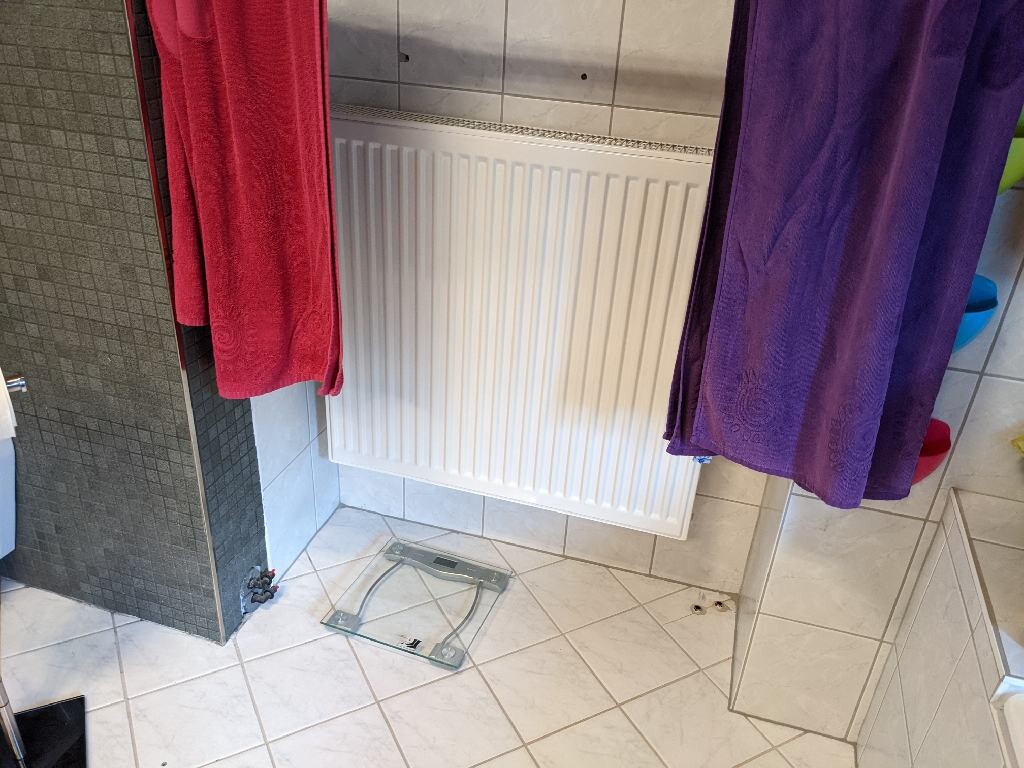

Temporary radiator in the bathroom:

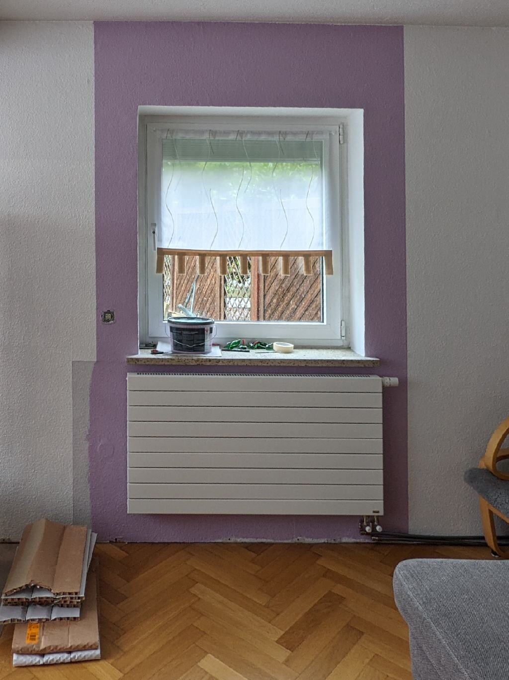

The last one to be installed in the living room:

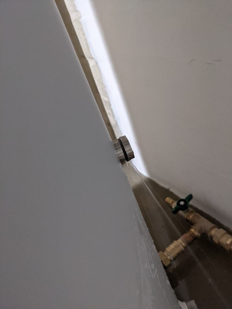

Organized water connection:
Once all of this is complete, the finishing work begins: insulating the pipes, sealing the ceiling penetrations, installing baseboards, removing the instantaneous water heater, and integrating the bathroom into the new hot water system.

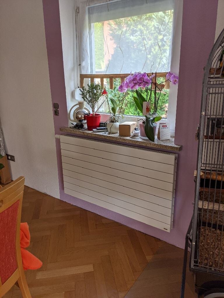

Radiator in the basement hallway:
